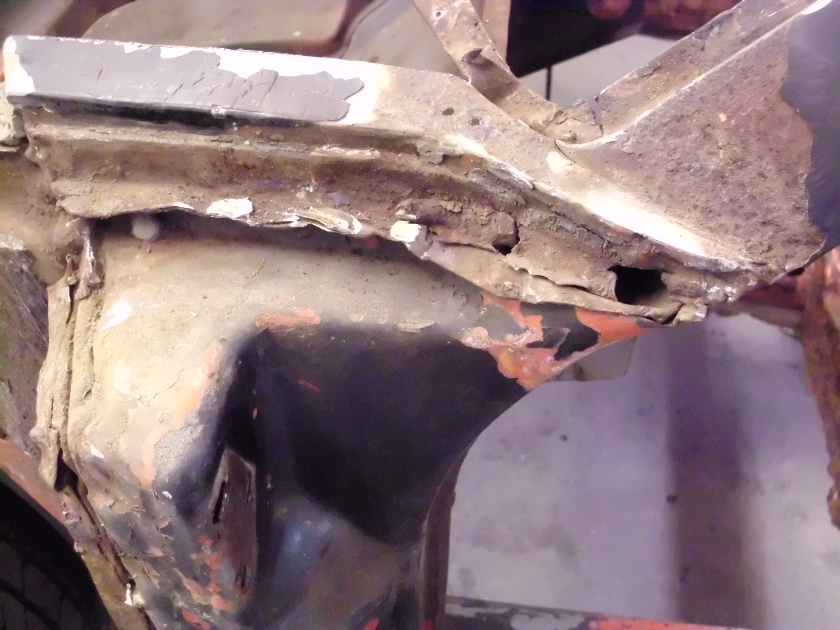

914350   Spent today trimming the panels off of the car and...   Oct 25 2014, 07:35 PM
914350   The inner Roll Bar structure is in great condition...   Oct 25 2014, 07:38 PM
914350   More pics.   Oct 25 2014, 07:44 PM

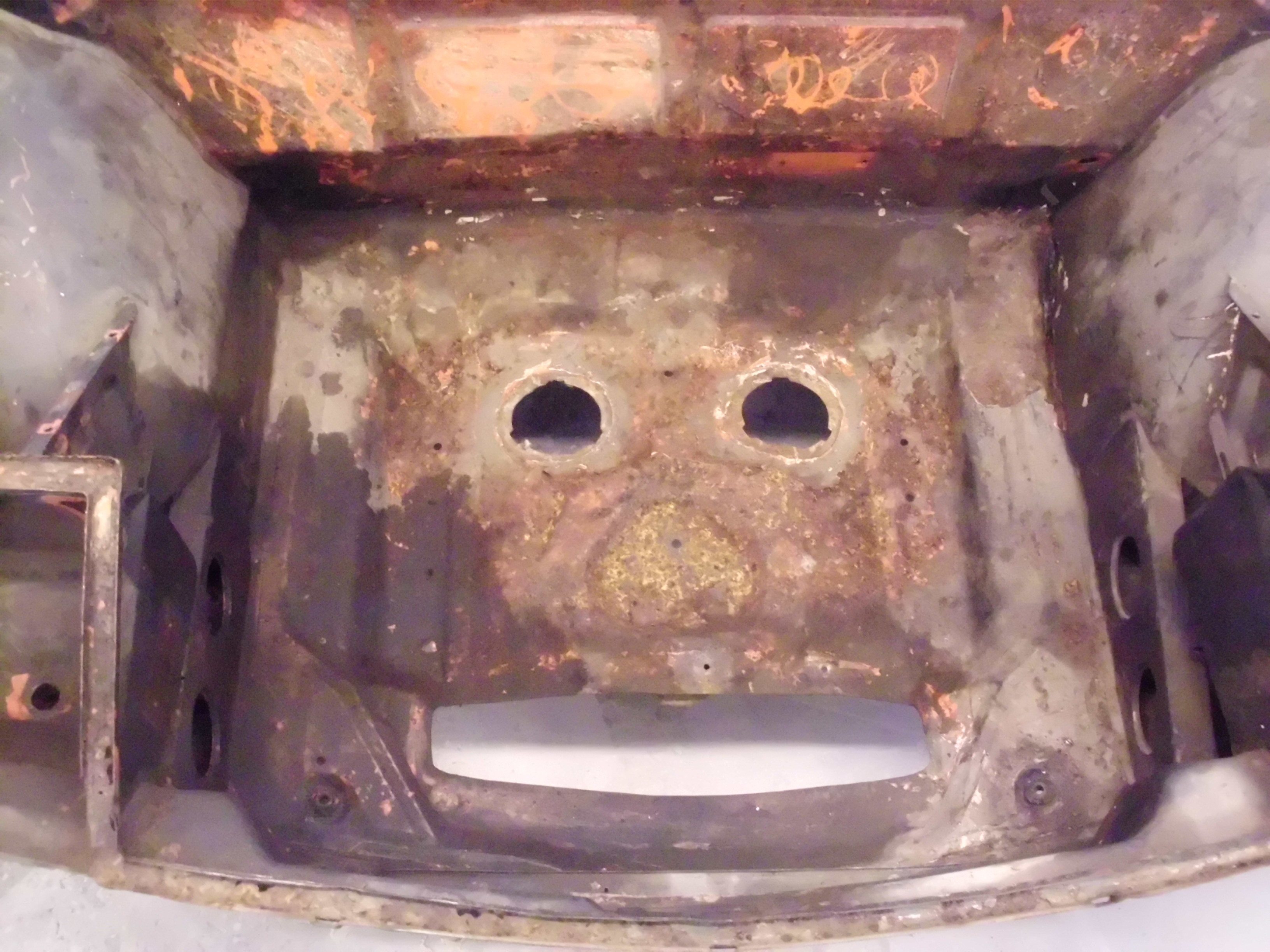

914350   The car is headed to Media blasting this Friday, s...   Oct 29 2014, 08:14 PM
914350   More pics of the car.   Oct 29 2014, 08:20 PM
914350   More pics.   Oct 29 2014, 08:27 PM
