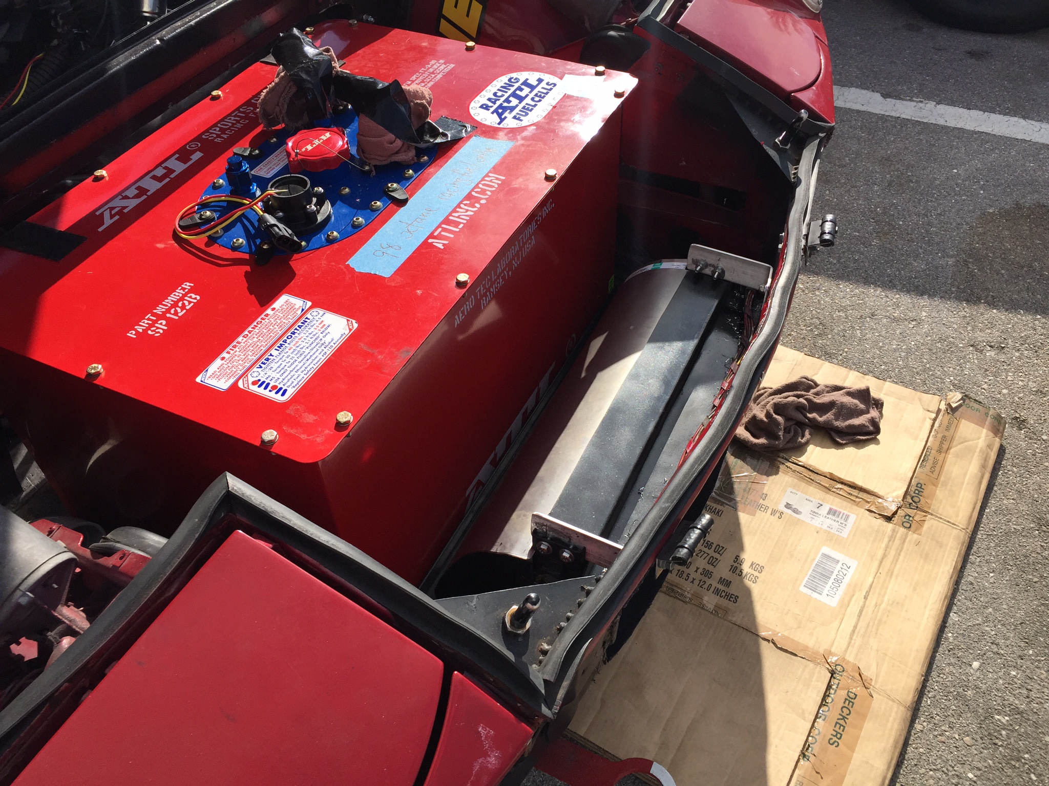

Jetsetsurfshop   question 2) I also have some oil on the top of t...   Aug 4 2014, 06:11 PM

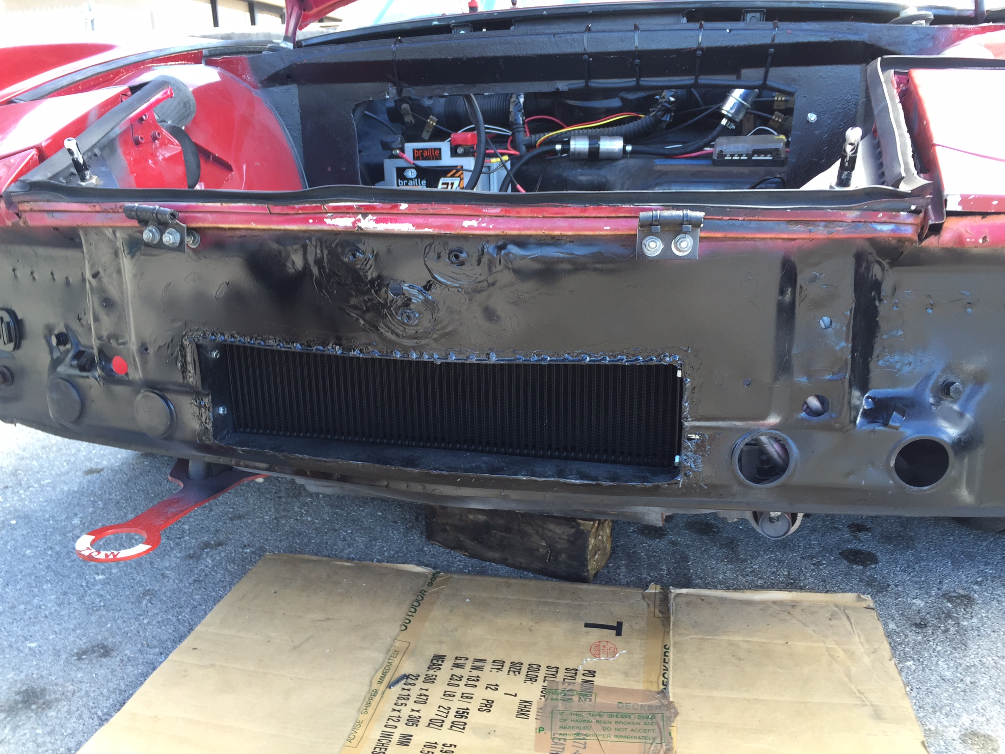

Jetsetsurfshop   Oil cooler update. (so far) Working on the plumbin...   Oct 30 2014, 07:02 PM
carr914   I did the Heater Channels - worked out pretty goo...   Oct 30 2014, 08:37 PM
Racer Chris   I used a hole saw to create an opening at the insi...   Oct 31 2014, 07:37 AM
Jetsetsurfshop   I got both lines to work. Thanks guys.   Nov 2 2014, 06:04 PM
ThePaintedMan   Is there any downside to running them as Shane has...   Nov 2 2014, 09:05 PM
Racer Chris   I think it works ok that way but there is a better...   Nov 3 2014, 03:45 PM
ThePaintedMan   Enough for water lines too? :idea: :D   Nov 3 2014, 03:50 PM
Racer Chris   Enough for water lines too? :idea: :D Two dash...   Nov 3 2014, 04:11 PM
Jetsetsurfshop   2 -12 are tight. It would be hard to get the next ...   Nov 3 2014, 06:31 PM
