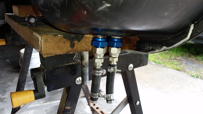

Had I little trouble at hose shop. They don't really deal in the small stuff. But we finally found what I was looking for.
With my bunged up threads they were tough to get started and not go on cross
threaded. But you can see them sitting here with 2 gallons of gas checking for leaks.
Dry as a bone. But I am going to mark the bottom of the tank .... never remove bad threads
I tested one of them on one of my other tanks. They went on smooth as silk. Nice product.
Note : They seal with an O-ring.
I'd say for cleaning the threads if the tank sealer is your only issue. Clean threads with the nut with the cuts in it. Oil as you go thru the cuts. I turn a 1/4, back up a 1/2. Rinse and repeat until you get to the bottom. I took it off once and cleaned the threads with a wire brush. Then use a new unused nut to tidy up the starter threads.

Looks like a job well done - thanks for documenting this repair so well - cheers!
