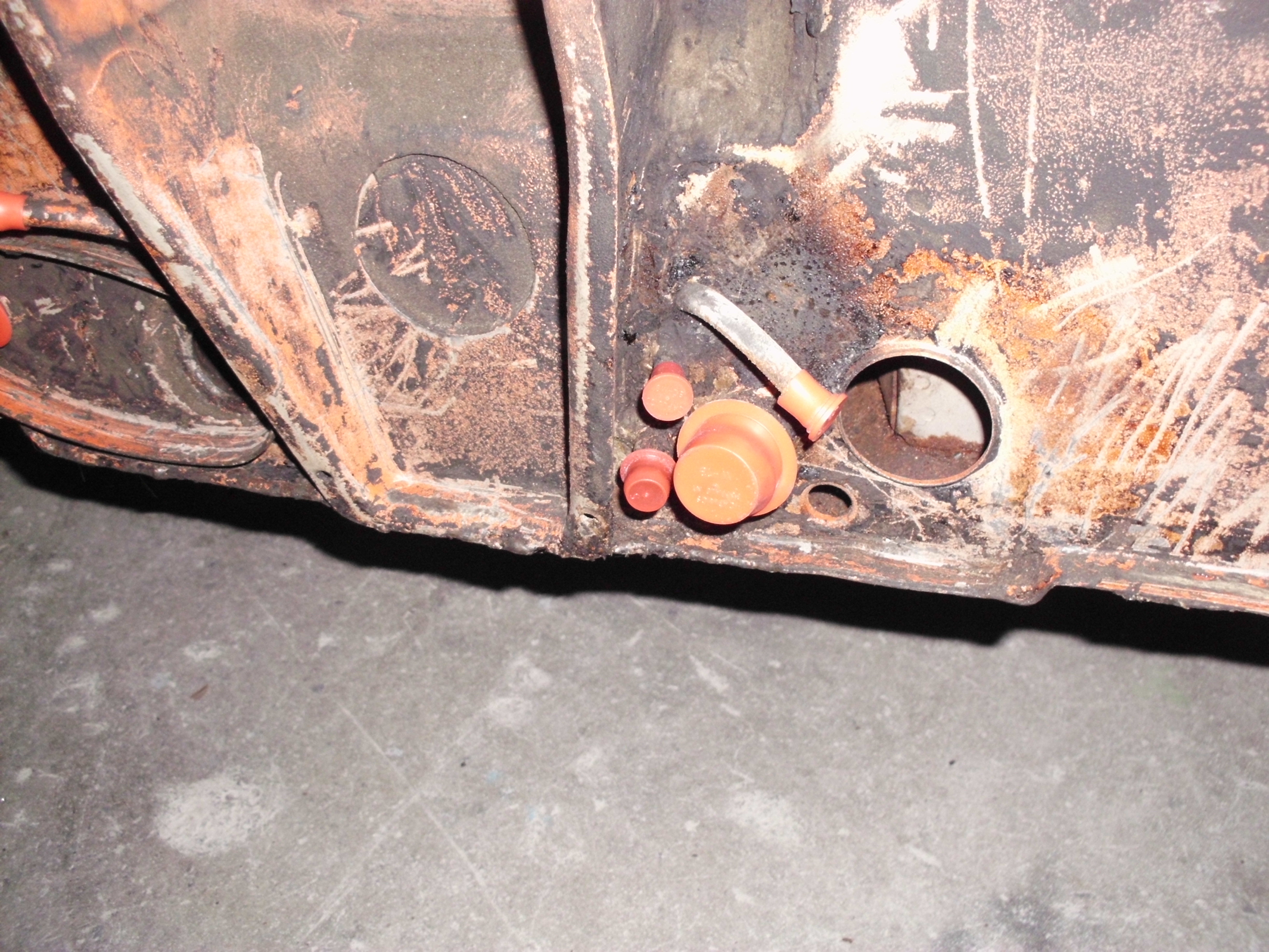

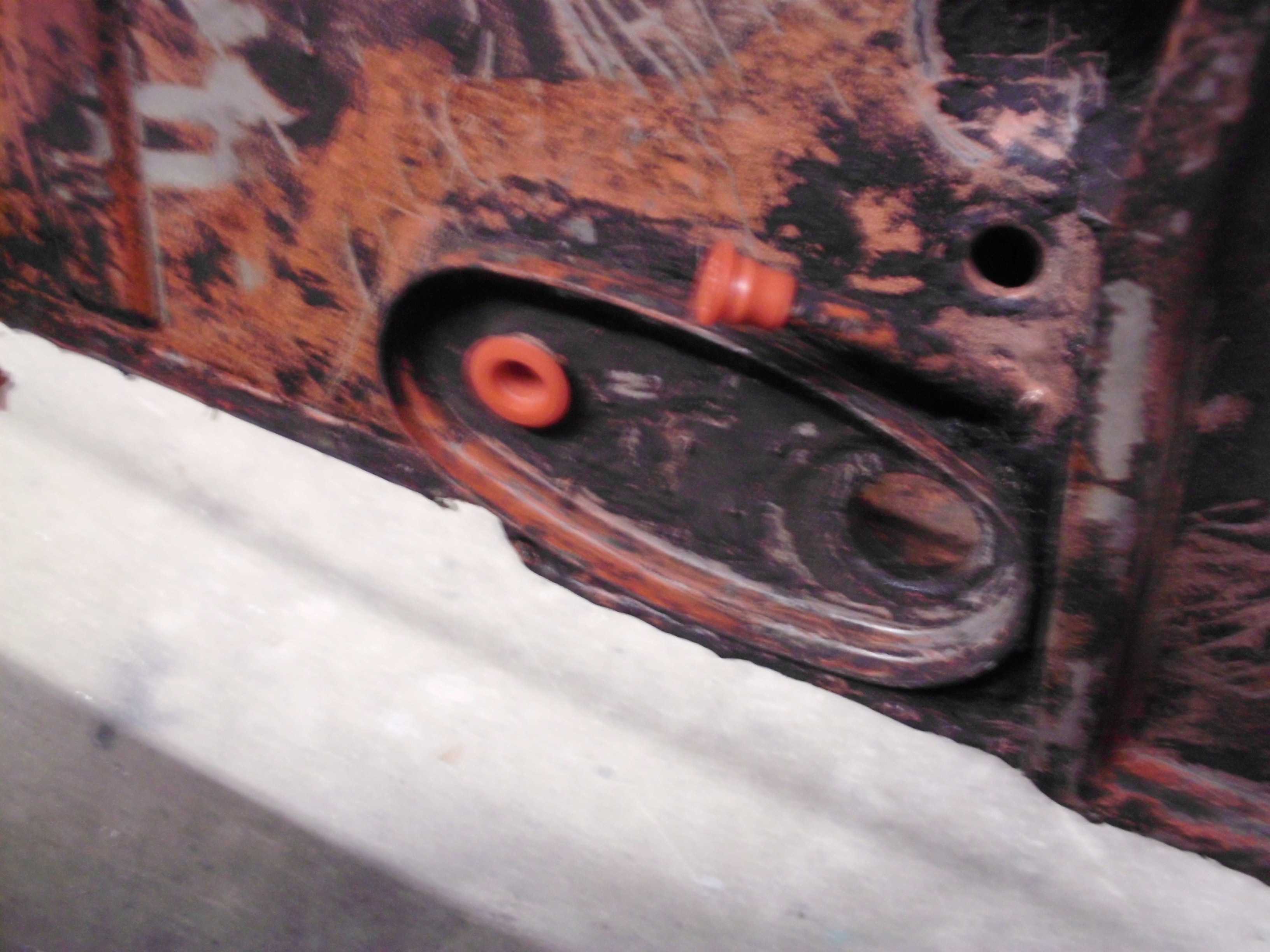

Headed to media blasting. Used Cap lugs to keep media out of the tubes.
