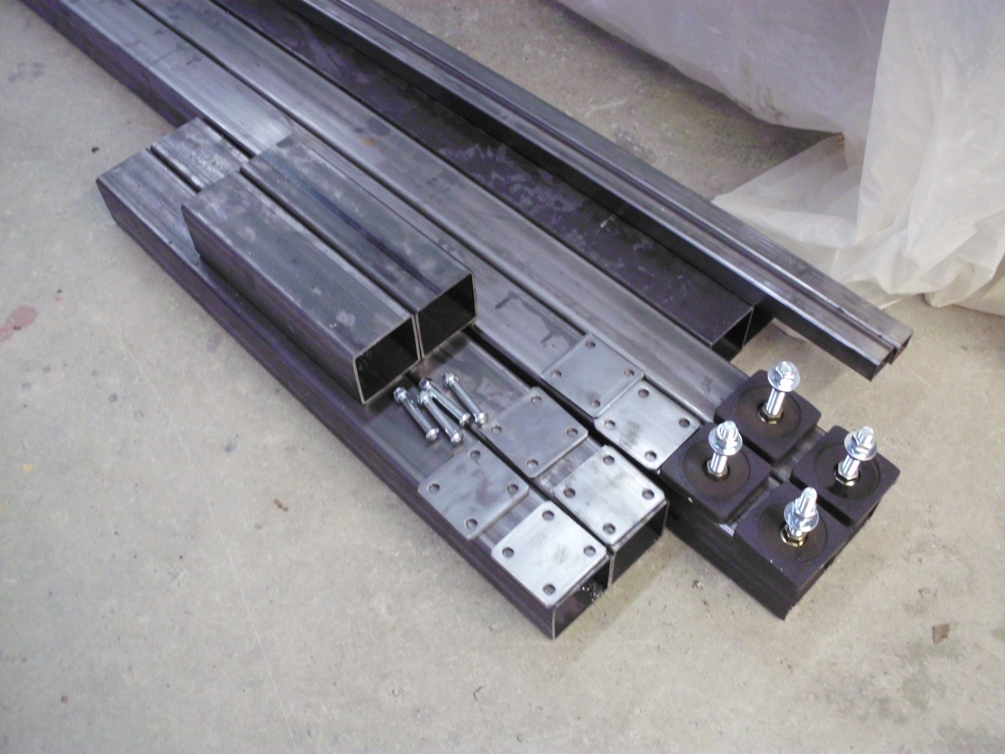

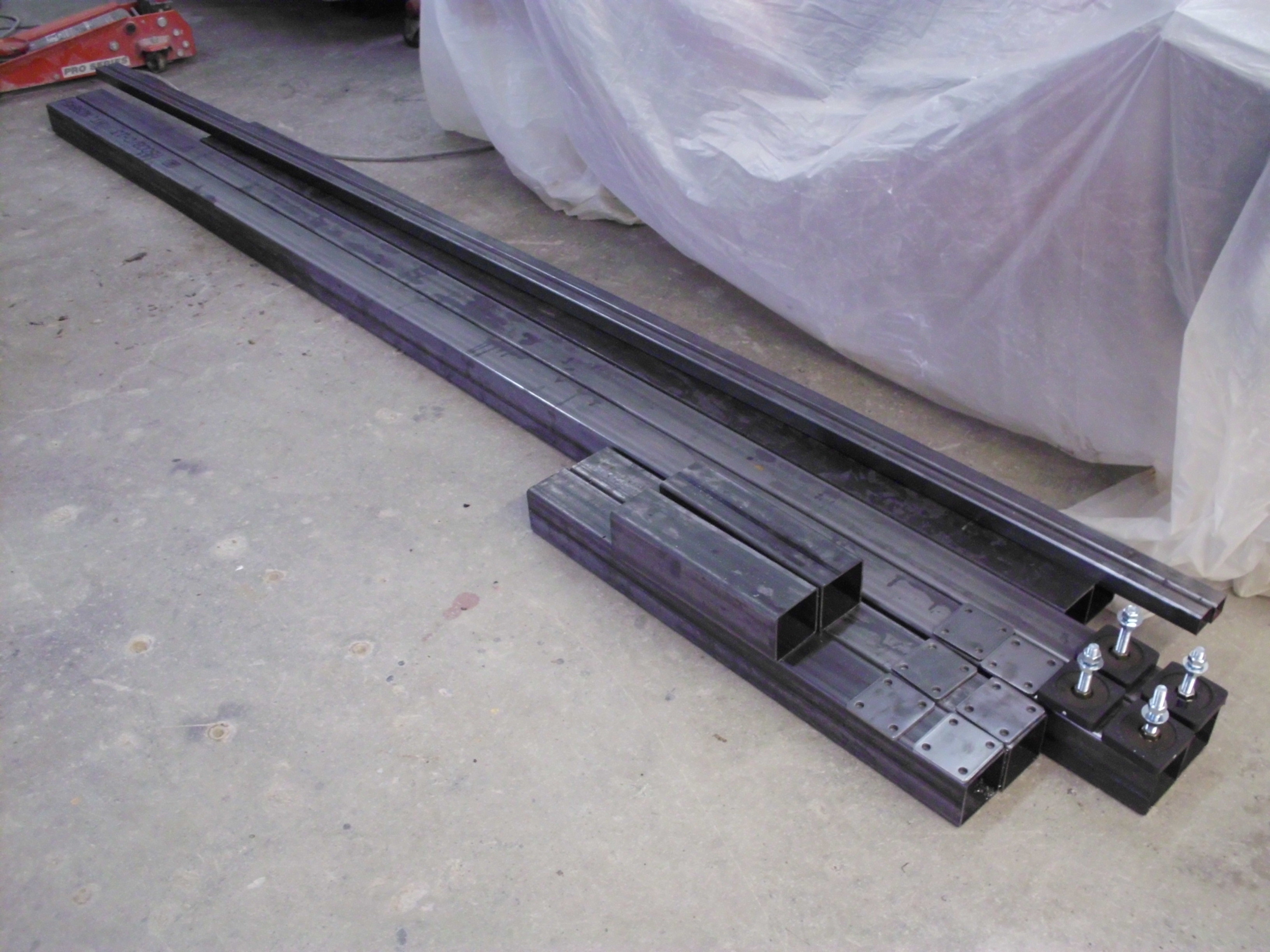

Picked up metal to build Frame Fixture.

914350   Picked up metal to build Frame Fixture.   Nov 1 2014, 12:26 AM
