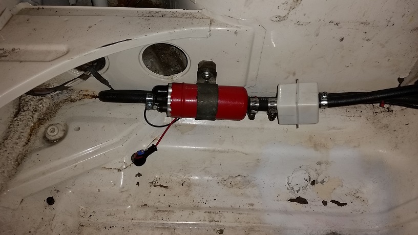

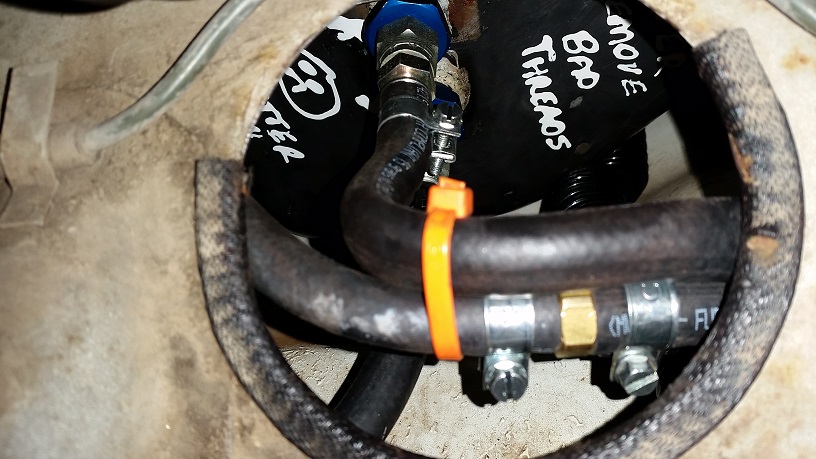

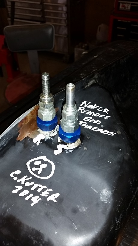

Final couple shots ............
Tank with my notes on it.
New look under the tank ..........
Zip tie is to take a slight kink out of the pressurized line
New fuel pump layout in the trunk

The fittings? Is that an AN-6 to AN-4 reducer and then a AN-4 reducer? Where did you get those?
