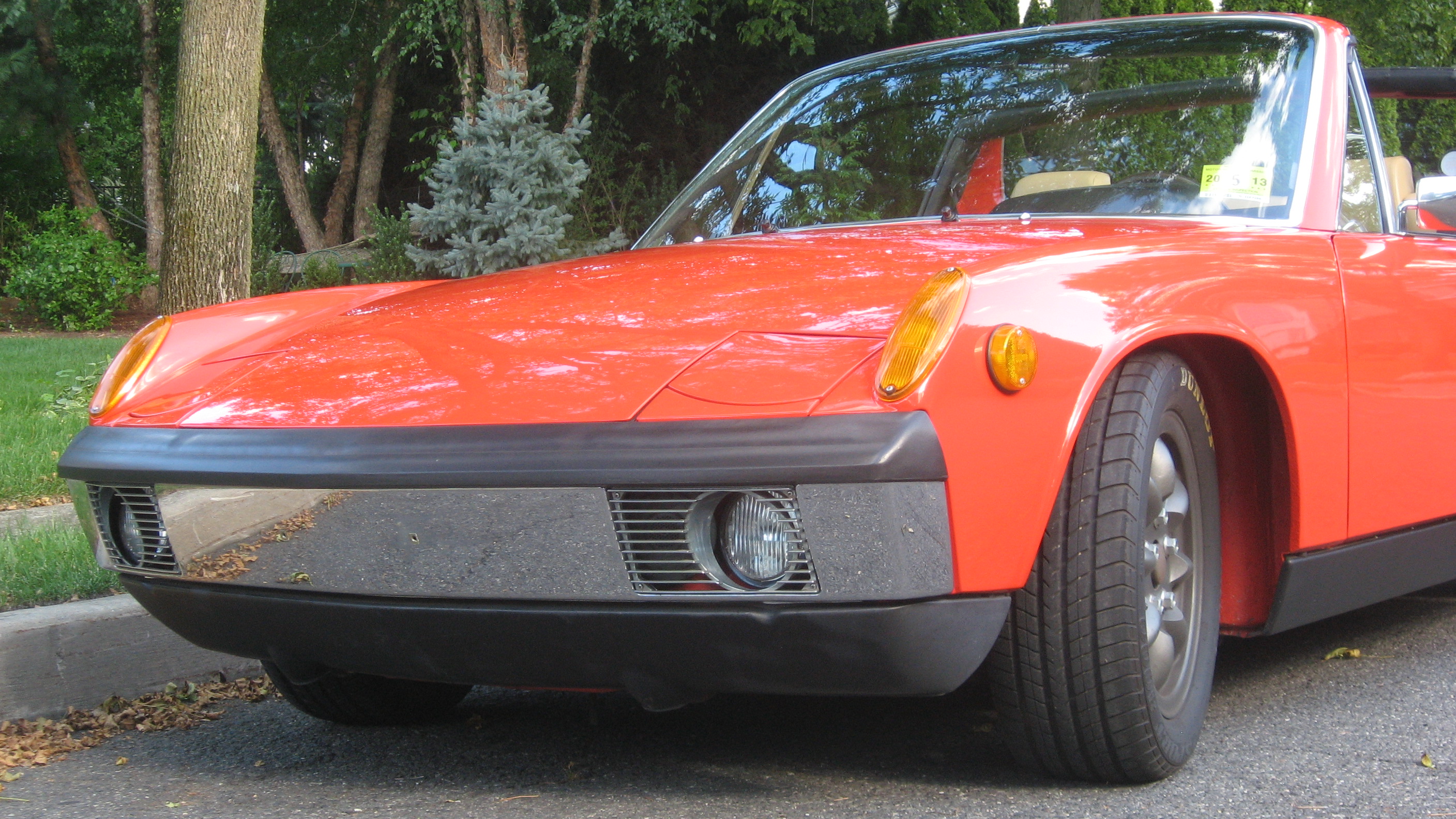

Topic title says it all. I have no flares,I'm going to install ATS classic wheels and I was wondering what size tires will fit. I want to go with 195/60-15's. What tires are you guys using? Thanks in advance for any input. Best I can tell the offset of the ATS classics is the same as the stock wheels I'm taking off so any input is appreciated. 205 / 55 R 15, no rubbing, fills the wheel well, not too short. Not too expensive. Look at current Dunlop Direzza Attached thumbnail(s) |
