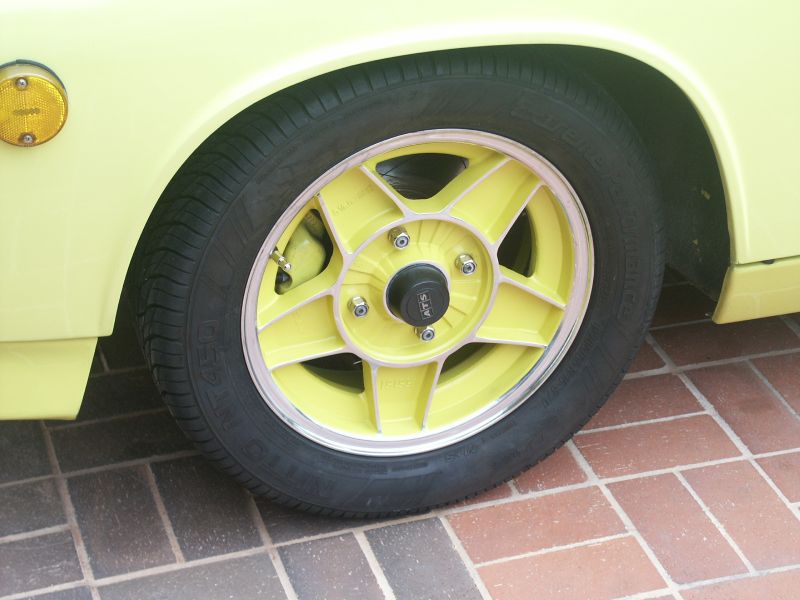

Topic title says it all. I have no flares,I'm going to install ATS classic wheels and I was wondering what size tires will fit. I want to go with 195/60-15's. What tires are you guys using? Thanks in advance for any input. Best I can tell the offset of the ATS classics is the same as the stock wheels I'm taking off so any input is appreciated.

195/65-15 would actually be the closest to the original fitment tire diameter if that matters to you.

I purchased new tires today for the new 73 I just bought. I did some research on this with Discount Tire and Tire Rack.
Went with 195/65/15 Yokohama AVID Ascend (T-Speed Rated) Standard Touring All-Season. Yokohama has a rebate cash card with dropped it down $60.00. Under $400.00 fully installed with lifetime balance.

Aren't ATS Classics 15x7 wheels? If so, wouldn't the wheel be pushed out further in the wheel well if it is the same backspace as 15x5.5 "stock" wheels?

I wish they were 15X7, they're 15X5.5

+1 on the 195 65 15. Good all around for a narrow driver. More meat on the road than stock tires.

205/65s fit on stock Fuchs 2.0 wheels and fill the wheel wells nicely IMHO.
They will rub a bit on real hard turning (mostly parking) on the inside fronts. I bought the Yokohama Avids too. Great grip.

I used to have 185-65-15 on mine during my first ownership, and they fit well. Bought the car back a few years ago with 215-60-15 on the rear, and 195-55-15 on the front blink.gif blink.gif blink.gif

I had a set of ATS 15 x 5.5 on my 76 914 for several years. I had 185/70 Pirelli tires. Good looking wheel, but with offset probably more suitable for a Beetle. The rear is the limiting factor as there was almost no clearance on the outside to the fender, which was not stretched or rolled. I am not sure if a 195 tire would have fit my car.

205 / 55 R 15, no rubbing, fills the wheel well, not too short.

! run 205x15 with my ATS wheels
