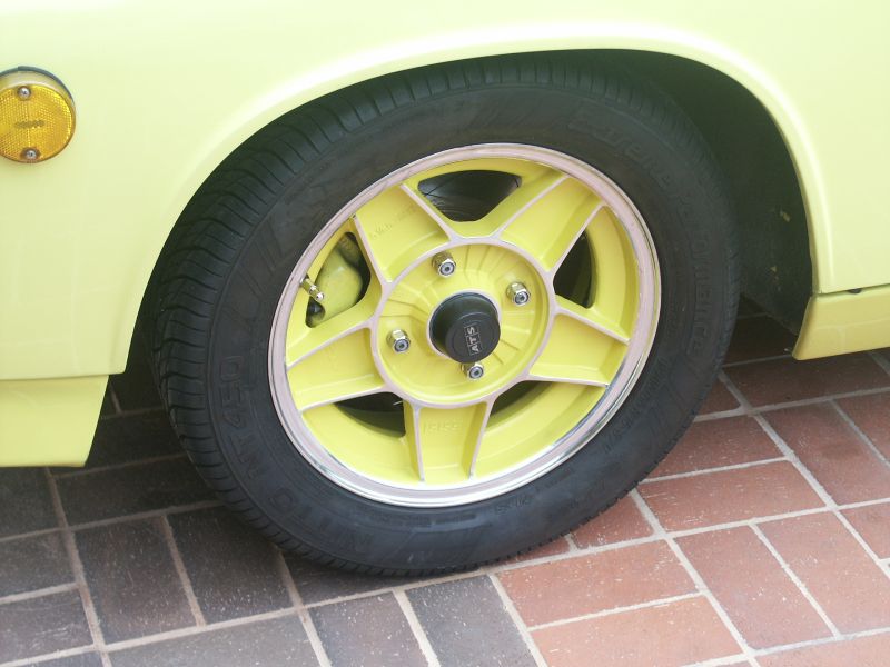

I had a set of ATS 15 x 5.5 on my 76 914 for several years. I had 185/70 Pirelli tires. Good looking wheel, but with offset probably more suitable for a Beetle. The rear is the limiting factor as there was almost no clearance on the outside to the fender, which was not stretched or rolled. I am not sure if a 195 tire would have fit my car.

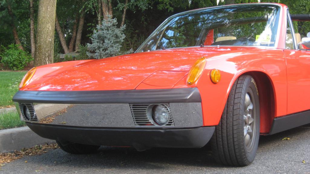

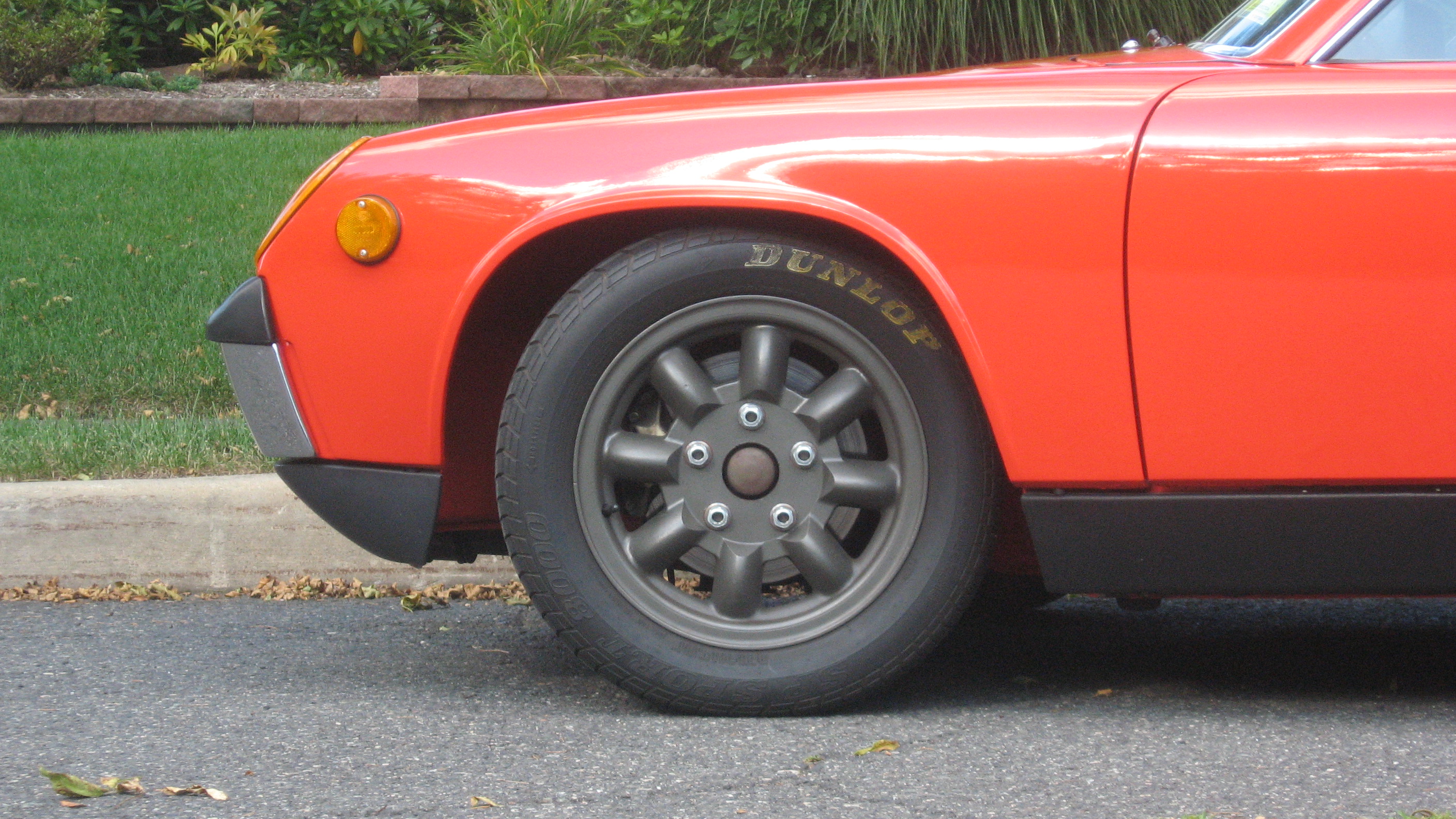

QUOTE(914bub @ Nov 1 2014, 12:09 AM) *
Topic title says it all. I have no flares,I'm going to install ATS classic wheels and I was wondering what size tires will fit. I want to go with 195/60-15's. What tires are you guys using? Thanks in advance for any input. Best I can tell the offset of the ATS classics is the same as the stock wheels I'm taking off so any input is appreciated.
205 / 55 R 15, no rubbing, fills the wheel well, not too short.
Not too expensive. Look at current Dunlop Direzza
