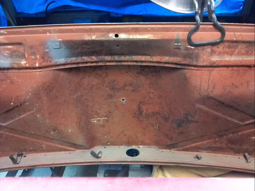

I am welding in the inner suspension ear and I am trying to figure out what dimensions have to be exact and which can be accommodated in the regular suspension adjustment. I will of course try to get it perfect but I am looking for any gotchas that I have not thought about yet.

3 holes to choose from

QUOTE(Jeff Hail @ Oct 31 2014, 11:46 PM) *
I didn't have any type of jig for the inner suspension console either. Using the third hole down in Jeffs picture, I cut a piece of steel brake line to 28 1/4" to get the fore-aft alignment.

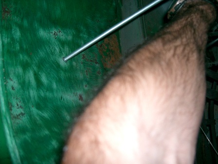

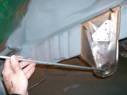

cary   MacGyver ( Super In Law, Grandpa Jack) built me a ...   Nov 2 2014, 09:19 AM
cary   Here's the measuring device.   Nov 2 2014, 09:01 PM
cary   Here's the measurement of the factory spec (91...   Nov 2 2014, 09:05 PM
cary   Here's the rod thru the suspesion console. Ri...   Nov 2 2014, 09:22 PM
cary   Here's my data points. Factory shift rod to 1...   Nov 2 2014, 09:54 PM
