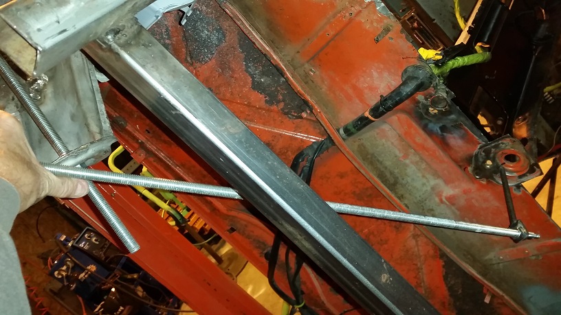

cary   MacGyver ( Super In Law, Grandpa Jack) built me a ...   Nov 2 2014, 09:19 AM
cary   Here's the measuring device.   Nov 2 2014, 09:01 PM

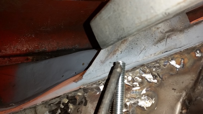

cary   Here's the measurement of the factory spec (91...   Nov 2 2014, 09:05 PM

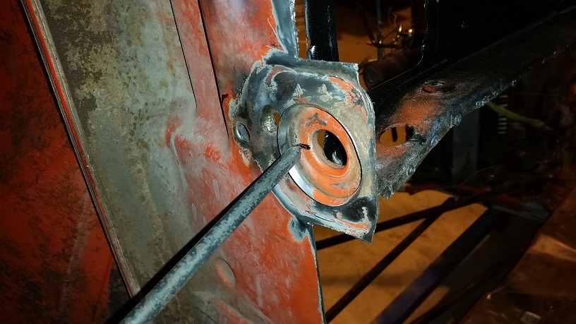

cary   Here's the rod thru the suspesion console. Ri...   Nov 2 2014, 09:22 PM
cary   Here's my data points. Factory shift rod to 1...   Nov 2 2014, 09:54 PM
