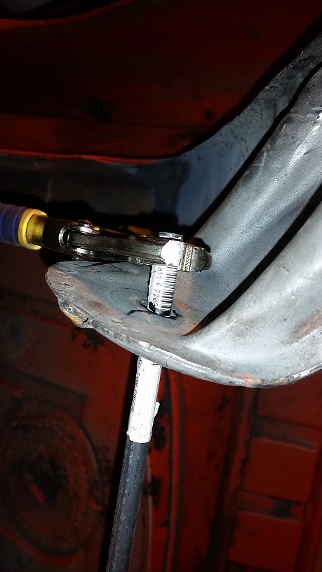

Here's the rod thru the suspesion console.
Right side.

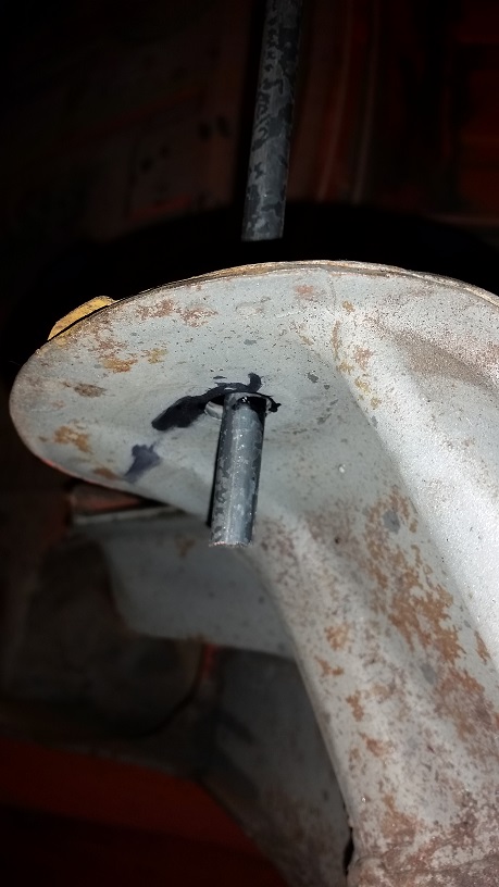

This shows the 3/16 to narrow at the top.

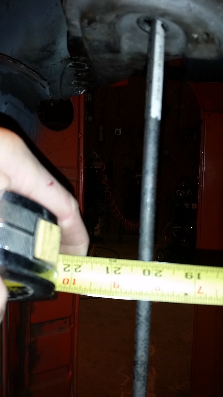

Then I measured the rod to the wall.
Both left and right (top and bottom)

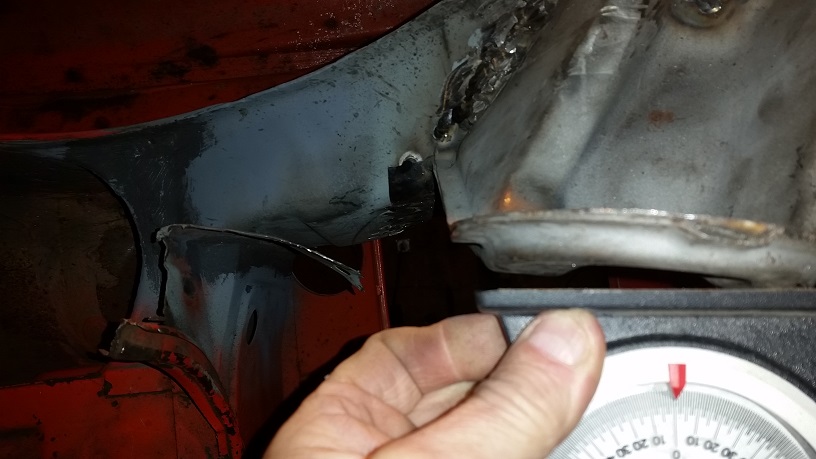

Then for shits and giggles I measured the angle of ear on both sides.
The gap shows the angle it should be to match the other side.

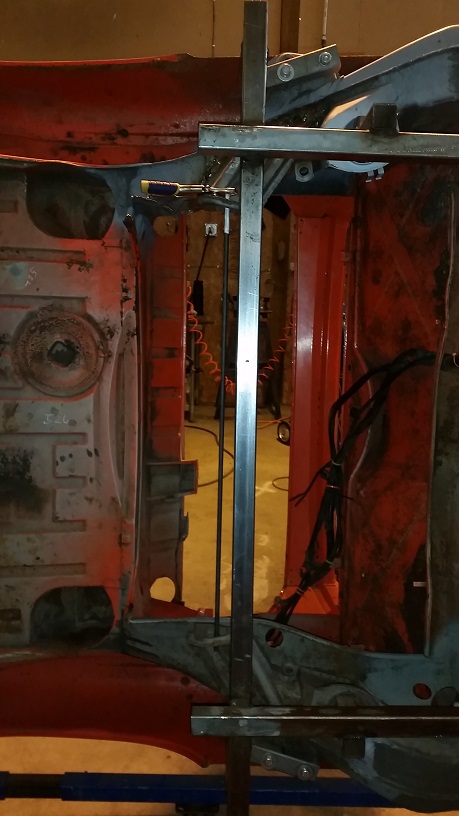

cary   MacGyver ( Super In Law, Grandpa Jack) built me a ...   Nov 2 2014, 09:19 AM
cary   Here's the measuring device.   Nov 2 2014, 09:01 PM
cary   Here's the measurement of the factory spec (91...   Nov 2 2014, 09:05 PM

cary   Here's my data points. Factory shift rod to 1...   Nov 2 2014, 09:54 PM
