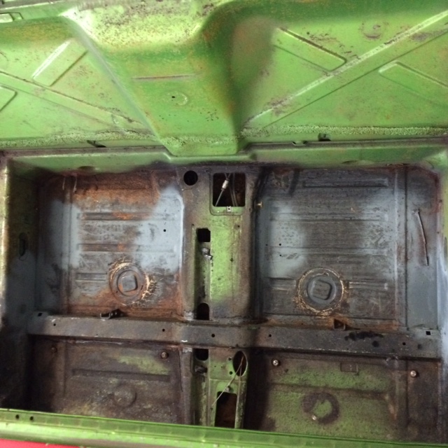

removed the floor covering - the tar like stuff - gave it a little heat and it peels off easily enough ..

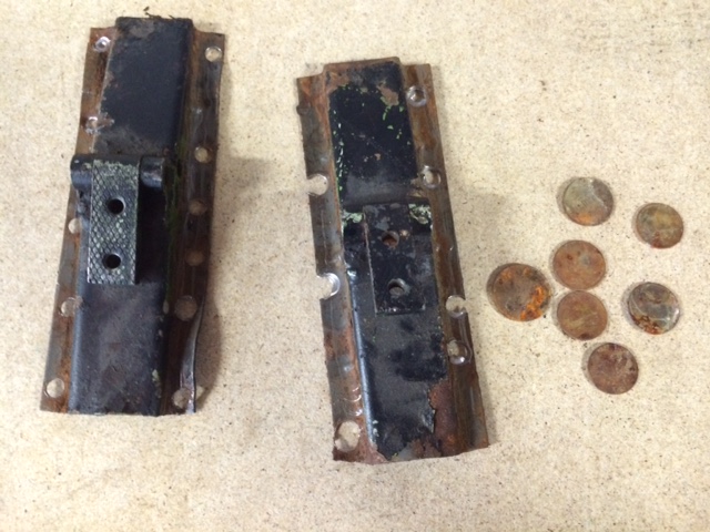

Cut off the handbrake mount points - there were two of them - one on each side as it was converted to right hand drive the left hand one was just left in place.
Removed both rear seat mounts as I have secured a pair of sparco rev plus seats.
When I pulled out the rear seat mounts I found a bunch of coins under them - quarters & dimes by the look of them ?? - fair well corroded tho ...
Removed a bunch of small brackets on the floor & cleaned it all up & gave a spray of weld thru primer.
next job is to remove the cross floor brace and cut the top off the tunnel to clean out the surface rust & give it a coat of epoxy.
