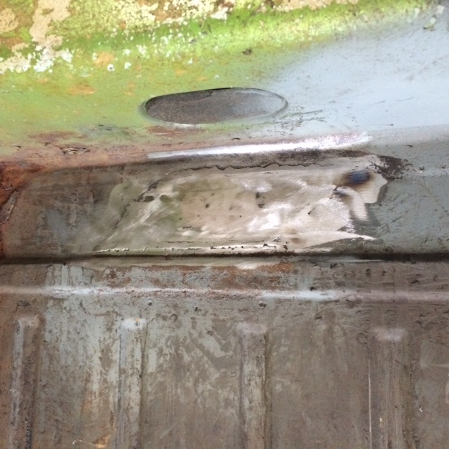

I've now cleaned all the tar like insulation off the floor pan - floor is in generally good condition all over, little surface rust here & there but nothing that cant just be cleaned up.
I had to cut out a couple of inches of the bottom of the firewall & couple of inches from the back of the floor pan, have been busily making templates & cutting / welding.
right hand side floor pan will be dropped a few inches to accommodate my height with a cage - i'm 6'2" with arms like some kind of simian ... need all the space i can get ! the cross brace will also be moved forwards about 6-8" to give some adjustability to the seat so the wife can drive it if she feels like it.
the seat in my lotus (Exige V6) is fixed position, she can only drive it with a number of pillows stuffed behind her so she sits on the edge of the seat ... not ideal !
There was a small hole in the left hand side floor where the RHD conversion people had cut the handbrake guide out. removed section & welded in a new piece.
Right hand side hell hole looks like its already been fixed before - need to investigate that area more when i get the battery box out - the battery box has been replaced at some point in the past - it needs to go - its WAY too big anyway, i'll be installing a much smaller battery when the time comes.
'hell hole' on the left hand side needs some work - chassis section looks good with only surface rust but inner wheel guard & some of the shelf in the engine bay needed to go. a question; what tool to use to cut out the inner guard - its a very restricted area to get an angle grinder in there ... ??
finished removing all the gunk from the windscreen & removed the rest of the air vents from the gas tank area. removed the shock absorbers from the fenders.
pedal box is removed & a fair number of small holes have been welded & cleaned up from the floor & pedal box area. seam sealed where i needed to.
