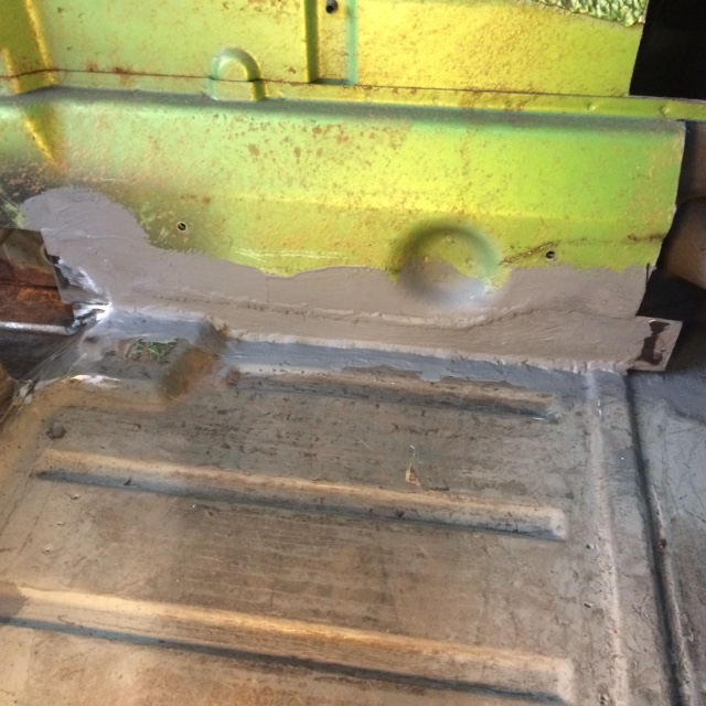

some of the firewall replaced ...
and picked up a bag of bicarb of soda in the daily driver to test out surface rust removal in hard to reach areas ...
