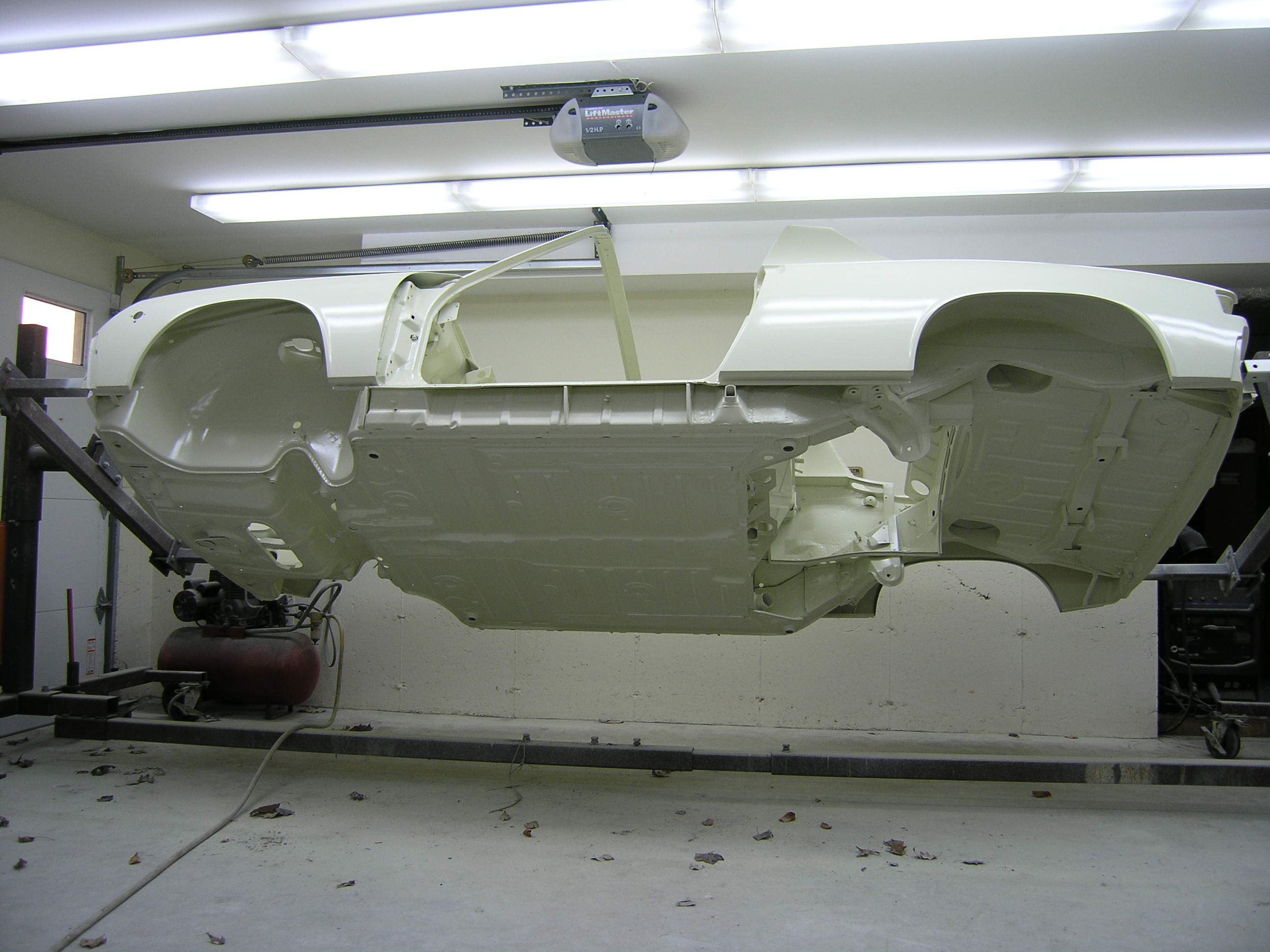

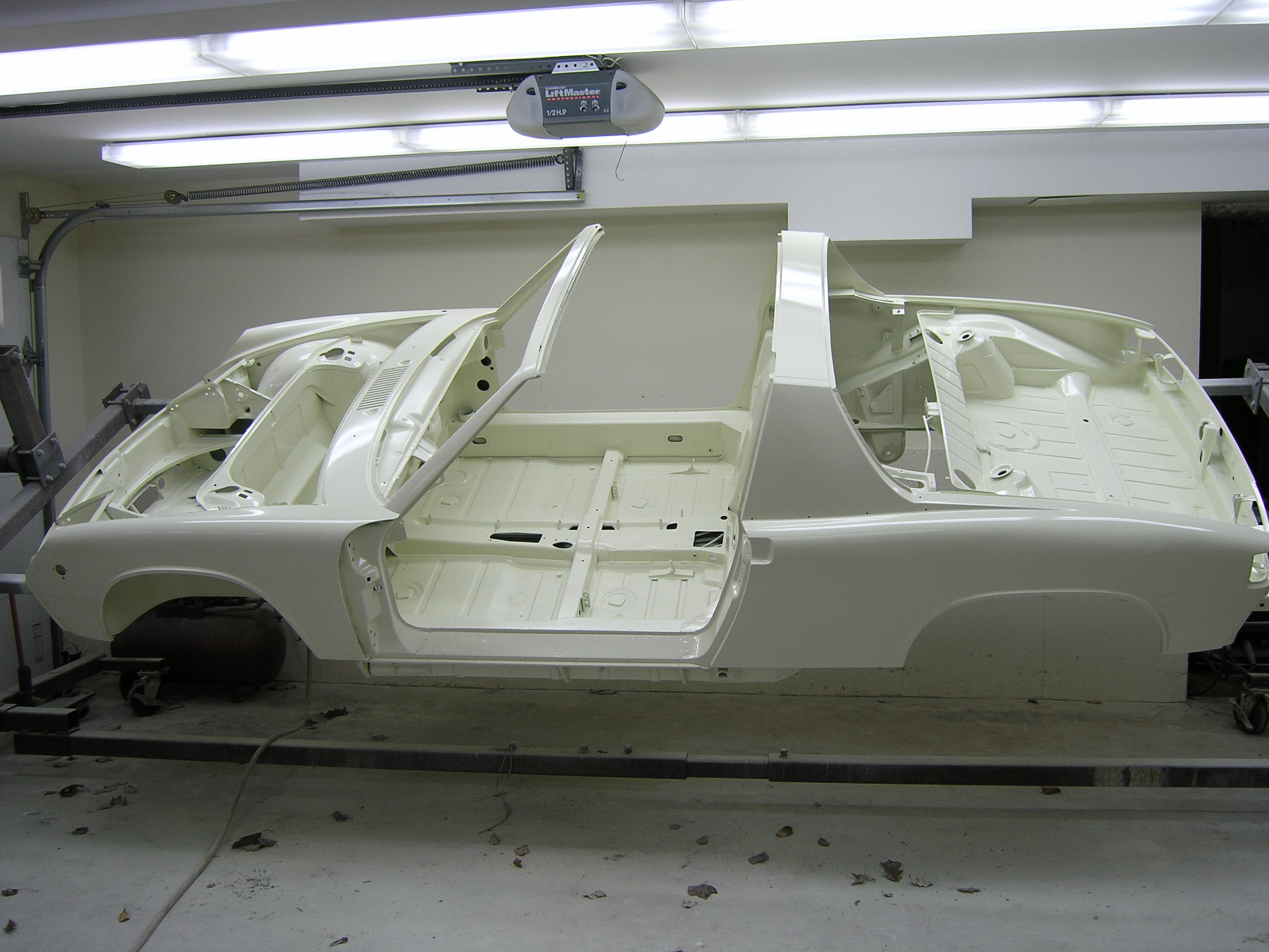

I just went through this. Aircraft stripper - let it sit for an hour - then hit it with a power washer. 4 gallons did the entire car (approx $40 per gallon) - inside and out. It IS A PAIN!Attached Image

roblav1   My old car is the white one in the rotisserie. I...   Sep 2 2017, 06:21 PM
