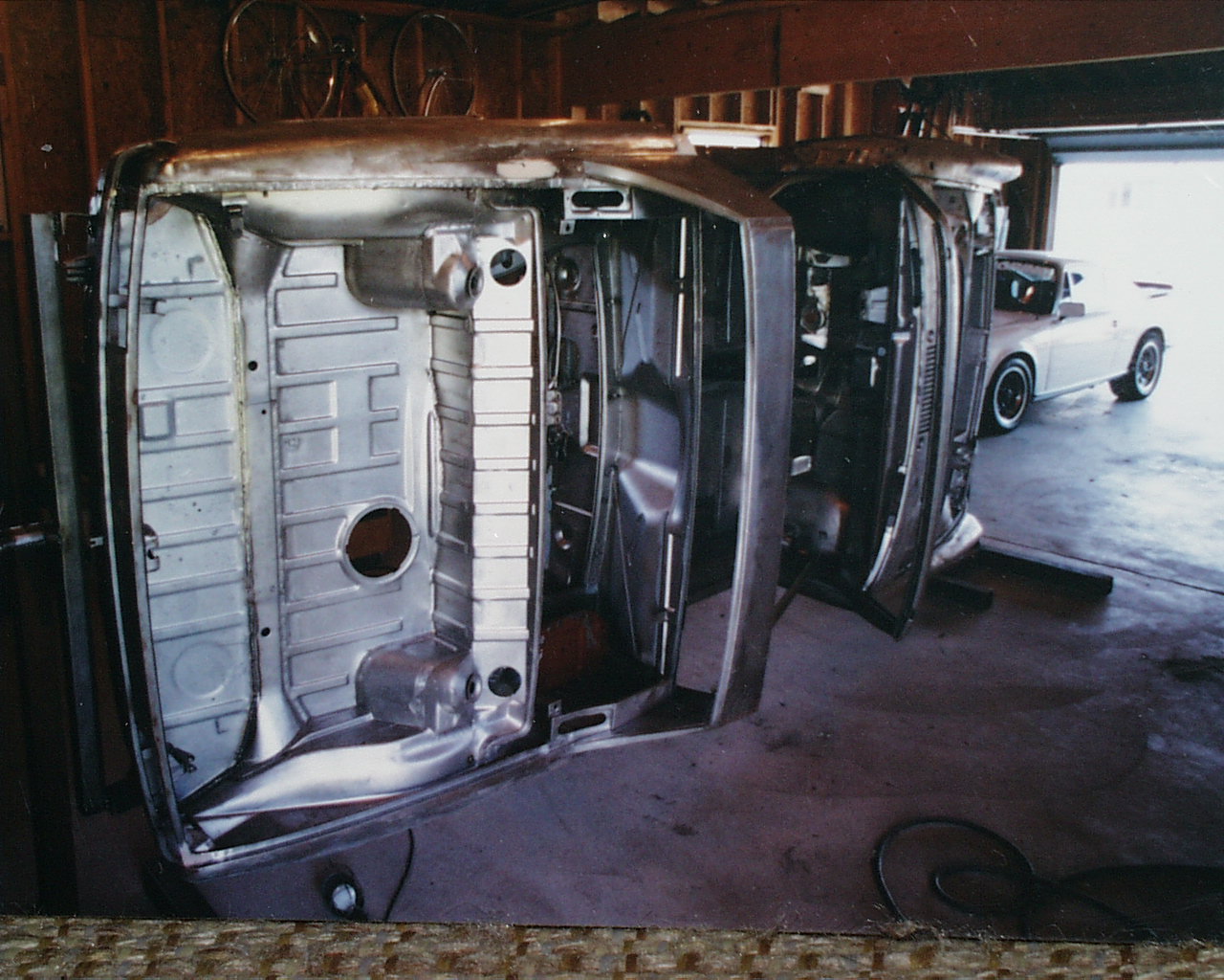

roblav1   My old car is the white one in the rotisserie. I...   Sep 2 2017, 06:21 PM

gandalf_025   This is what my car looked like when it came back ...   Mar 25 2021, 12:02 PM
930cabman   This is what my car looked like when it came back...   Mar 25 2021, 12:53 PM
