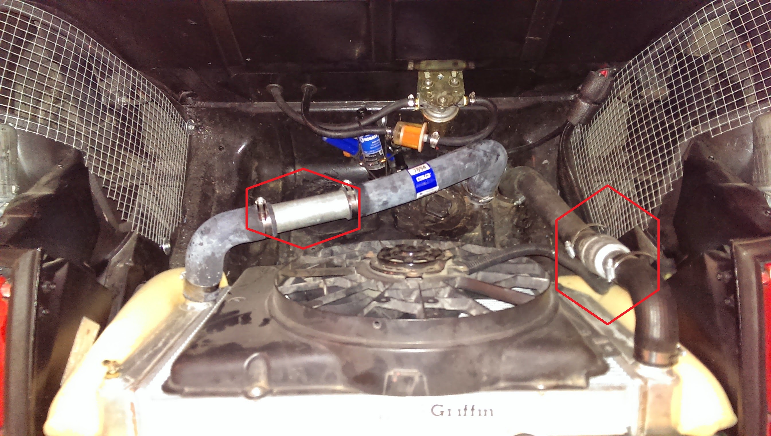

I have a 71 Chalon with a SBC. When building the car, I incorporated a heater core in the fresh air blower case and ran a couple of feet of heater hose from it with the intention of someday getting it all connected. Well, that day is here. My question is whether it's feasible to tie the the heater core lines to the radiator inlet and outlet hoses via T's instead of running the heater core lines back to the engine's intake manifold and water pump.
What do you think... doable?

BRAVE_HELIOS   I have a 71 Chalon with a SBC. When building the ...   Nov 8 2014, 03:37 PM
Mike Bellis   Sorry, I didn't see the question. Yes, in theo...   Nov 8 2014, 04:45 PM
BRAVE_HELIOS   Sorry, I didn't see the question. Yes, in the...   Nov 10 2014, 10:27 PM
BRAVE_HELIOS   Sorry, I didn't see the question. Yes, in the...   Nov 17 2014, 11:30 PM
Mike Bellis   Pressure differential. it will flow. This is where...   Nov 17 2014, 11:53 PM
