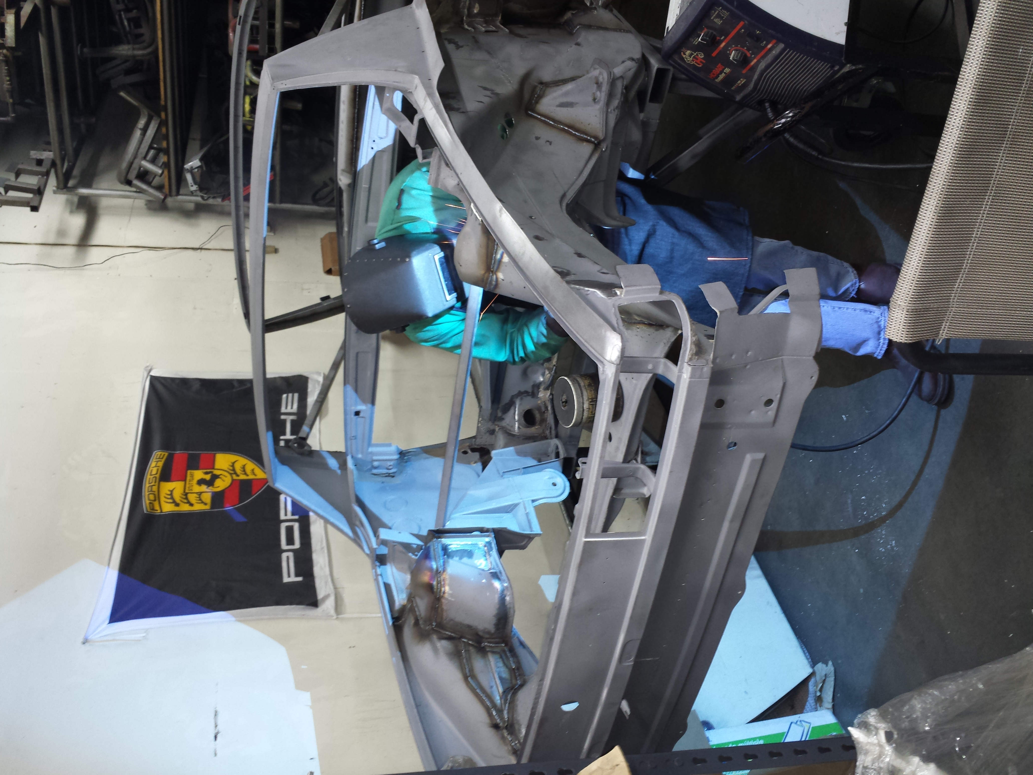

Had our current- build blasted with garnet sand. The media blast co. said that the 914 has the softest metal of all Porsches.
The grit + psi needs to be just right to avoid blasting damage.
Yes we are pulling sand out with vacuum cleaners + blowing it out too...but the unibody looks brand new, and welds like a dream !
MartyAttached Image
