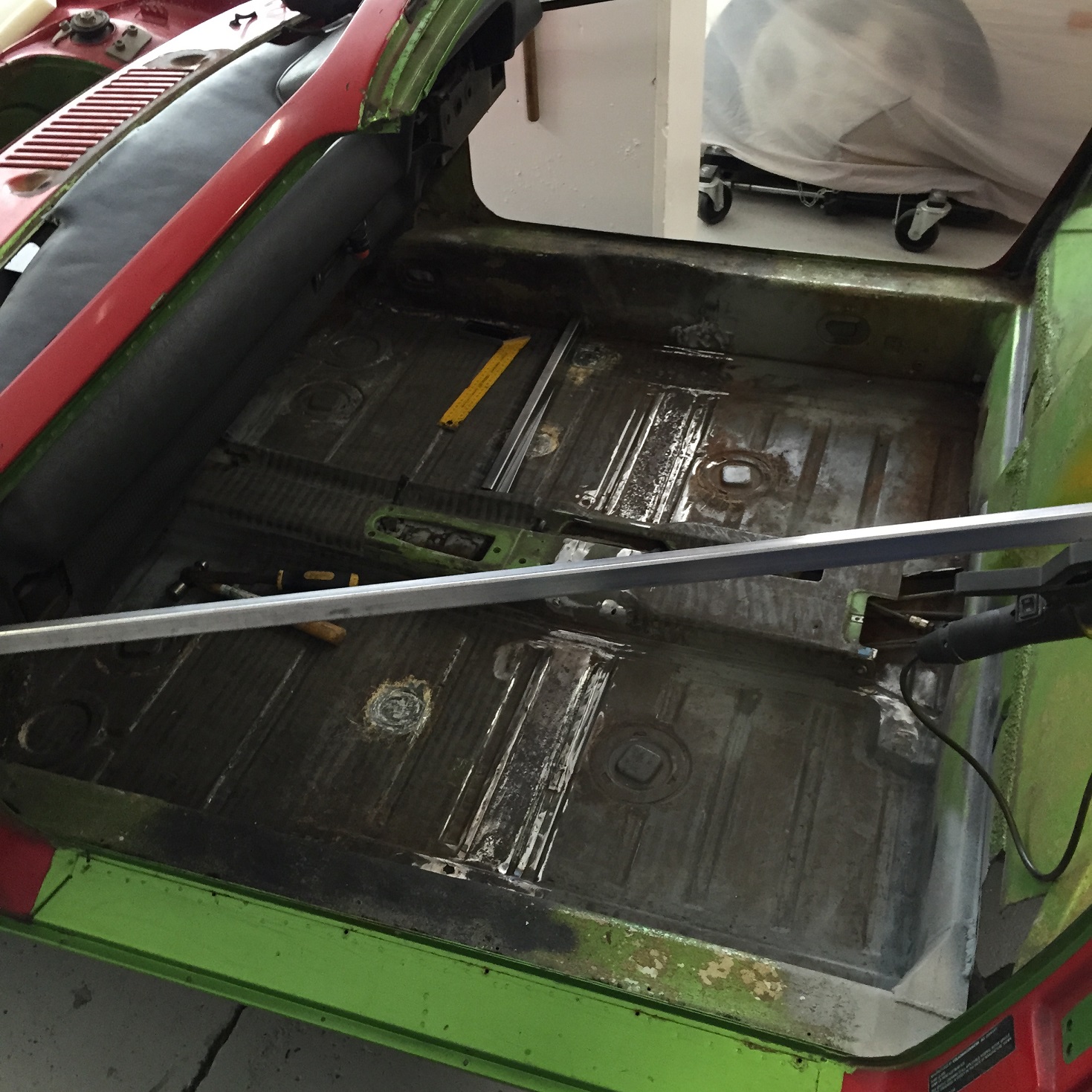

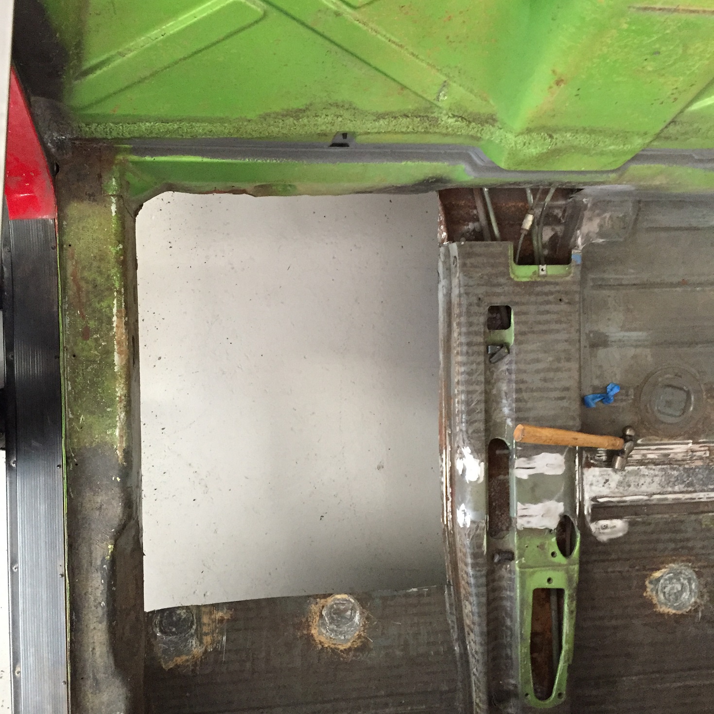

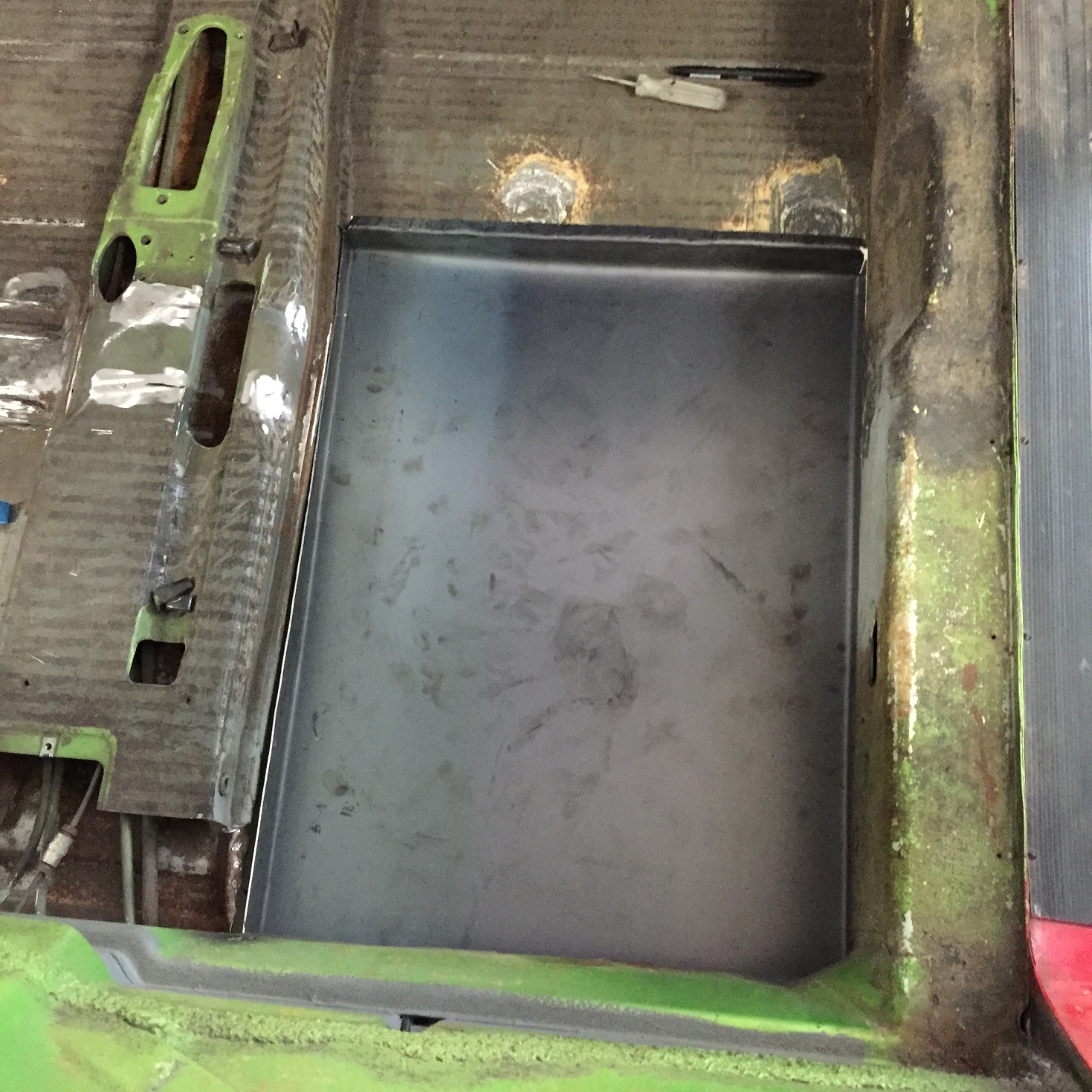

a few big days of work this week ...
where do I begin !?

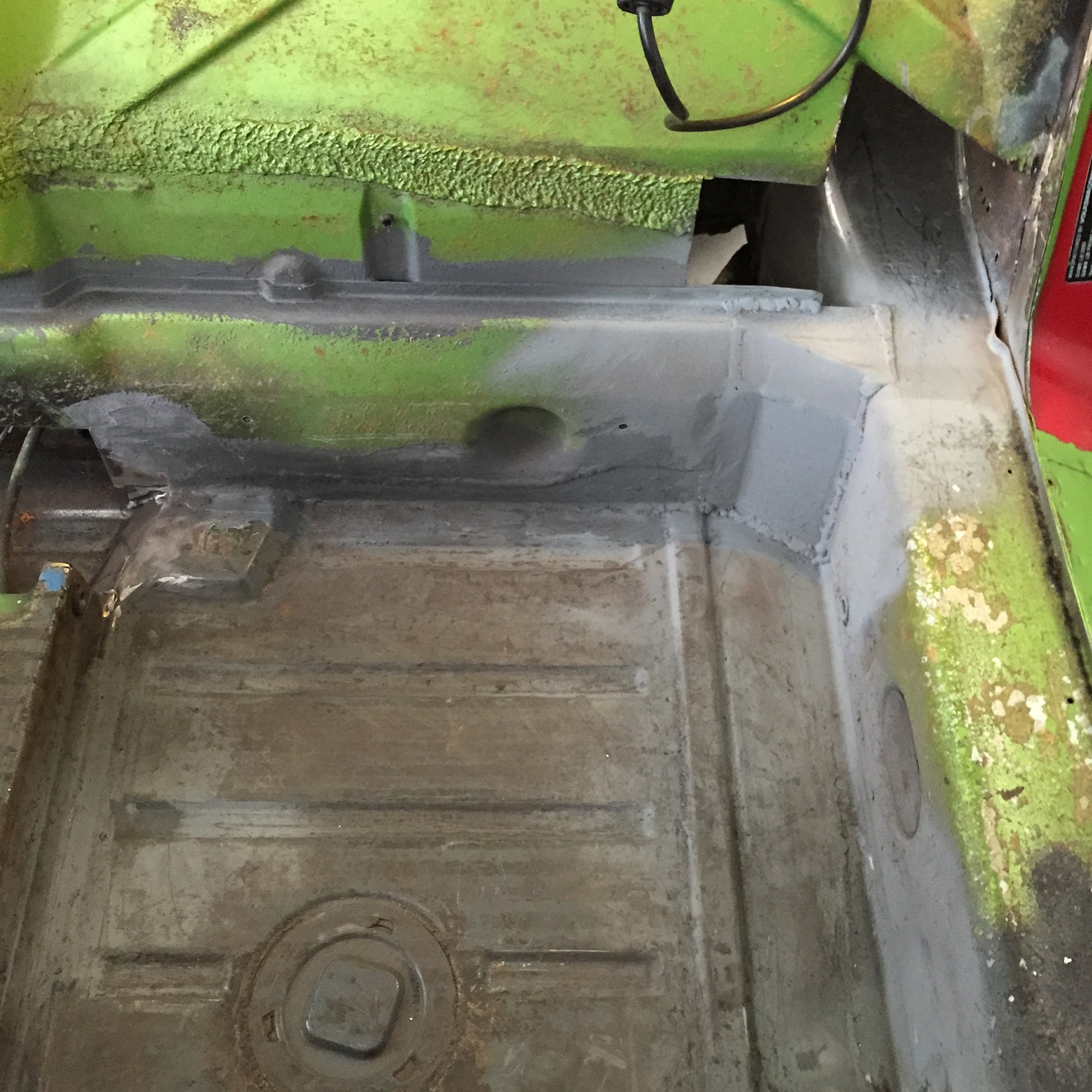

I finished fixing the inner / lower firewall with some welded in steel plate.
braced the front upper door mount to the seatbelt mount

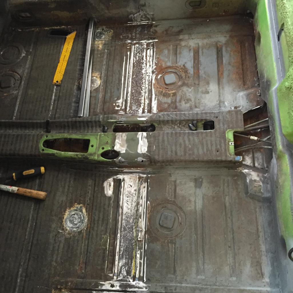

cut out the lateral floor support - while it looked in generally good condition on the outside there was a cornflake box of rust flakes inside it. cut it out as i'm moving it forwards to give some adjustability to the drivers seat. made up a couple of bars to replace the cross mount from 1.2mm SHS - will stitch weld them together. i also am going to drop the floor a couple of inches as i wont fit into the car with a helmet & roll cage ... upon looking at the floor a little closer, at the back, i decided to cut the floor out completely and make up a new floor. the rear of the right hand side floor was pretty poor condition due to the RHD conversion handbrake cable. bent up a new floor from 1.5mm steel - its about in place in the pic, but not yet welded in. there will be two flat bars welded the length of the floor to provide additional support to the seat mounts. the front of the floor drops down 20mm and ramps down to 50mm at the back, with the seats reclined i should get about the right amount of height.
bought a pair of cobra seats that fit perfectly (IMG:style_emoticons/default/smile.gif)
