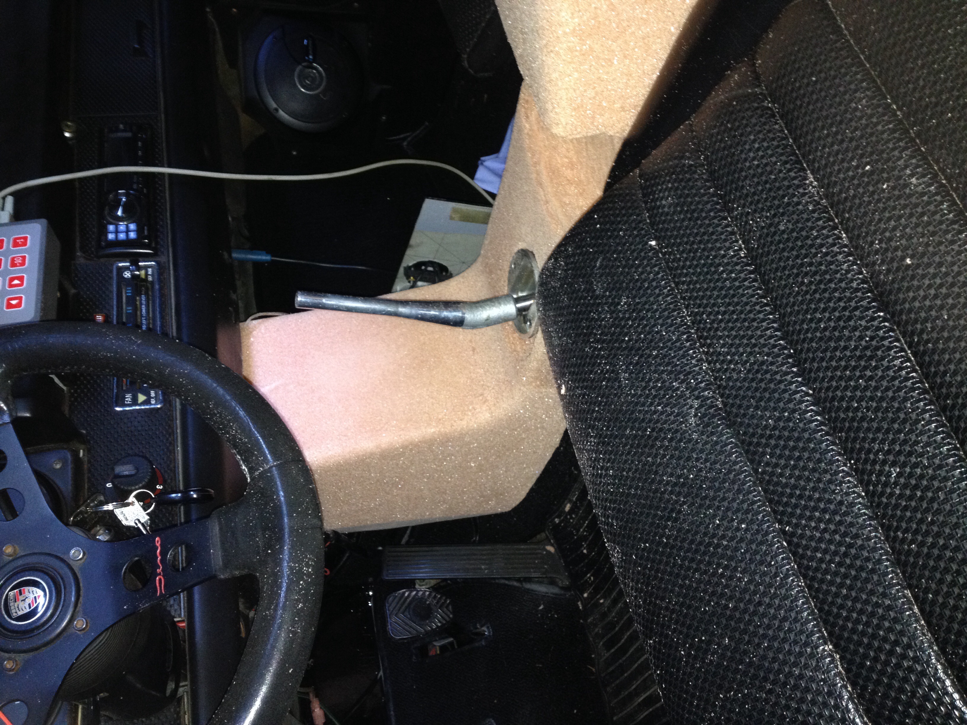

Found a big block of foam and thought I would see about making my own center console. Here's the progress so far. This will be my first project using fiberglass... any pointers or advice? Should I use cloth or mat? Should I paint or use color resin?
Thanks
Rob

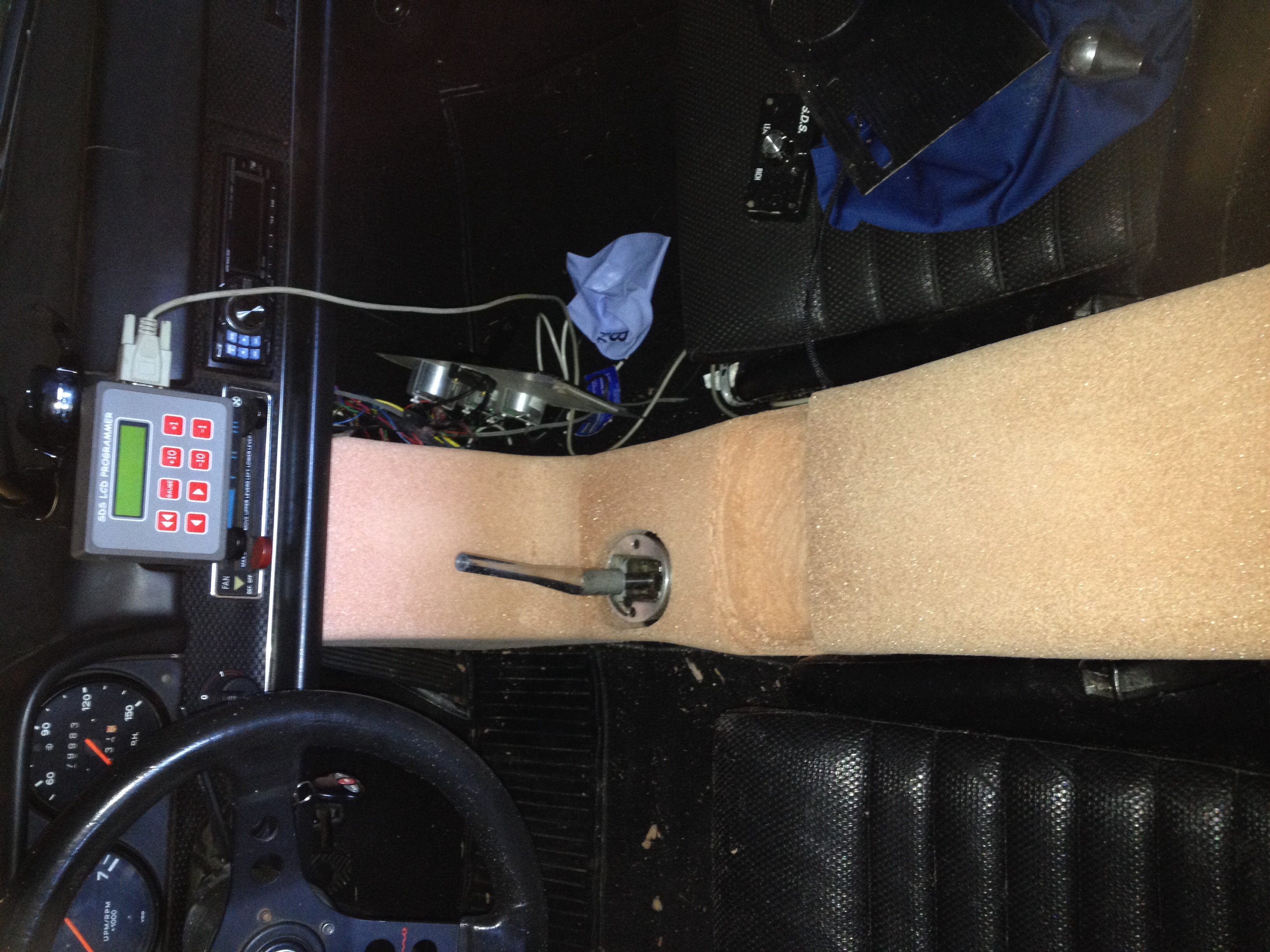

A bit more progress.

McMark   Mat will work fine. Don't try to do it all in...   Nov 9 2014, 10:53 AM
McMark   Oh and you might as well stick a 6.5" subwoof...   Nov 9 2014, 10:55 AM
rtalich   Thanks Mark! If I used cloth and then a few co...   Nov 9 2014, 12:03 PM
PanelBilly   Wrap it in vinyl and make an upholstered cap   Nov 9 2014, 12:12 PM
porschefile2010   Interesting job ahead of you. Regardless of what y...   Nov 9 2014, 12:19 PM
Bob L.   How are you going to Handle the hole for the shift...   Nov 9 2014, 12:27 PM
veekry9   http://www.fiero.nl/forum/Forum3/HTML/000091-53.ht...   Nov 9 2014, 04:45 PM
barefoot   Recommend using epoxy. I've used quite a bi...   Nov 10 2014, 11:41 AM
rtalich   How are you going to Handle the hole for the shif...   Nov 9 2014, 06:01 PM
McMark   Just plan on using bondo, cause it's gonna hap...   Nov 9 2014, 06:39 PM

rtalich   Thanks for all the suggestions so far!! At...   Nov 10 2014, 02:31 PM
ThePaintedMan   Thanks for all the suggestions so far!! A...   Nov 11 2014, 08:08 PM
porschefile2010   And for a first time amateur build I really think ...   Nov 12 2014, 12:19 PM
barefoot   And for a first time amateur build I really think...   Nov 12 2014, 05:08 PM

rtalich   Thanks!!! I will follow the steps and ...   Nov 12 2014, 12:33 PM
McMark   Consider some access to adjust the shifter. If yo...   Nov 12 2014, 12:50 PM
G e o r g e   are you going to incorporate a spot for the SDS co...   Nov 12 2014, 02:00 PM
rtalich   are you going to incorporate a spot for the SDS c...   Nov 12 2014, 02:08 PM
