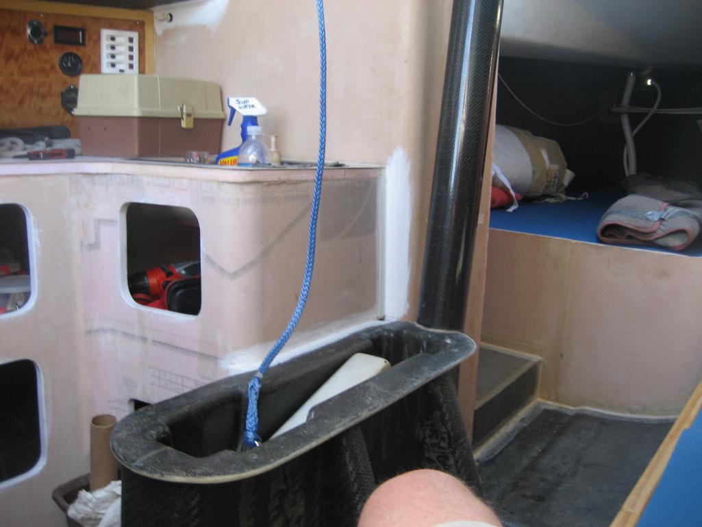

Don't need peel ply, just plastic sheet like visqueen to get smooth surface. My experience is using epoxy and with the west system resign/hardeners & pumps you get the correct resin/ hardener mix every time. Here's example of curved surfaces done without peel-ply or plastic sheet. wet out the foam and lay fabric over and wet out again. Again 2 plys is what i have used. but wanted more structure for marine interior panels. These left with fabric print-thru, then painted
