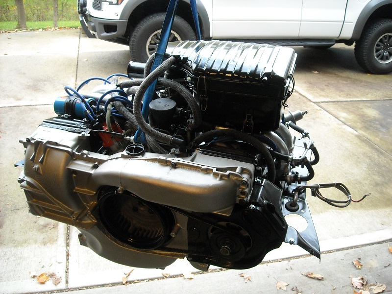

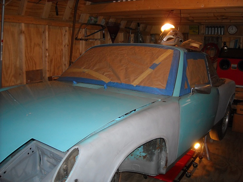

Olympic 914
post Nov 14 2014, 09:26 PM
Posts: 1,795
Joined: 7-July 11
From: Pittsburgh PA
Member No.: 13,287
QUOTE(r_towle @ Nov 14 2014, 12:16 AM) *
Cool. one of the other poster said he built an engine with those heads running my favorite....Djet.
Just curious if I could try something new....different and push it a bit more...
Will wait to see how it runs in his car to see if it's worth pursuing the heads...but I might just to see if it can get a little bit more from djet.
Will be awhile till it runs. the engine is done
But the body work is progressing slowly.
