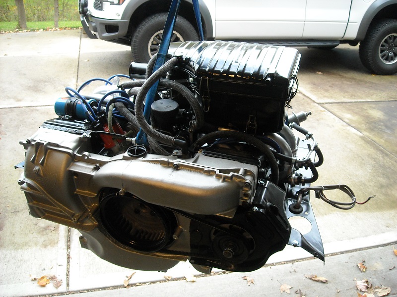

You just described my build, with the addition of H-beam rods and a total balance job. I went with the RS+ heads. mine is the D-jet though, I think that might be near the max for the D-jet. maybe the L-jet can handle more.
Unfortunately it will be a while until the engine is installed in the car, So I can't give any observations of how it runs. confused24.gif
But I think it should be a fun engine.

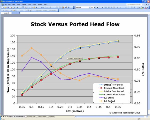

On a 2056, about 15HP worth of difference back to back.
On the flow bench the peak flow is very similar, but where the flow peaks at is different and low lift flow and chamber filling is dramatically increased.
The biggest difference is the altered port flow margins between intake and exhaust ports. Remember, peak flow mans a lot less than where the flow is made and what intake : exhaust flow margins are.
These port flow margins work really well with the split duration cams that I developed as part of many engine combinations.
Here's a graph that was handy from the 2006 offerings, the RS is more refined now than this, but this is the general idea. Remember, this is dry flow data and doesn't show swirl, or tumble, or port velocity. But we have all that data as well.

r_towle
QUOTE(Jake Raby @ Nov 13 2014, 11:59 PM) *
QUOTE(r_towle @ Nov 13 2014, 08:15 PM) *
What is the difference is head flow between the stock heads and the RS heads?
Curious how much change is occurring....
On the flow bench the peak flow is very similar, but where the flow peaks at is different and low lift flow and chamber filling can be up by 35%.
And that increase in flow works ok with DJET?
That is kinda why I asked, guy above said he was going with Djet, just curious how it likes that.....cause it does not like a lot of change.....
Rich
Jake Raby
This is the head that was developed to work with L jet as a primary objective. The L Jet doesn't recognize the changes the heads offer.

HAM Inc
QUOTE(Jake Raby @ Nov 13 2014, 09:59 PM) *
IPB Image
That's flow data from two generations ago. We blew past that a while ago. We no longer put flow data out for public consumption, but let's just say that the current version of the RS+ is substantially more potent. That data was from the transition version when the RS+ superseded the LE-180.

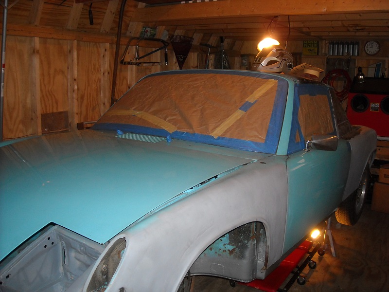

Olympic 914
QUOTE(r_towle @ Nov 14 2014, 12:16 AM) *
Cool. one of the other poster said he built an engine with those heads running my favorite....Djet.
Just curious if I could try something new....different and push it a bit more...
Will wait to see how it runs in his car to see if it's worth pursuing the heads...but I might just to see if it can get a little bit more from djet.
Will be awhile till it runs. the engine is done
But the body work is progressing slowly.
Olympic 914
Damn, don't know why the picture did that..???
Fixed....
