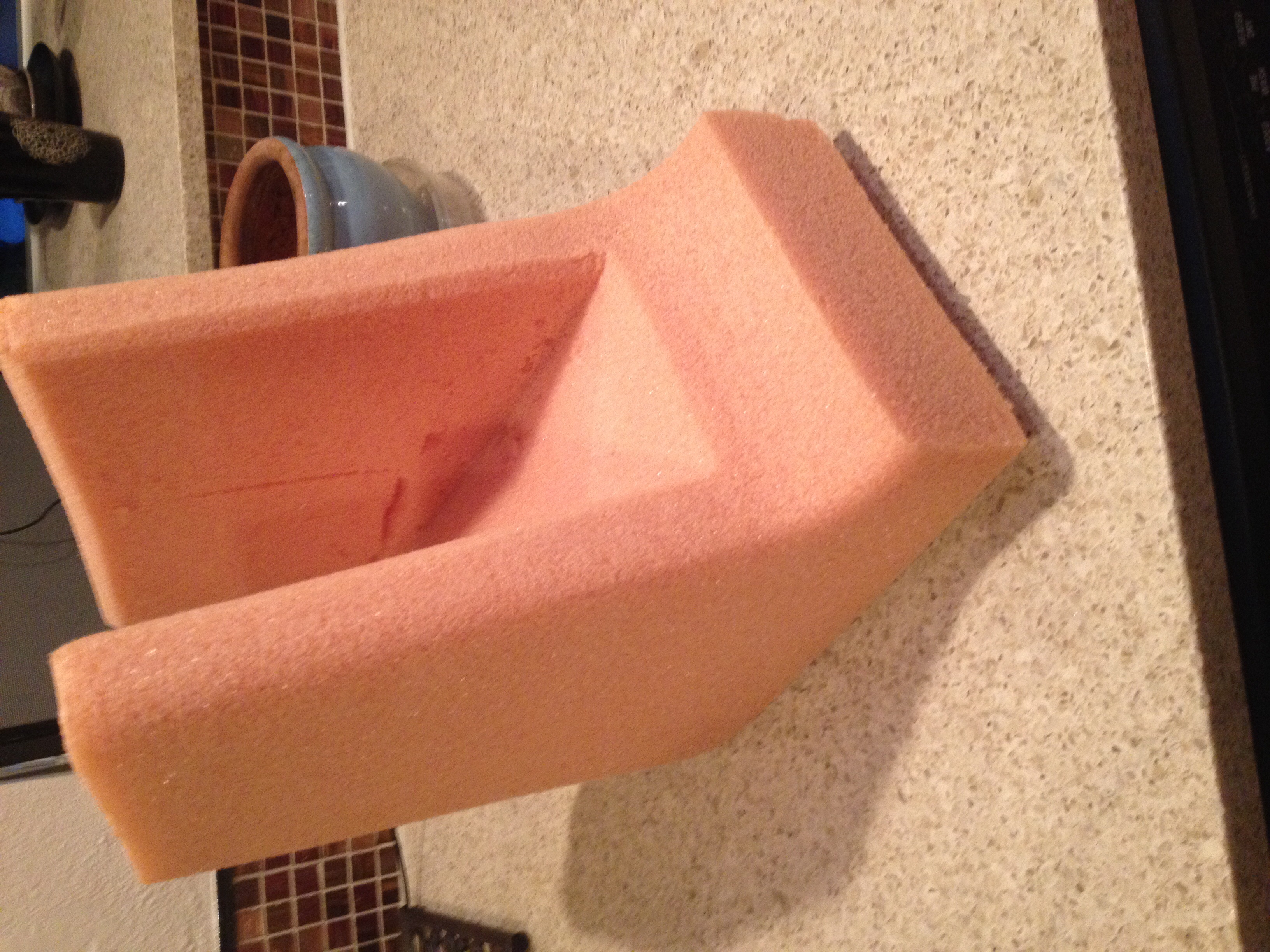

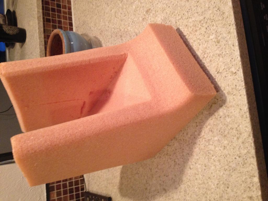

Some progress. I brushed on a few coats of white wood glue to seal the foam.
Before:
rtalich   Interior remodeling   Nov 9 2014, 10:46 AM

rtalich   Some progress. I brushed on a few coats of white w...   Nov 21 2014, 05:13 PM
rtalich   Before:   Nov 21 2014, 05:13 PM
rtalich   After:   Nov 21 2014, 05:14 PM
rtalich   One more. Ready for glass. I am leaning toward co...   Nov 21 2014, 05:19 PM
