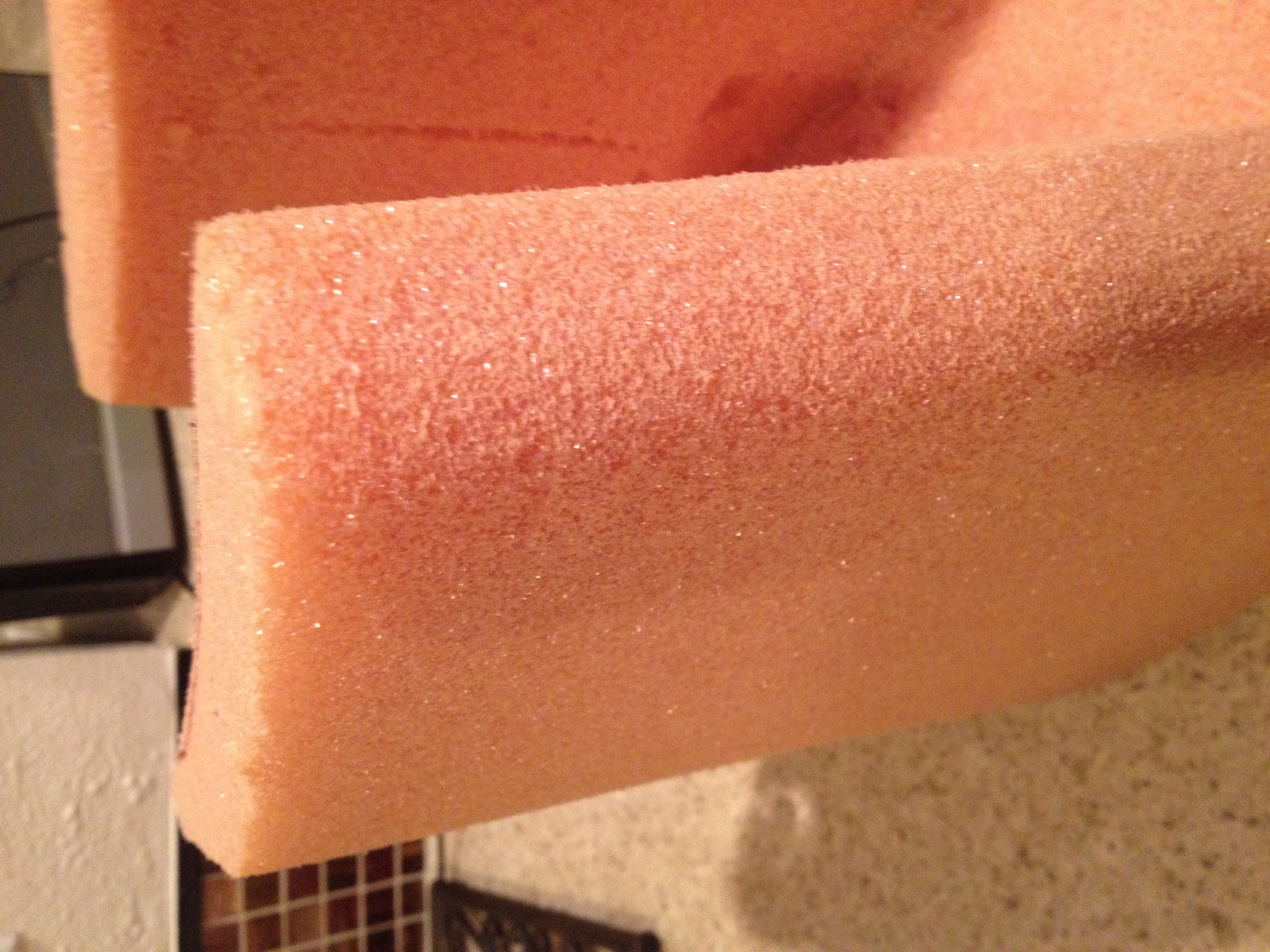

Found a big block of foam and thought I would see about making my own center console. Here's the progress so far. This will be my first project using fiberglass... any pointers or advice? Should I use cloth or mat? Should I paint or use color resin?

McMark   Mat will work fine. Don't try to do it all in...   Nov 9 2014, 10:53 AM

rtalich   Thanks Mark! If I used cloth and then a few co...   Nov 9 2014, 12:03 PM

porschefile2010   Interesting job ahead of you. Regardless of what y...   Nov 9 2014, 12:19 PM
Bob L.   How are you going to Handle the hole for the shift...   Nov 9 2014, 12:27 PM

barefoot   Recommend using epoxy. I've used quite a bi...   Nov 10 2014, 11:41 AM
rtalich   How are you going to Handle the hole for the shif...   Nov 9 2014, 06:01 PM
McMark   Just plan on using bondo, cause it's gonna hap...   Nov 9 2014, 06:39 PM

rtalich   Thanks for all the suggestions so far!! At...   Nov 10 2014, 02:31 PM

rtalich   Thanks!!! I will follow the steps and ...   Nov 12 2014, 12:33 PM
McMark   Consider some access to adjust the shifter. If yo...   Nov 12 2014, 12:50 PM

rtalich   Some progress. I brushed on a few coats of white w...   Nov 21 2014, 05:13 PM

rtalich   One more. Ready for glass. I am leaning toward co...   Nov 21 2014, 05:19 PM

Chris914n6   Did you compensate for the thickness of the glass/...   Nov 21 2014, 06:35 PM
rtalich   Very nice! Thats almost marketable! [qu...   Nov 22 2014, 01:05 PM
914Sixer   What about using the heat shrink type material use...   Nov 22 2014, 05:20 PM
rtalich   What about using the heat shrink type material us...   Nov 22 2014, 07:00 PM
