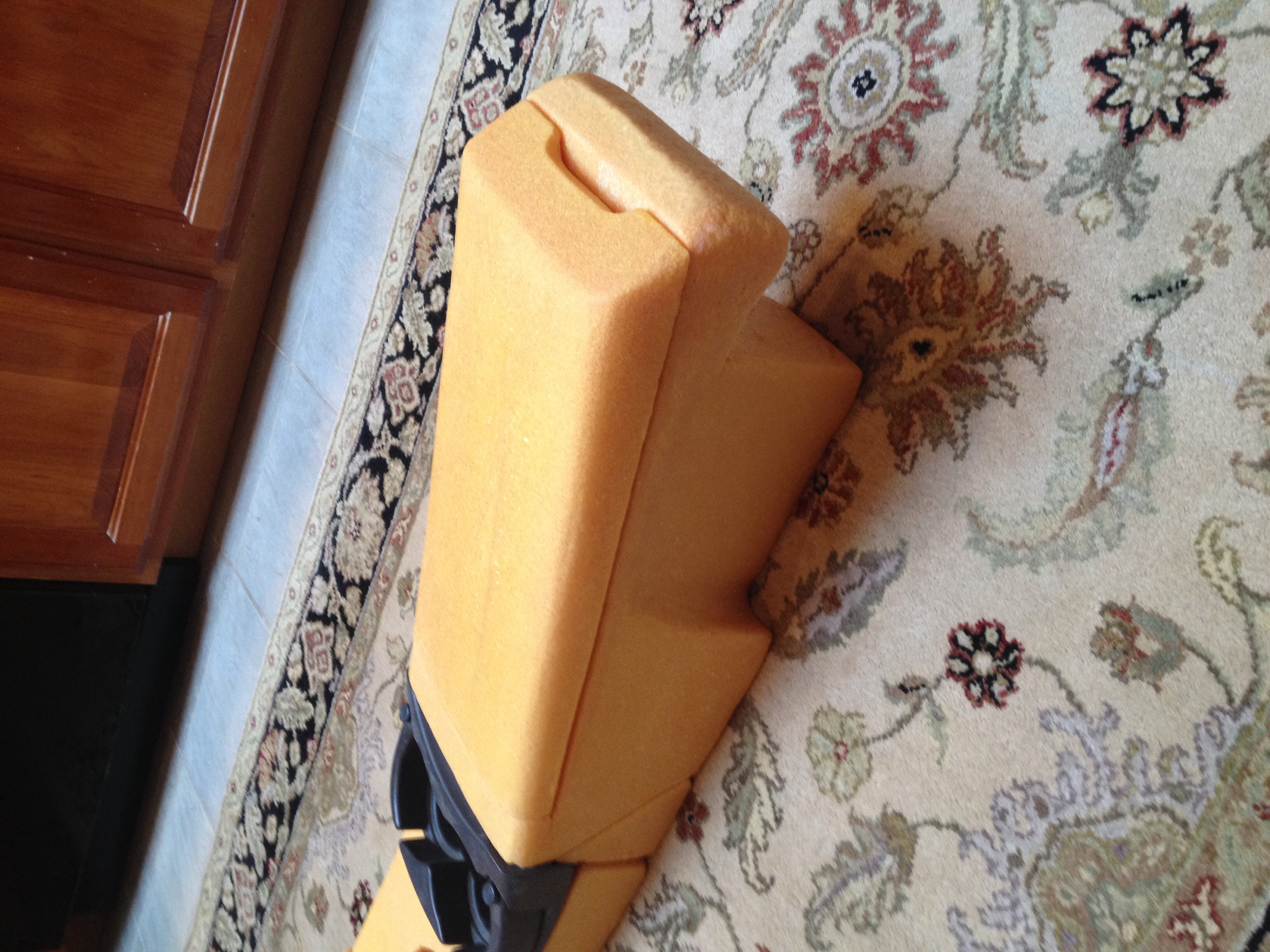

Found a big block of foam and thought I would see about making my own center console. Here's the progress so far. This will be my first project using fiberglass... any pointers or advice? Should I use cloth or mat? Should I paint or use color resin?
Thanks
Rob

One more. Ready for glass. I am leaning toward covering the main parts with thin foam and vinyl. And then make molds for the compartment lid and gauge panel. And then making those parts with carbn fiber.
Pretty happy with the results so far!!

McMark   Mat will work fine. Don't try to do it all in...   Nov 9 2014, 10:53 AM
McMark   Oh and you might as well stick a 6.5" subwoof...   Nov 9 2014, 10:55 AM
rtalich   Thanks Mark! If I used cloth and then a few co...   Nov 9 2014, 12:03 PM

porschefile2010   Interesting job ahead of you. Regardless of what y...   Nov 9 2014, 12:19 PM
Bob L.   How are you going to Handle the hole for the shift...   Nov 9 2014, 12:27 PM

barefoot   Recommend using epoxy. I've used quite a bi...   Nov 10 2014, 11:41 AM
rtalich   How are you going to Handle the hole for the shif...   Nov 9 2014, 06:01 PM
McMark   Just plan on using bondo, cause it's gonna hap...   Nov 9 2014, 06:39 PM

rtalich   Thanks for all the suggestions so far!! At...   Nov 10 2014, 02:31 PM

rtalich   Thanks!!! I will follow the steps and ...   Nov 12 2014, 12:33 PM
McMark   Consider some access to adjust the shifter. If yo...   Nov 12 2014, 12:50 PM

Chris914n6   Did you compensate for the thickness of the glass/...   Nov 21 2014, 06:35 PM
rtalich   Very nice! Thats almost marketable! [qu...   Nov 22 2014, 01:05 PM
