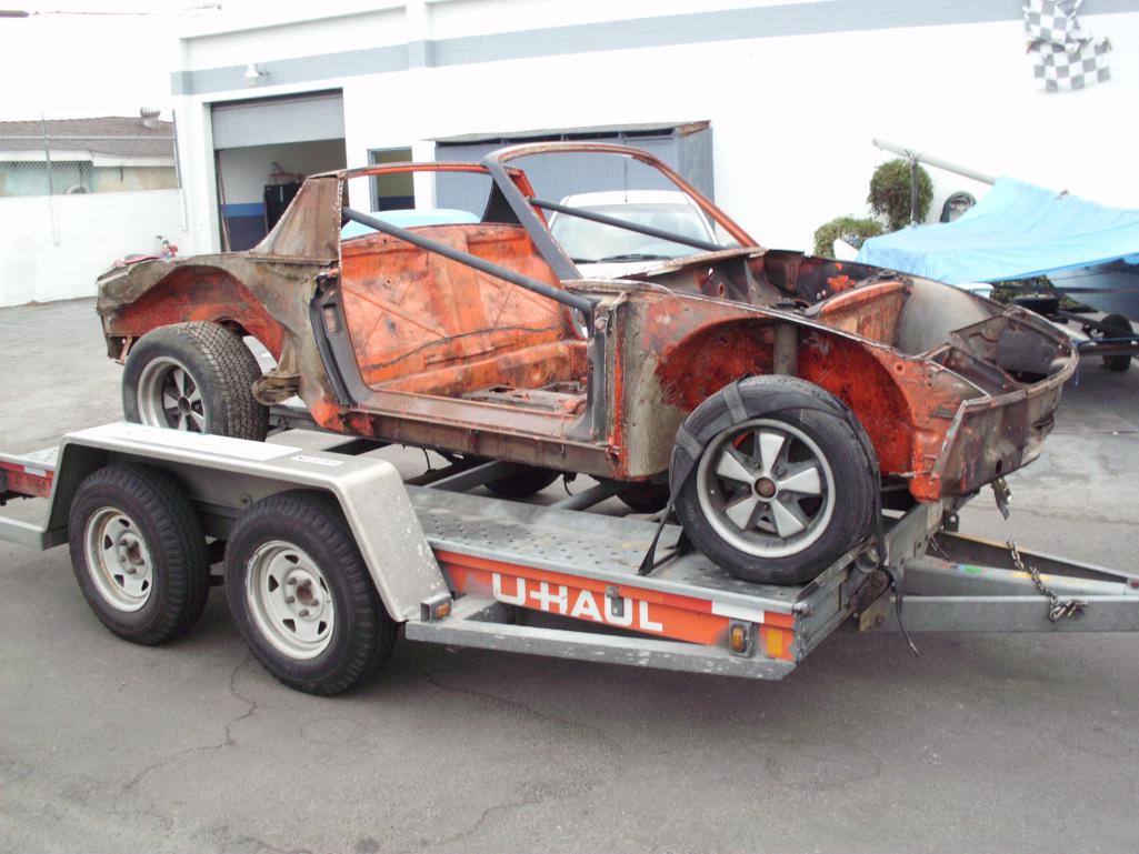

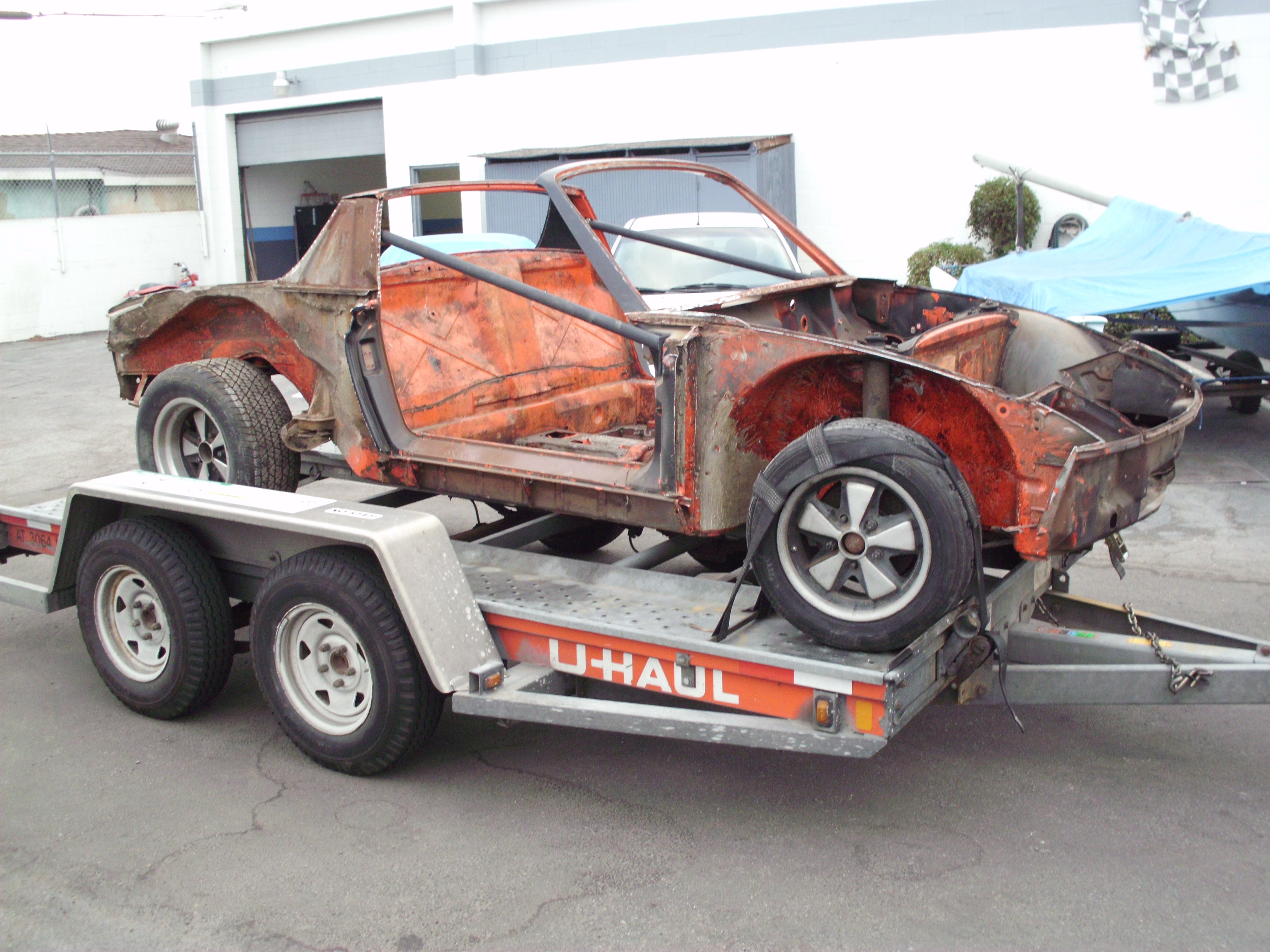

Hi all, I’m still a newbie here on world, I’ve made a few posts but have not yet formally introduced myself. My name is Kent and I have been restoring cars for over 20 years now. I did the reconstruction, body and paint on Andy’s (socalandy) 914-6. I immediately became hooked on 914,s and bought and built a 914 V8 conversion. I am starting a new restoration on another 914-6 so I will be posting pics of the progress as I go. The owner of this cars name is Jim and he has done a nice job of rounding up and restoring many of the parts thus far so this will no doubt be a nice car in the end. Andy (socalandy) posted a thread on this car a few months back and now it is in my shop and I’m ready to begin.

914350   The Donor Car. R.I.P. I will be using the fenders...   Oct 24 2014, 12:44 PM
PanelBilly   If it wasn't for the vin # on the /6, I'd ...   Oct 24 2014, 12:48 PM

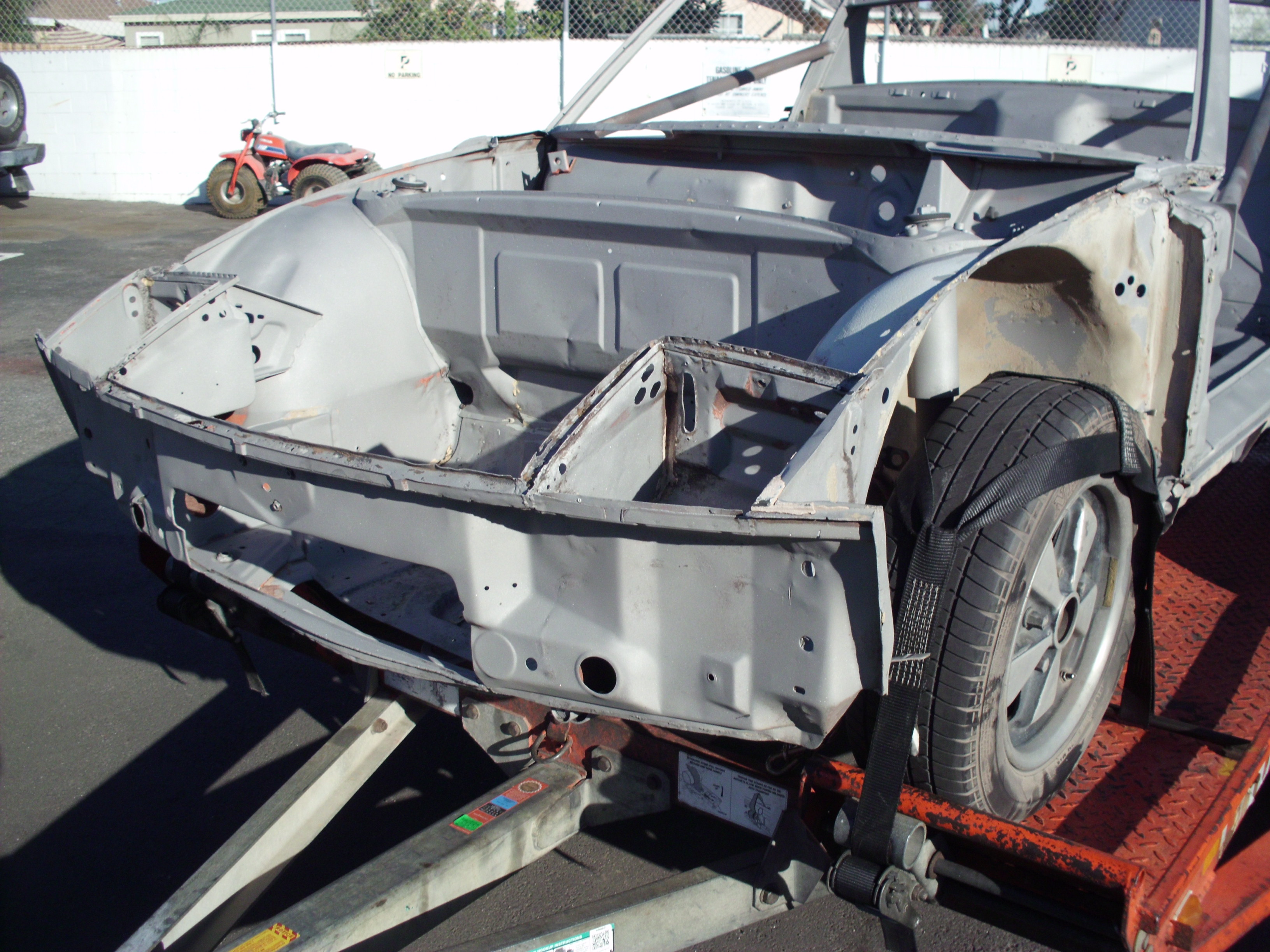

914350   Headed to media blasting. Used Cap lugs to keep m...   Nov 1 2014, 12:12 AM
914350   More pics.   Nov 1 2014, 12:18 AM
914350   ...at BD&G Blasting Co.   Nov 1 2014, 12:20 AM

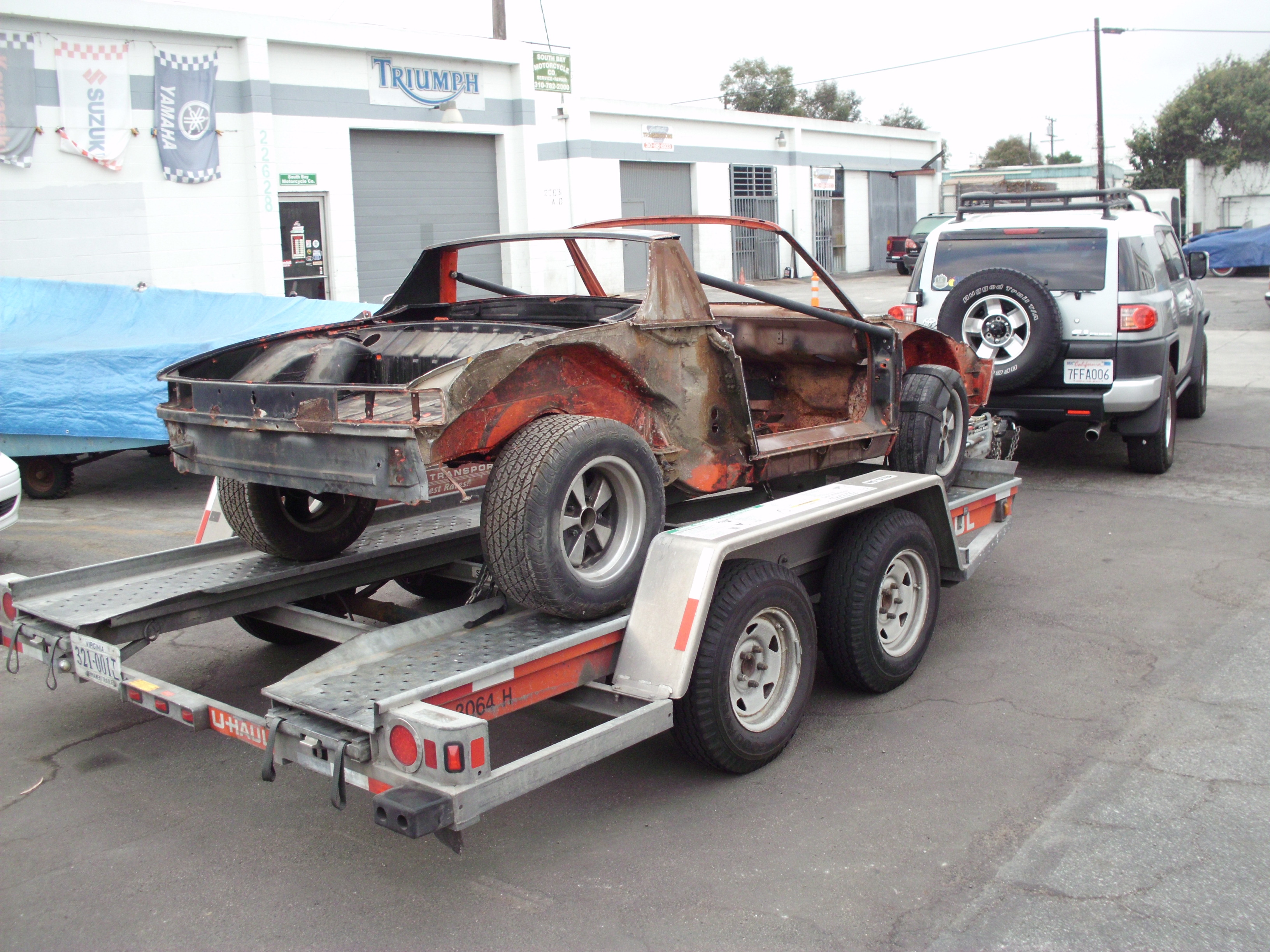

914350   Andy came out and helped. We used his FJ to tow t...   Nov 1 2014, 12:30 AM

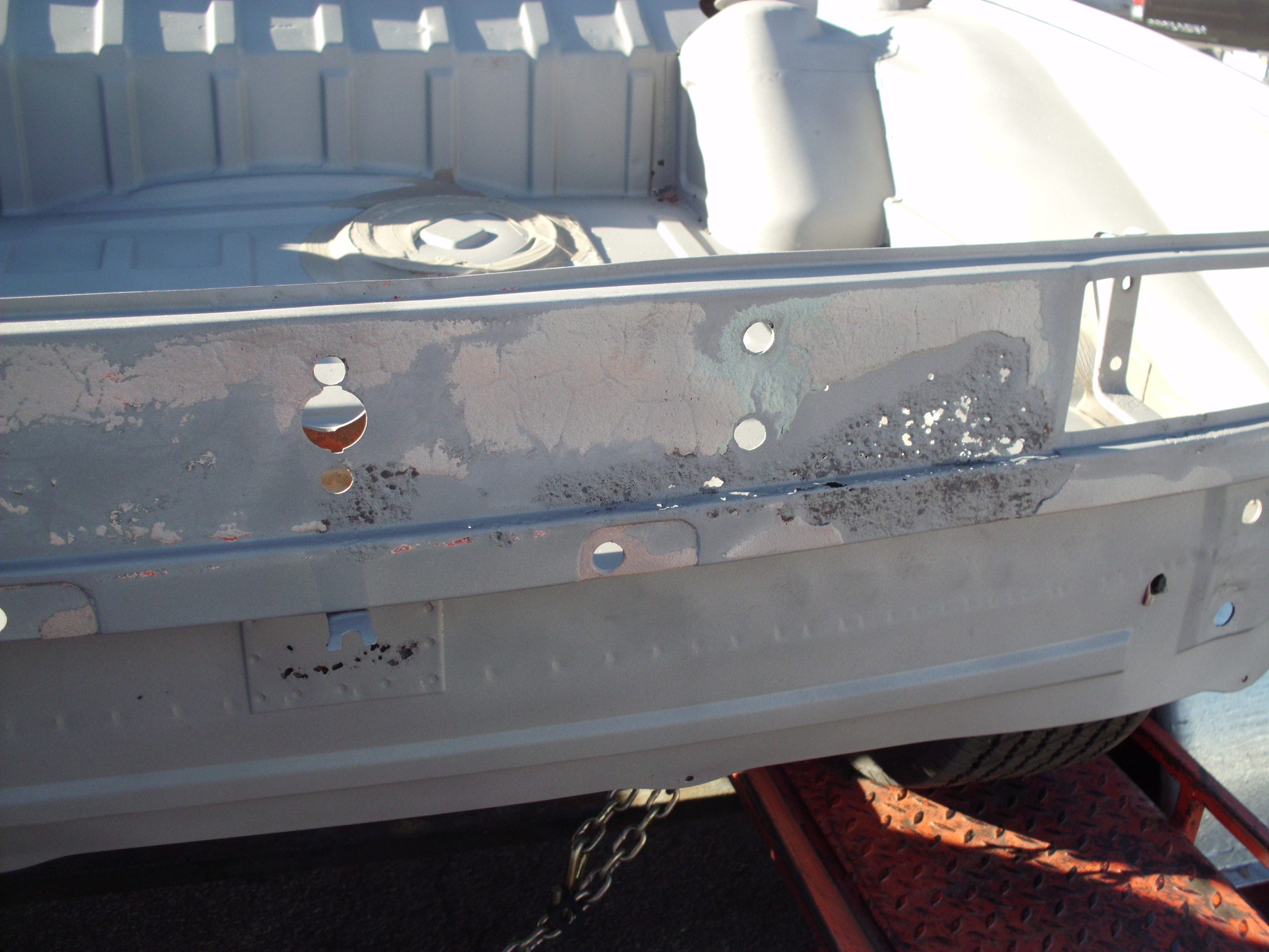

914350   The Donor car measured out great so I will use it ...   Nov 25 2014, 10:35 AM
doug_b_928   The Donor car measured out great so I will use it...   Nov 25 2014, 02:05 PM
914350   The Donor car measured out great so I will use i...   Nov 28 2014, 10:57 PM
914350   Got the car back from media blasting.   Nov 25 2014, 10:36 AM
914350   More pics.   Nov 25 2014, 10:38 AM
914350   More pics.   Nov 25 2014, 10:39 AM

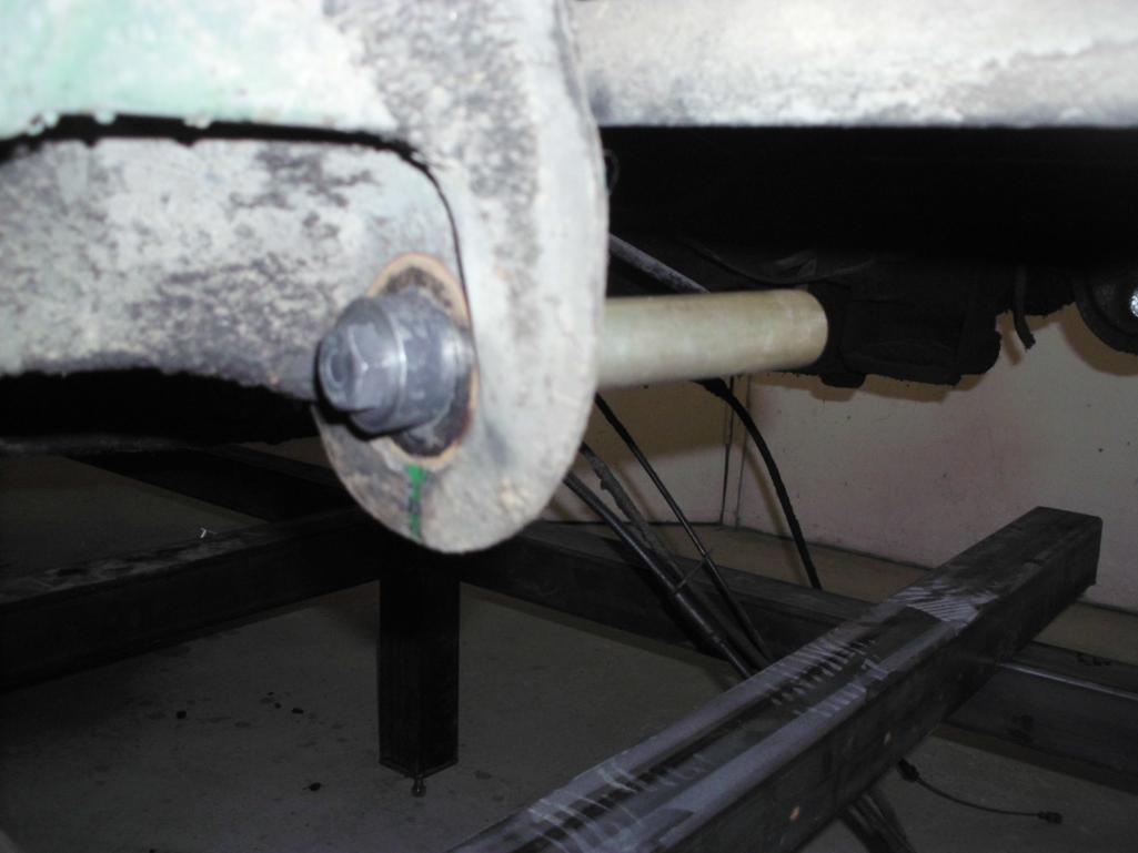

914350   Progress on the fixture.   Nov 28 2014, 10:29 PM
914350   More pics.   Nov 28 2014, 10:32 PM
914350   More pics.   Nov 28 2014, 10:36 PM
914350   This fixture will be removable from the table so t...   Nov 28 2014, 10:46 PM

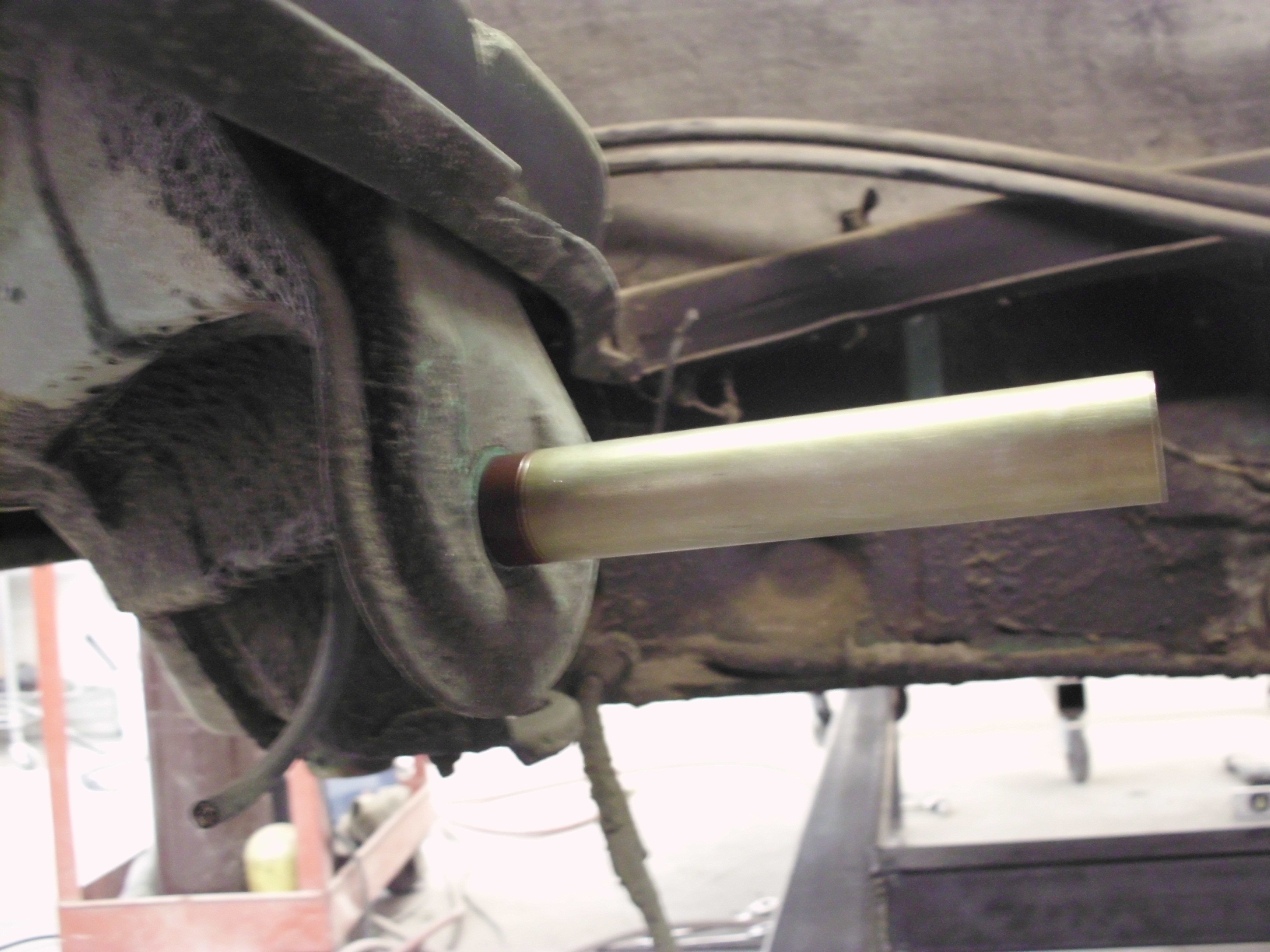

914350   Rear mounting points.   Nov 30 2014, 08:04 AM
914350   More pics.   Nov 30 2014, 08:06 AM
914350   I intalled an alignment dowl to relocate the front...   Nov 30 2014, 08:12 AM

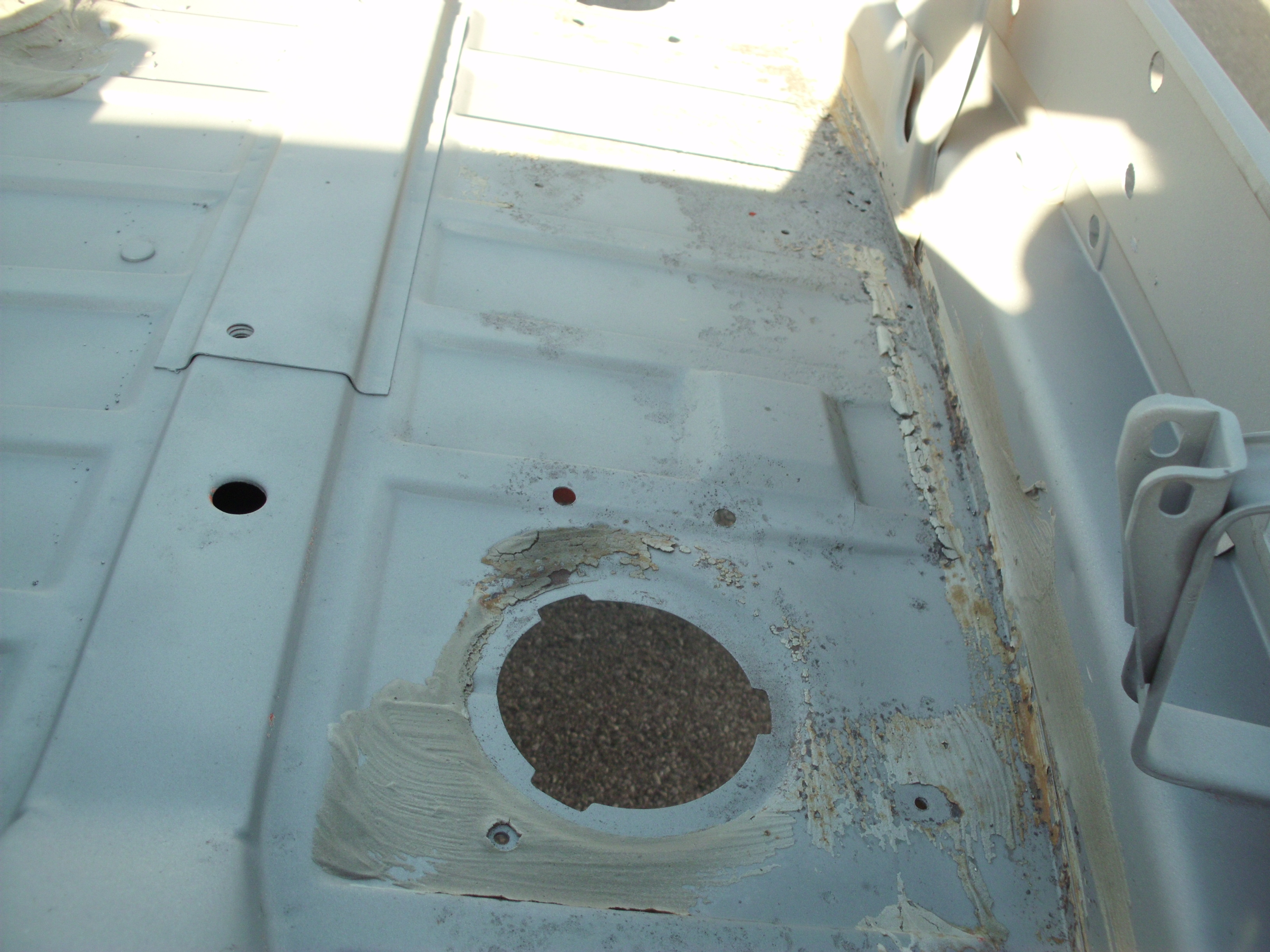

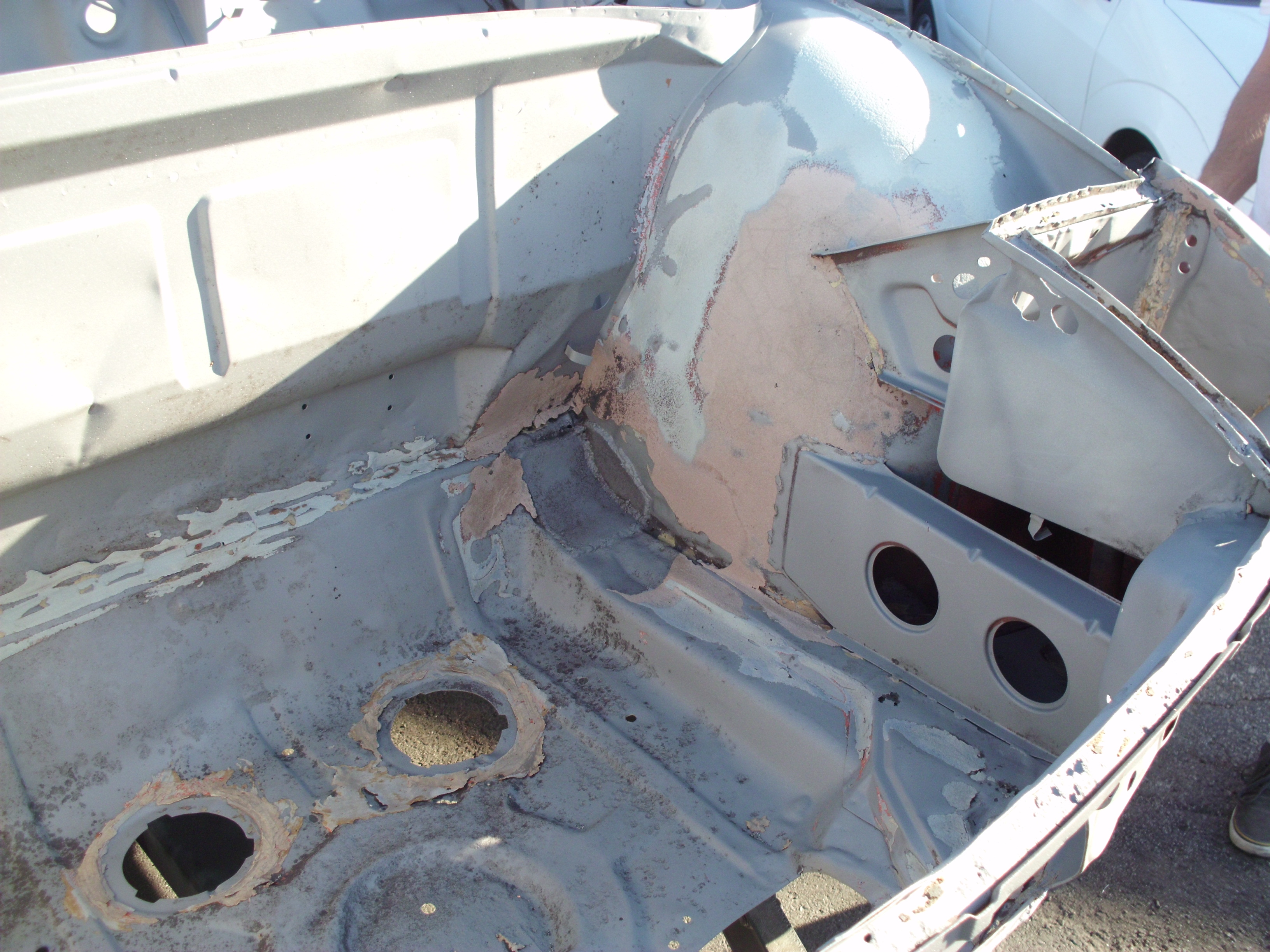

914350   More cutting, drilling, scraping on the donor car.   Dec 22 2014, 10:18 PM
914350   More pics.   Dec 22 2014, 10:21 PM
914350   More pics.   Dec 22 2014, 10:22 PM
