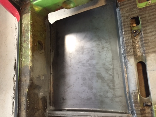

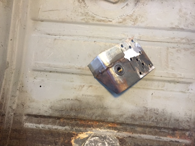

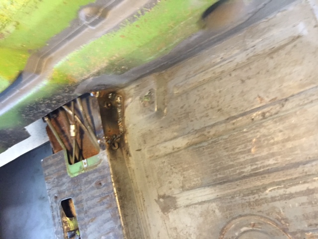

fabricated new harness mounting points for install in the centre section - upon advice from another 914 member the standard points are a little too far forwards with the harness buckle ending up on the seat rather than between seat & mount point. anyway, this allows me to use the standard mount point for the standard seatbelt as well, if I choose to use it.
mostly finished making the new floor & welded it in place. with the seat in place I now fit comfortably in the car, with enough room for roll cage & helmet/hans and can still see over the steering wheel. the new floor is approx. 40mm lower at the back and 15mm lower at the front. I've yet to complete the welding in of replacement cross floor beams.
