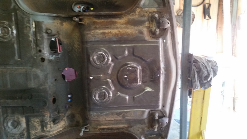

trojanhorsepower   Been a little busy with firewood, but I did get a ...   Nov 25 2014, 06:33 PM
trojanhorsepower   I was focusing on removing seam sealer. That went...   Nov 25 2014, 06:34 PM
trojanhorsepower   Tonight, with Hugh on the oil can we made some hol...   Nov 25 2014, 06:35 PM
trojanhorsepower   I need to clean up the backs of the holes, clean o...   Nov 25 2014, 06:38 PM

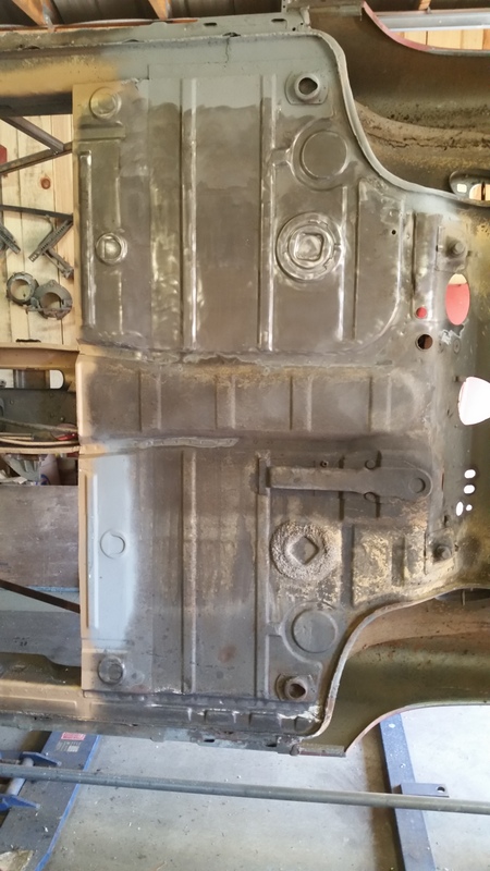

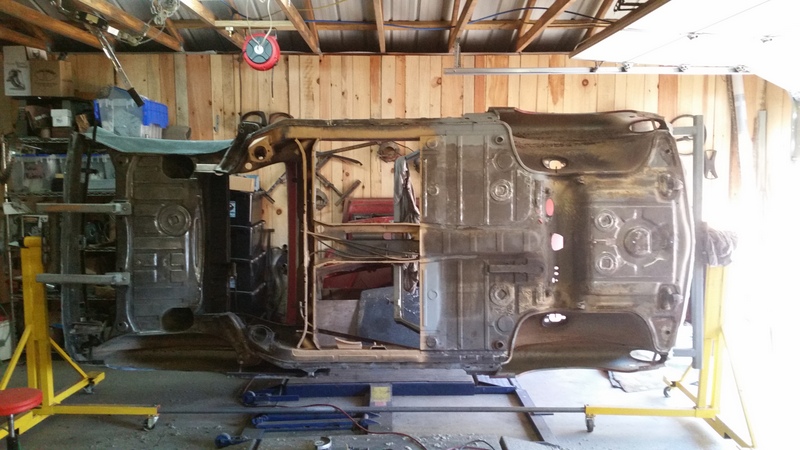

trojanhorsepower   OK, at long last, an update. I finished the under...   Apr 19 2015, 07:09 PM
trojanhorsepower   Now I have flipped the car around and started fitt...   Apr 19 2015, 07:12 PM
