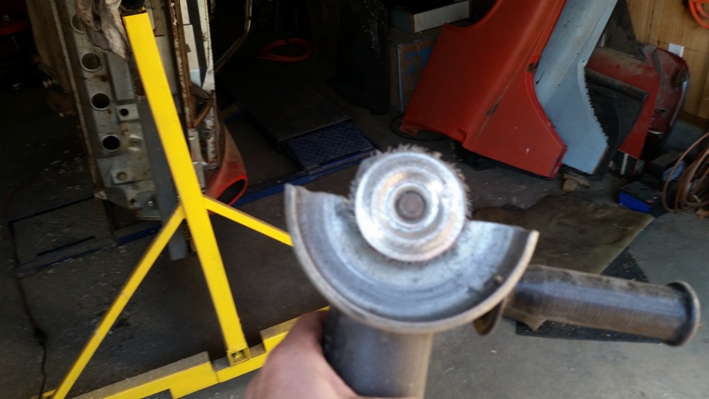

I was focusing on removing seam sealer. That went well until I got to a good stopping point.

trojanhorsepower   Been a little busy with firewood, but I did get a ...   Nov 25 2014, 06:33 PM
trojanhorsepower   I was focusing on removing seam sealer. That went...   Nov 25 2014, 06:34 PM
