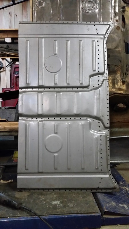

Tonight, with Hugh on the oil can we made some holes in the new floor.

trojanhorsepower   Tonight, with Hugh on the oil can we made some hol...   Nov 25 2014, 06:35 PM
trojanhorsepower   I need to clean up the backs of the holes, clean o...   Nov 25 2014, 06:38 PM
