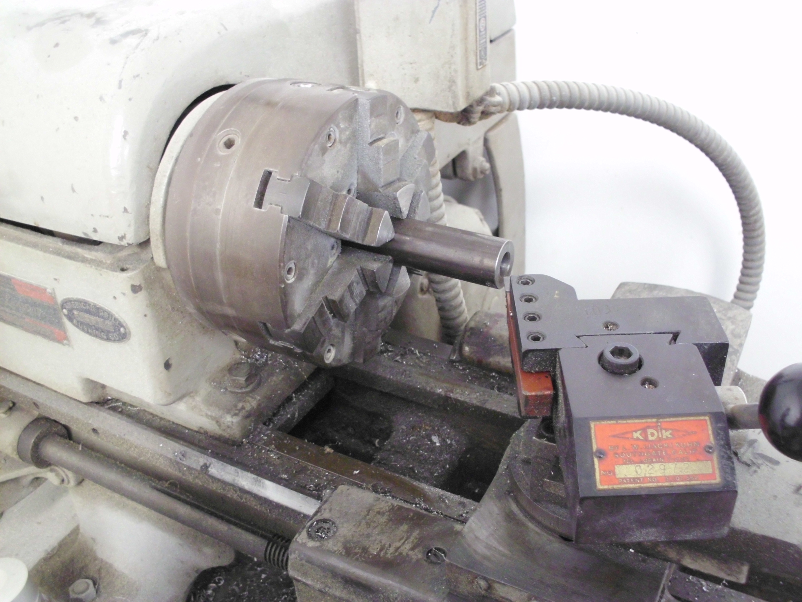

Socalandy   My Dad's Lathe hard at work :) getting clos...   Nov 30 2014, 02:21 PM
