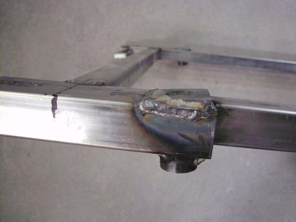

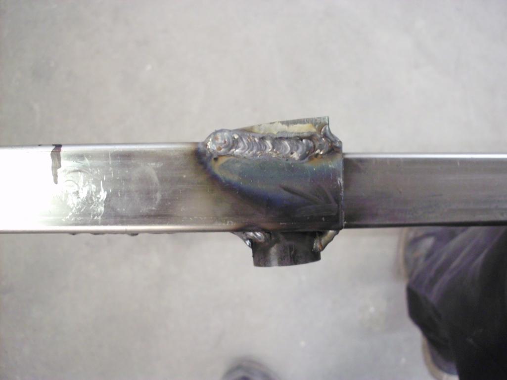

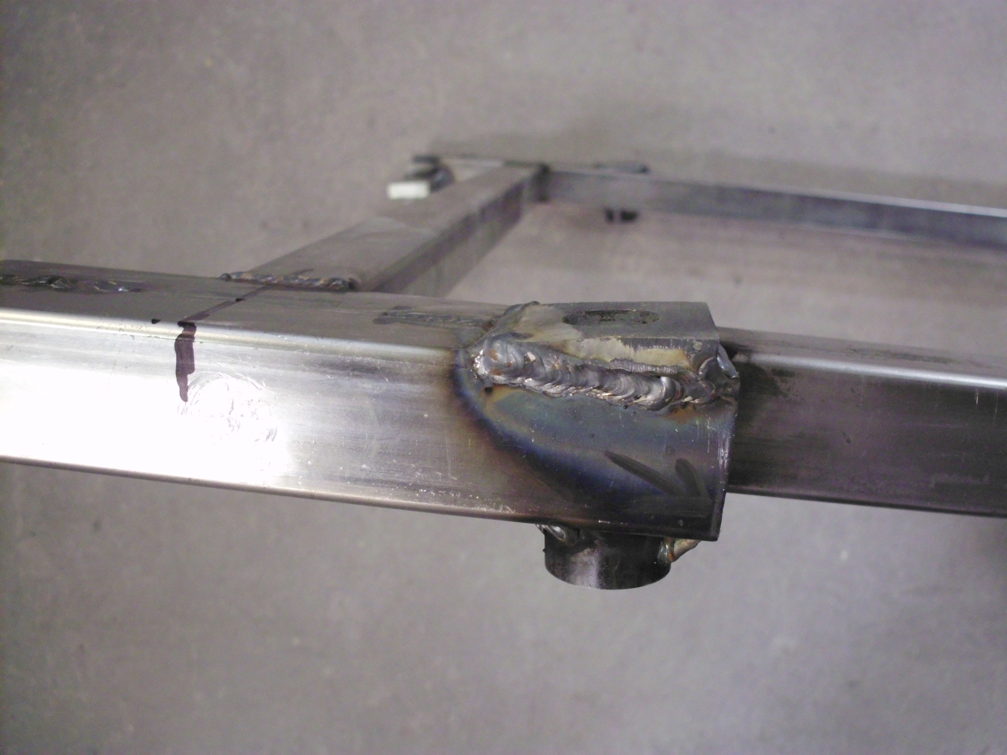

914350   Progress on the fixture.   Nov 28 2014, 10:29 PM
914350   More pics.   Nov 28 2014, 10:32 PM
914350   More pics.   Nov 28 2014, 10:36 PM
914350   This fixture will be removable from the table so t...   Nov 28 2014, 10:46 PM
