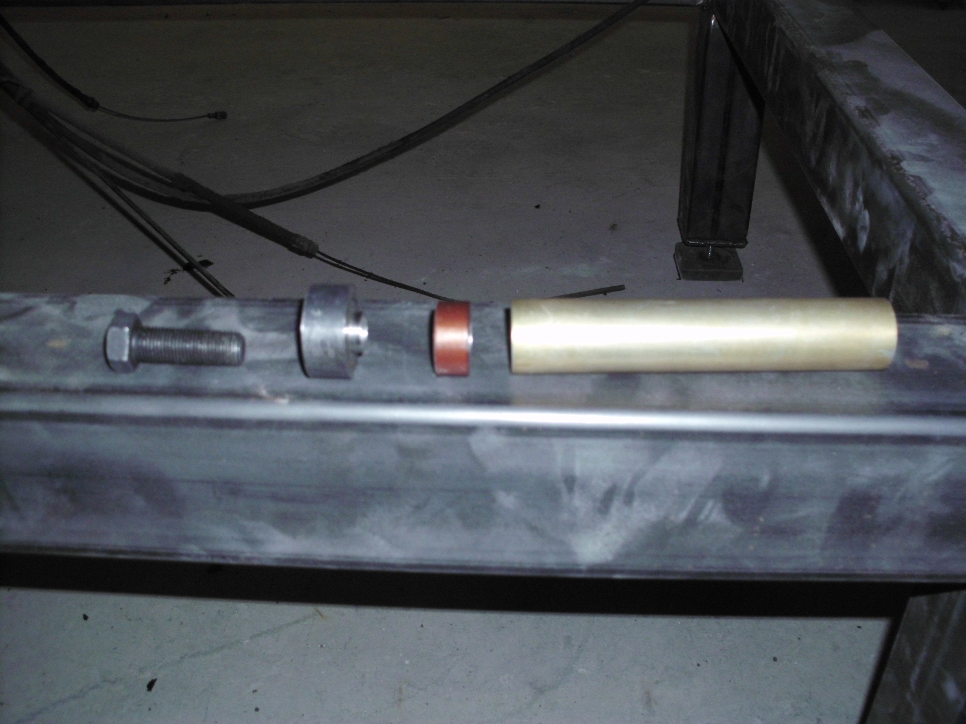

914350   This fixture will be removable from the table so t...   Nov 28 2014, 10:46 PM

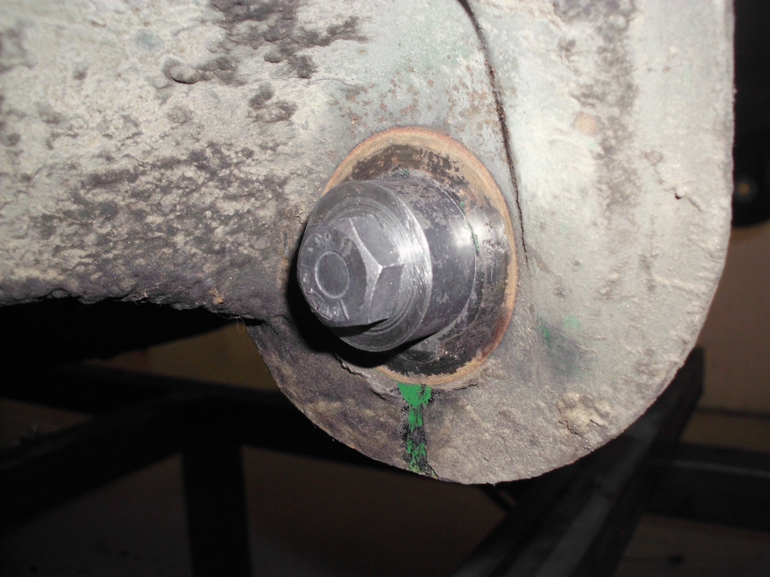

914350   Rear mounting points.   Nov 30 2014, 08:04 AM
914350   More pics.   Nov 30 2014, 08:06 AM
914350   I intalled an alignment dowl to relocate the front...   Nov 30 2014, 08:12 AM
