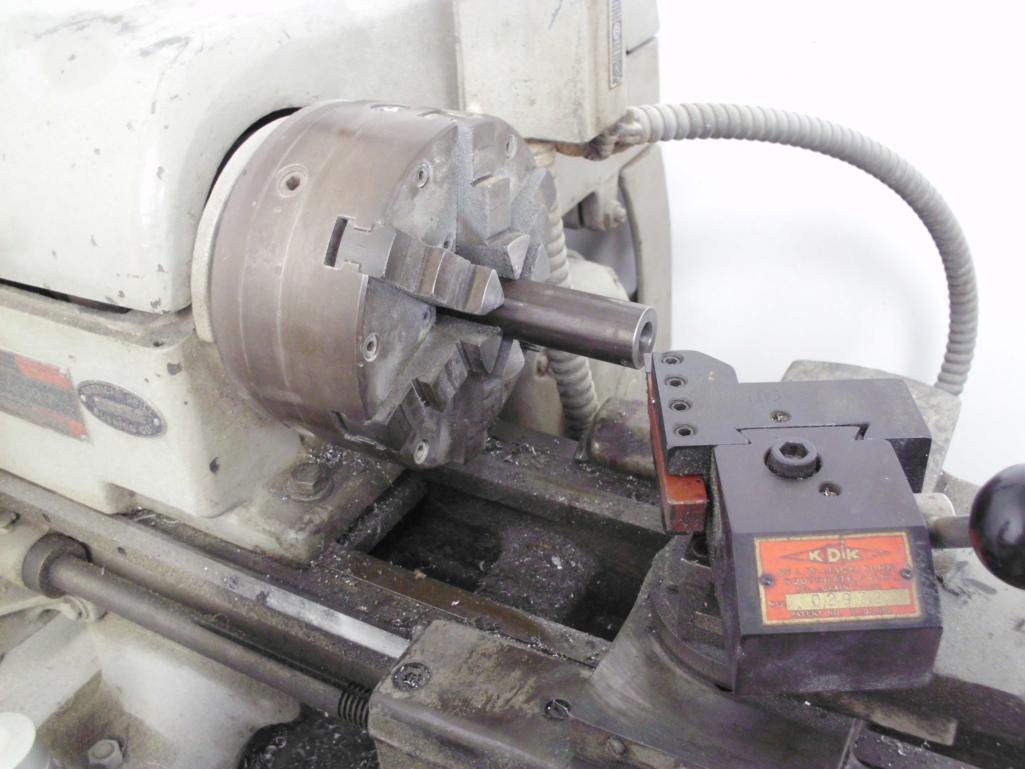

My Dad's Lathe hard at work (IMG:style_emoticons/default/smile.gif) getting closer to taking the rear quarters and fenders off the donor car.
