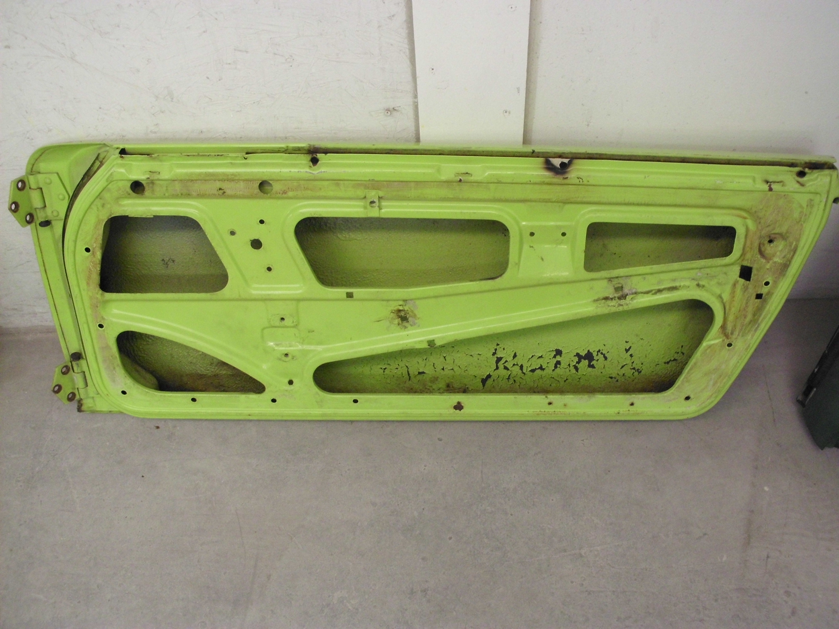

Jim brought by a realy nice set of doors for the car, a little rott from the seal in one but great over all.

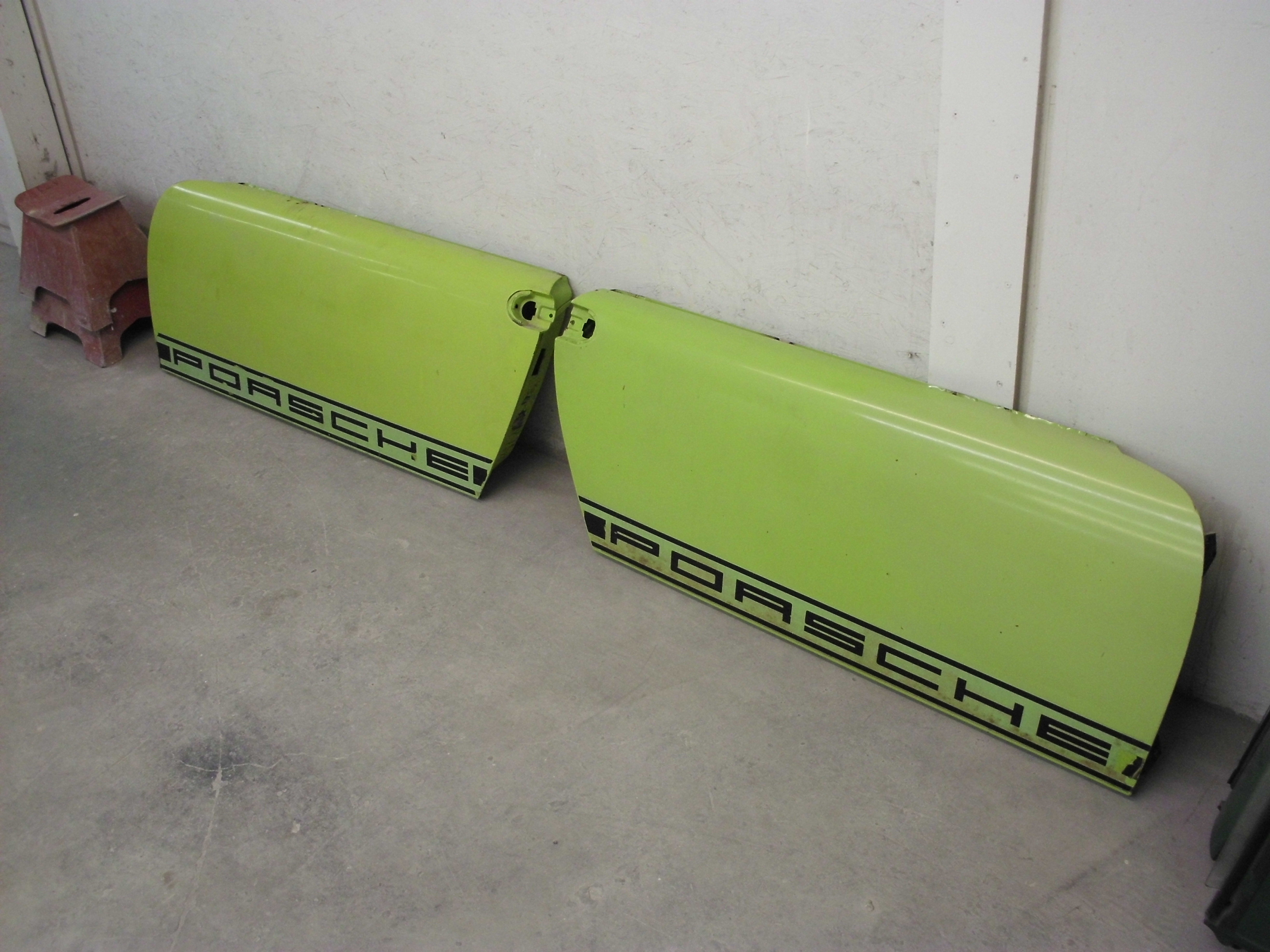

914350   Jim brought by a realy nice set of doors for the c...   Dec 1 2014, 09:52 AM
914350   He got this set of early doors for $70.00...W...   Dec 1 2014, 09:53 AM
