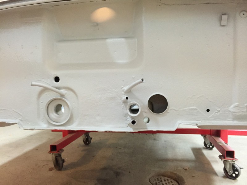

(IMG:http://www.914world.com/bbs2/uploads_offsite/matsgarage.com-15176-1417887525.1.jpg)
Anyone that can spot something missing in this picture... (IMG:style_emoticons/default/headbang.gif)

zambezi   -6 engine mount   Dec 6 2014, 01:28 PM
falcor75   I was more thinking of the missing fuel line hole....   Dec 8 2014, 05:36 AM
cary   I was thinking it was the clutch tube hole.   Dec 8 2014, 08:16 AM
