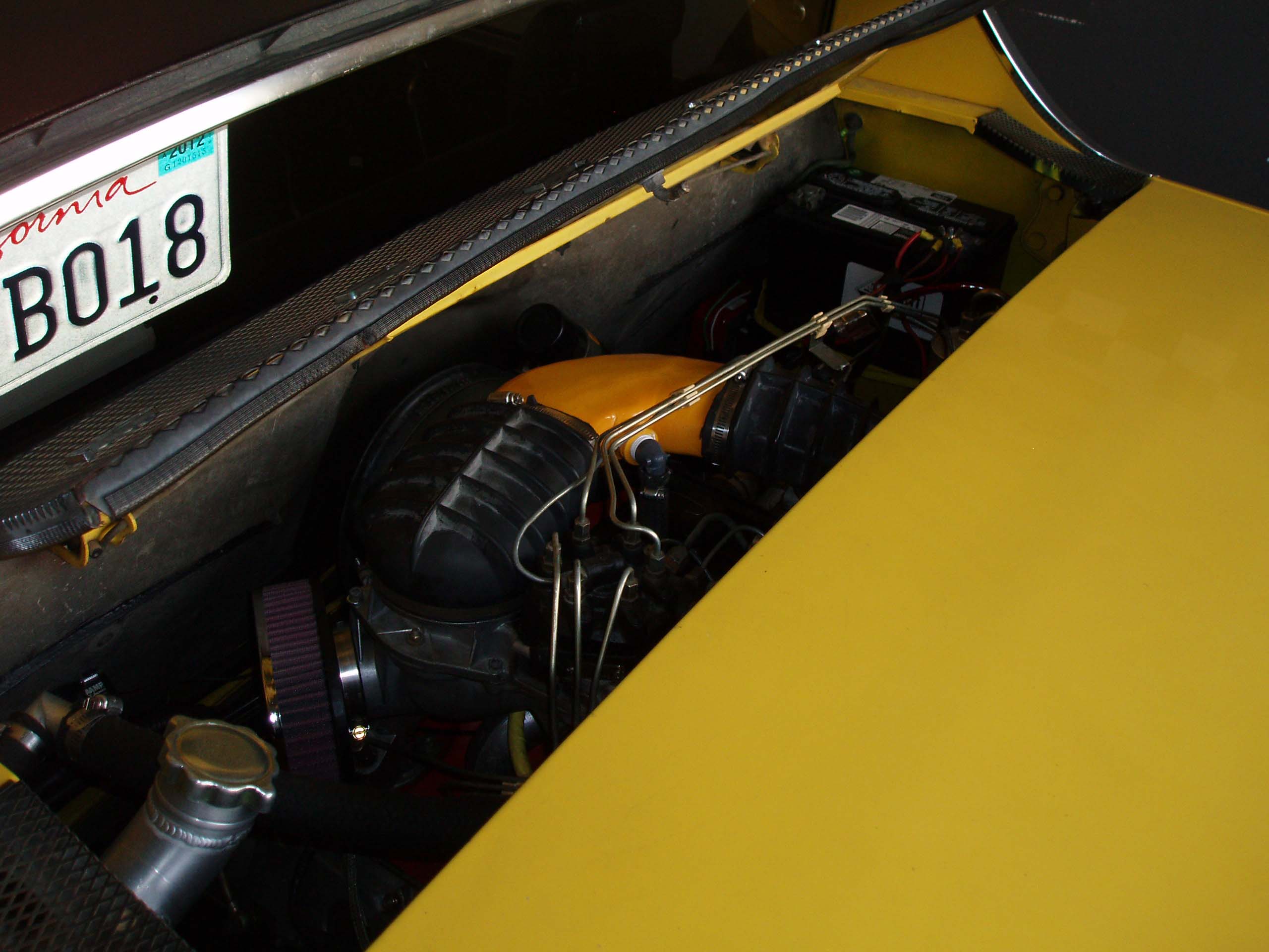

I love my narrow body 3.0L with modified injection, headders and twin tip exhaust! (IMG:style_emoticons/default/piratenanner.gif)
