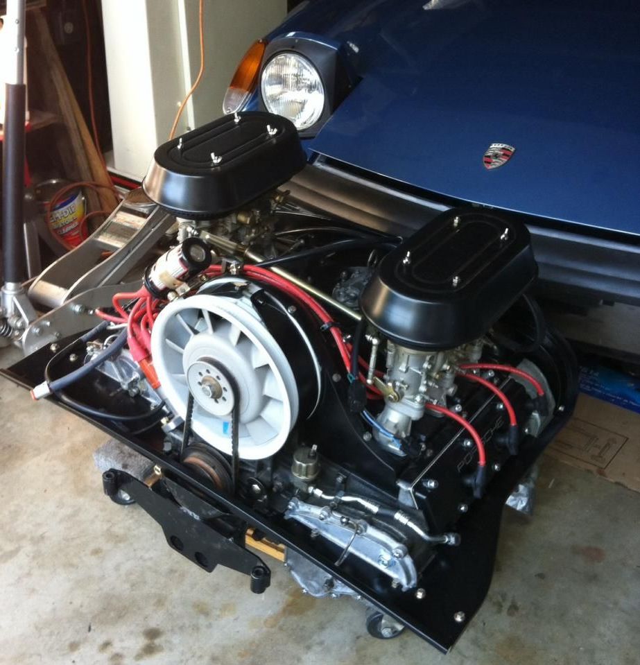

carr914
post Dec 7 2014, 08:48 AM
Racer from Birth
Posts: 131,990
Joined: 2-February 04
From: Tampa,FL
Member No.: 1,623
QUOTE(RobW @ Dec 6 2014, 02:01 PM) *
QUOTE(JStroud @ Dec 6 2014, 09:22 AM) *
Rob, I thought the ABM car came with a -6
It did / it does. I'm liking the car a lot and want to finish it once and for all, exactly how I want it for the next 30 years.
Put this Fucher in & be done with it

post Dec 7 2014, 04:02 PM
Lesbians taste like chicken.
Posts: 5,453
Joined: 22-August 04
From: DeLand, FL
Member No.: 2,602
QUOTE(carr914 @ Dec 7 2014, 09:48 AM) *
That has carbs and it's not twin-plug. Forget it......... (IMG:style_emoticons/default/bootyshake.gif)
