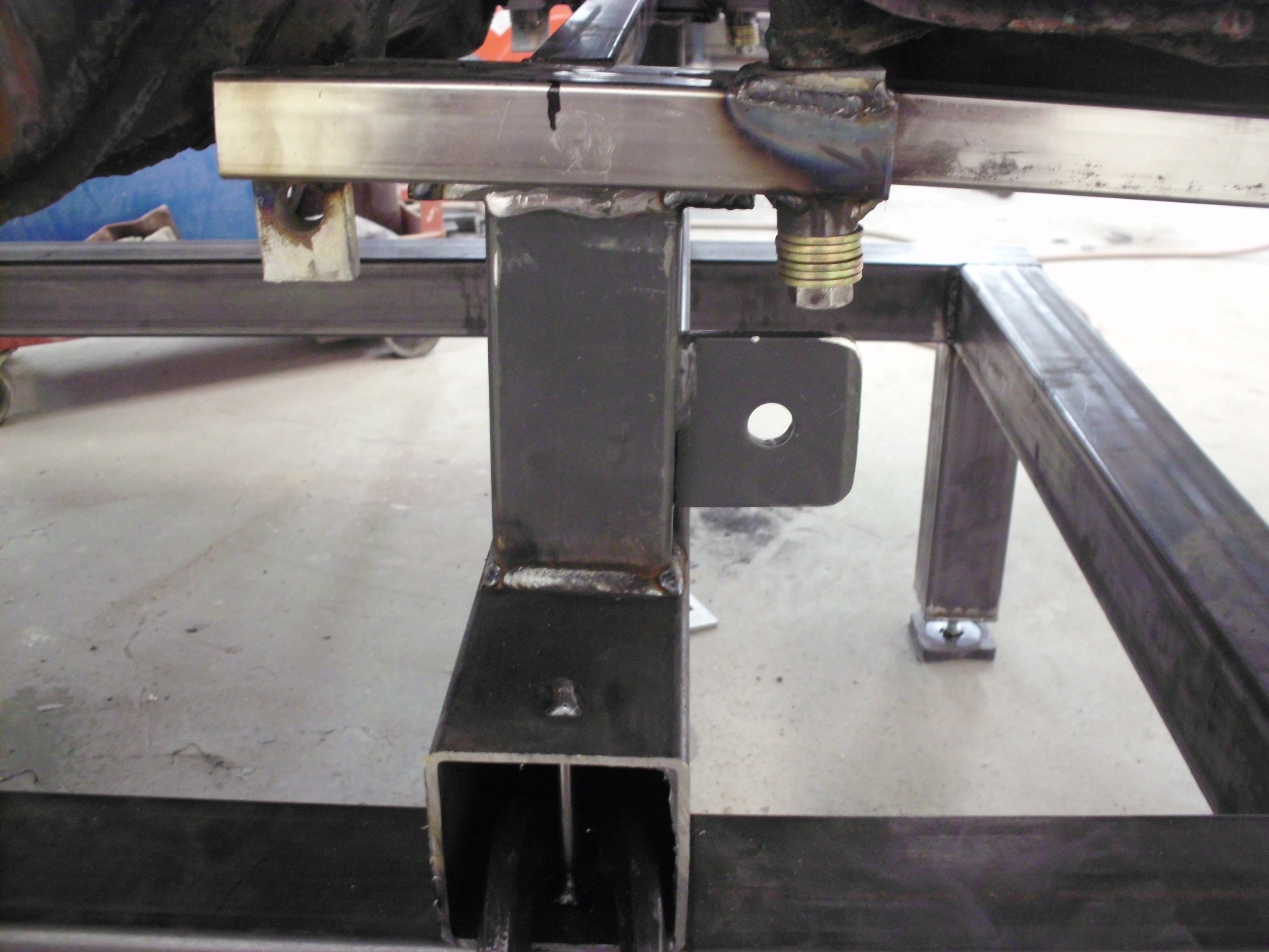

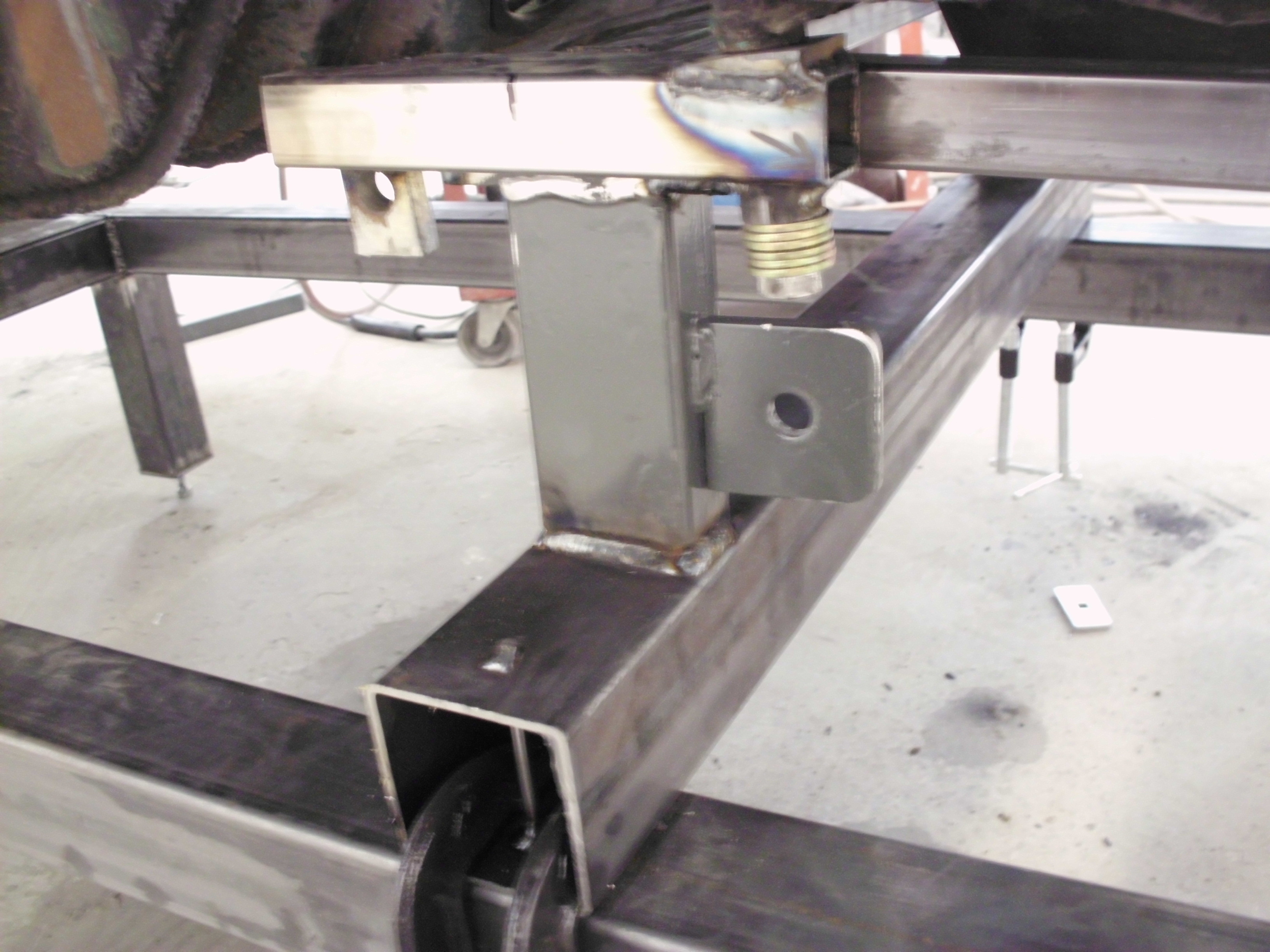

I got some more done on the fixture today. the fronts pretty much done and the rear is started. The front mounts at the four seporate rack mount points and centers on the OD of the mount points as the rack/suspension mount does and picks up the front torsion perches for properly locating them. I added brackets so I can do a soft pull if needed from the fixture to get the damaged car back into place. This would be done only after much of the metal is removed and taking care not to put any stress on the fixture. It looks like the 6 will need to be moved a bit in front.
