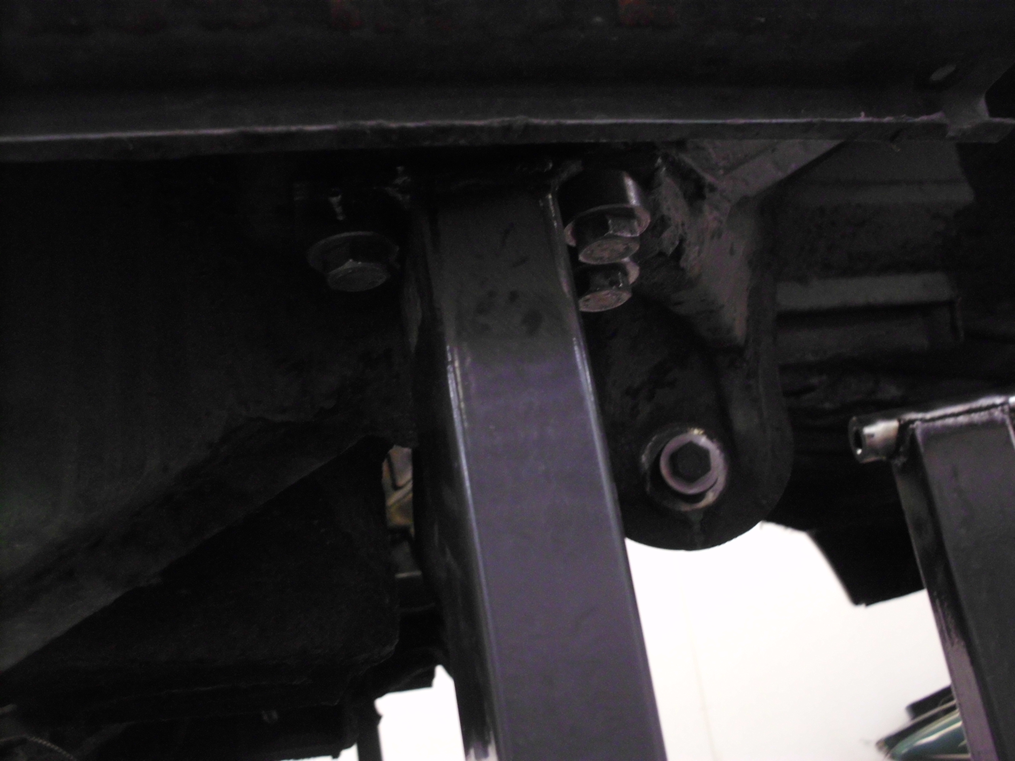

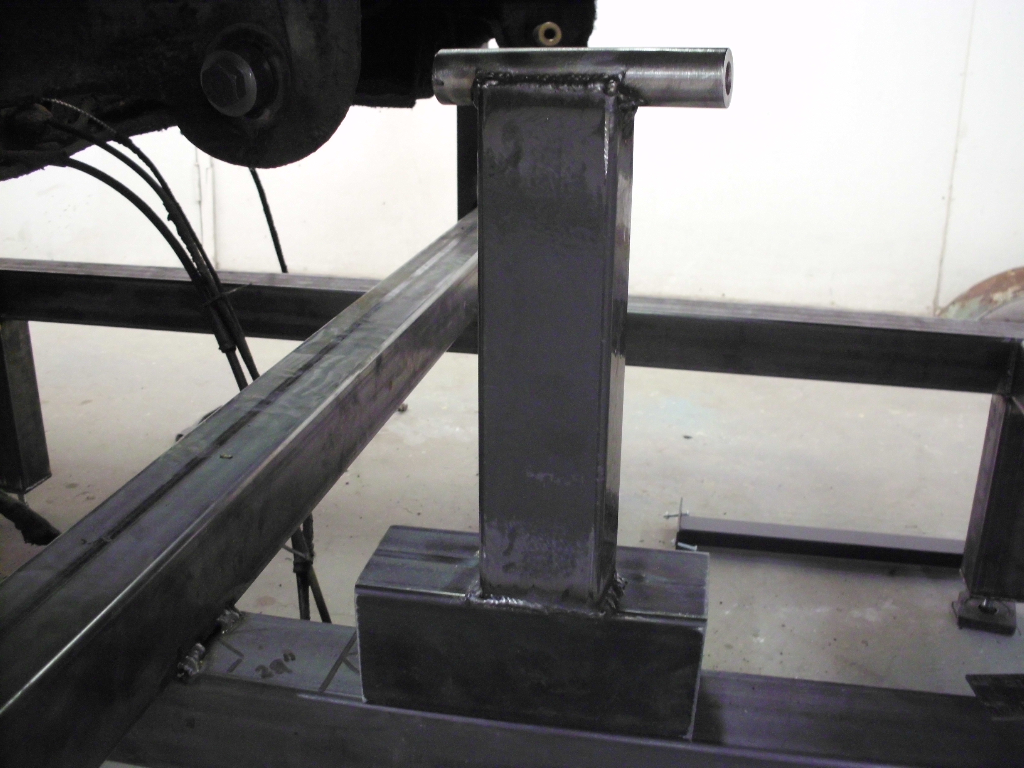

The rear of the fixture is almost done and I hope to have the 6 mounted on it by the end of the next weekend. Can't wait to cut into the 6.
