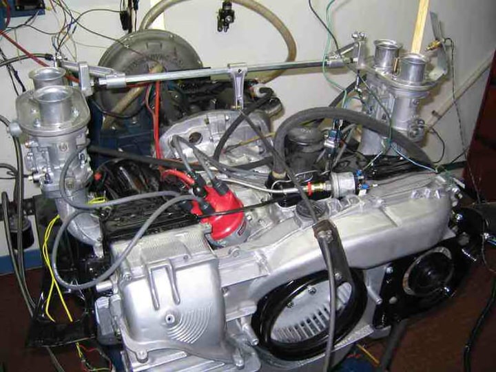

Not even sure what CAM or set up I actually have. I took the turn key route from Jake. I know my strengths and weaknesses. I did most of the mechanical work on the car, but my motor and paint were done by others. I am sure the motors he is building now are even nicer. Mine is 8 years old now. 350 trouble free hours on it.Attached Image

Harpo   My 2270 from Jake peaked at 170 HP and that was be...   Dec 7 2014, 10:05 AM
Jetsetsurfshop   My 2270 from Jake peaked at 170 HP and that was b...   Dec 7 2014, 06:57 PM
Harpo   My 2270 from Jake peaked at 170 HP and that was ...   Dec 7 2014, 07:37 PM
