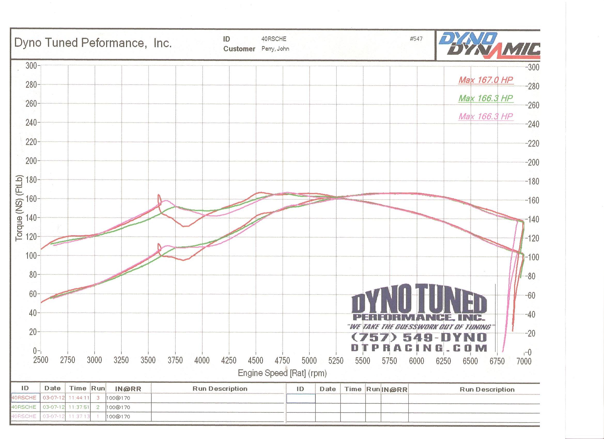

Here's dyno sheets on both....the 2316 Raby kit with SDS injection/ignition on huge TB's, Hoffman heads, Tangerine headers....torque above 150 from 3500 to about 6000. It's torque you want, not just Hp....

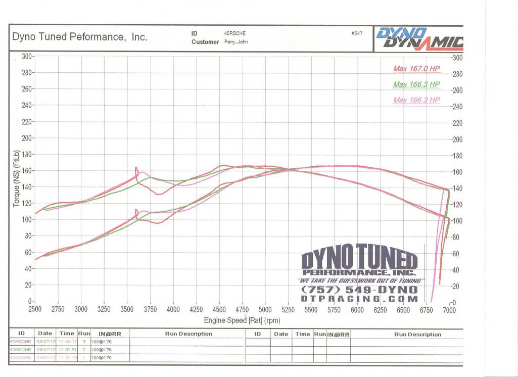

Now, here's my 2.7 /6 with PMO's and European headers on megaphones....torque runs 160-170 from 3500 to 6500, nice but not hugely different. (Ya, ya, different dynos different days, etc....it's all I have but is probably representative.)
And another on the 2.7 when Josh took it to BeHe....had the modified muffler on it for that pull AFAIK...
I love driving both...use the 2316 primarily for street and the 2.7 for track days since that's what they're set up for. Now, here's another part of the equation after the initial "investment" (read "expense" but I'm in denial..).....cost to rebuild even after catastrophic failure for the Type 4 is under $2000 and only takes maybe 4 weeks. Don't even want to know what a /6 rebuild costs but am pretty sure it's knocking on the door of over $5000...
I vote for the big 4 but consider the 80mm crank a weak spot....sourced my last one from FAT since it's a new forging vs. the previous one built up from OEM. 2270 would have less concern in this area I think with a bit shorter stroke....
