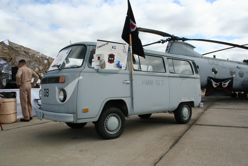

I built the T4 in this bus for my old squadron in 1994. It had more aircraft components utilized than VW parts.
