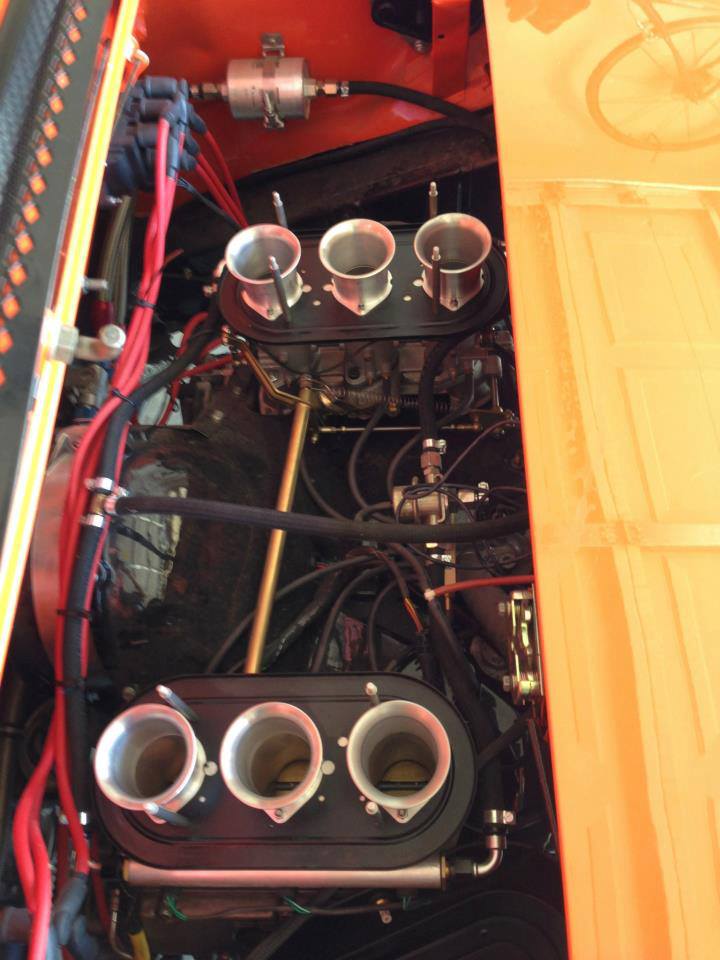

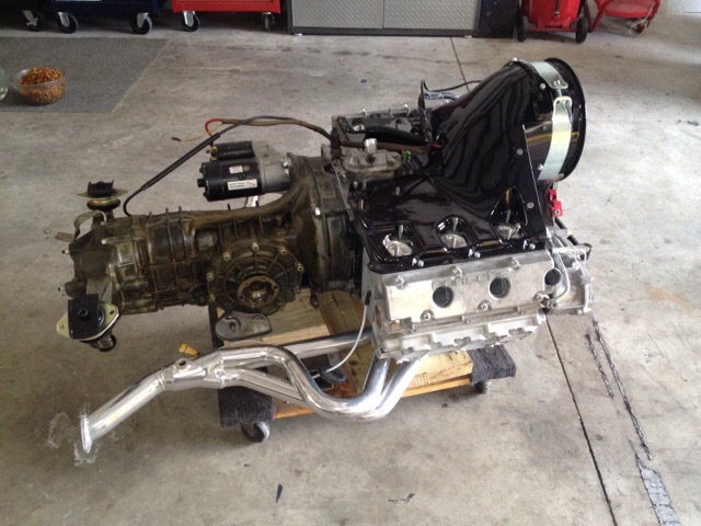

Yeah, 3.2 ... and you could always decide something like, "well hell, since it's going to be rebuilt anyway and needs the right cylinders, might as well go with JE pistons, a Dougherty cam, twin plug, PMO ITBs, distributorless ignition and MegaSquirt." (IMG:style_emoticons/default/blink.gif)
It's what I did. (IMG:style_emoticons/default/aktion035.gif)
Edit: by suggestion, here's one more pic. If this don't make yer booty move yer booty must be dead!
