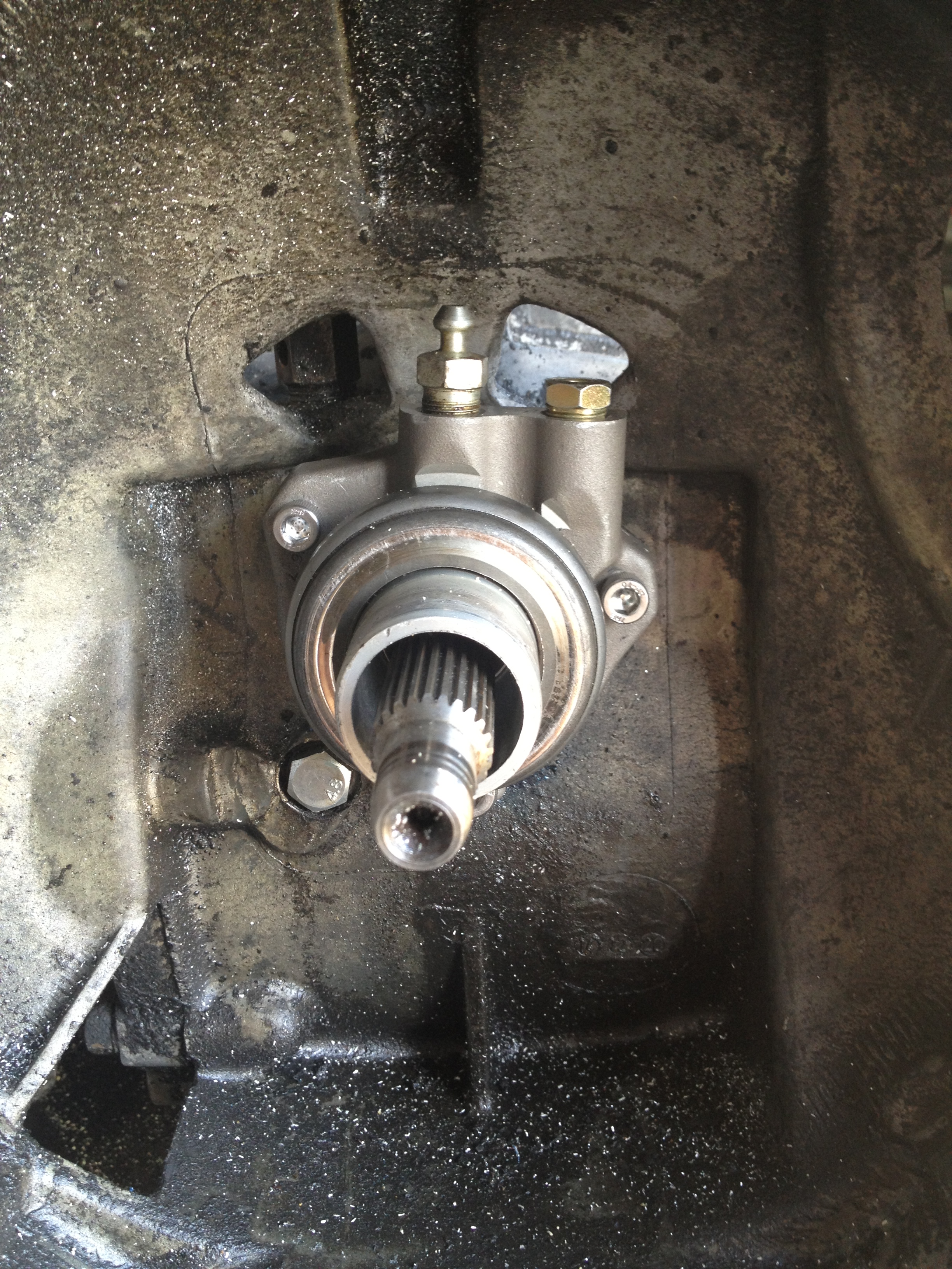

Worth looking at newer cars and how they run their concentric slave cylinders now. The bearing is designed to be in constant contact with the pressure plate. Throw-out bearings are typically a high clearance design and engine speed is hardly going to worry a bearing designed for 15krpm max. What kills bearings inside their design range is shock and pressure. The shock of a bearing coming from nothing to engine speed every time you touch the clutch will wear it faster than it resting lightly against the pressure plate all the time.
I really need to find the time to finish my concentric slave to replace the pull type I'm using now.
