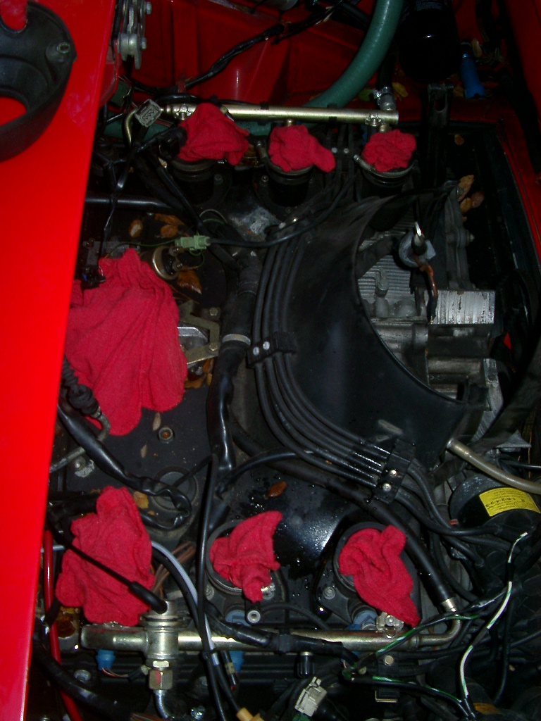

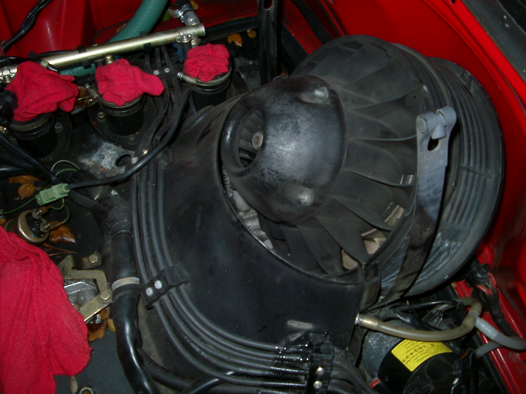

And Andy how did you get the alt out? Do you have a 2 piece shroud?

QUOTE(Mark Henry @ Dec 12 2014, 07:16 AM) *
Yes, two piece shroud:

SirAndy   And Andy how did you get the alt out? Do you have ...   Dec 12 2014, 12:20 PM
