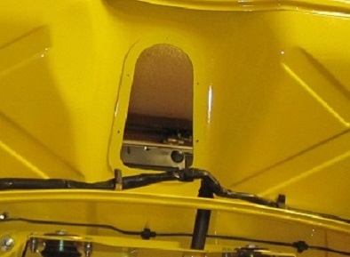

After cutting the opening, I spot welded an 1/8" thick reinforcing ring and then drilled/tapped for the cover screws

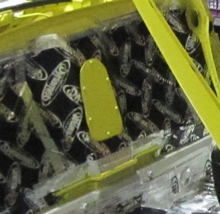

Not easy to see, but we just did a very clean/straight cut out, made an aluminum 'door' just a bit bigger, and used hinges on the bottom and 1 dzeus fastener on top. Very simple. this way there are no screws or nuts to deal with that might get dropped or lost when you open it up. Painted it when I painted the interior.

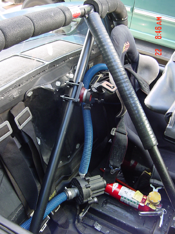

pcar916
Dec 12 2014, 09:02 AM

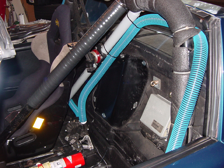

I vote for easy access in the dark on a lonely road in the mountains, or on the track between runs. What's likely to happen? Perhaps a broken or compromised fan belt. Mine gets inspected and replaced fairly often so it's never happened to me, but it did when I had the PO installed 2.7L. Not an enjoyable operation. My thinking on the size?
I choose not to give myself cramps trying to do two-handed operations through a small hole.
This access hole lets me do anything I need to do, including getting the spanner onto those 3.6L pulley holes and fussing with the shims on the fan pulley. The metal is thin enough to snake out from behind the cage-crossmember, thick enough to still be a firewall, and with the Dzus fittings, is easy to remove/install. The only thing I have to do is remove the passenger seat, a 5-minute thing. When on the road, I carry a huge plastic bag to cover it if it's raining.
Click to view attachmentClick to view attachmentClick to view attachment

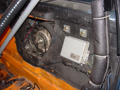

Dec 12 2014, 12:20 PM
QUOTE(Mark Henry @ Dec 12 2014, 07:16 AM)

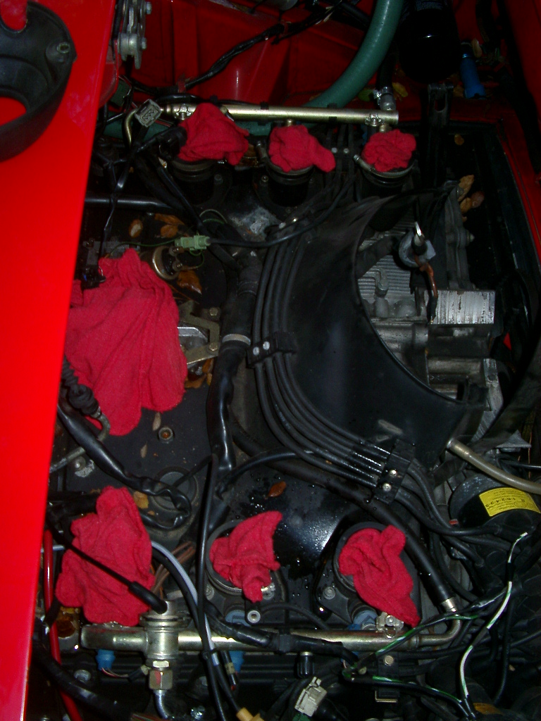

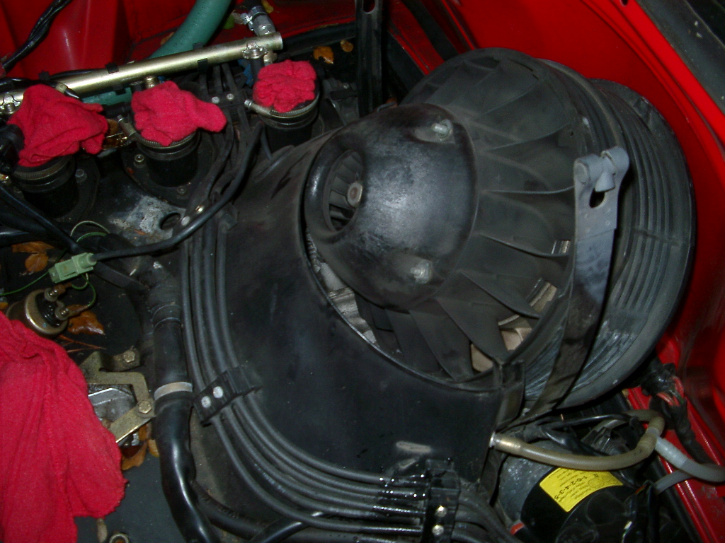

And Andy how did you get the alt out? Do you have a 2 piece shroud?
Yes, two piece shroud:

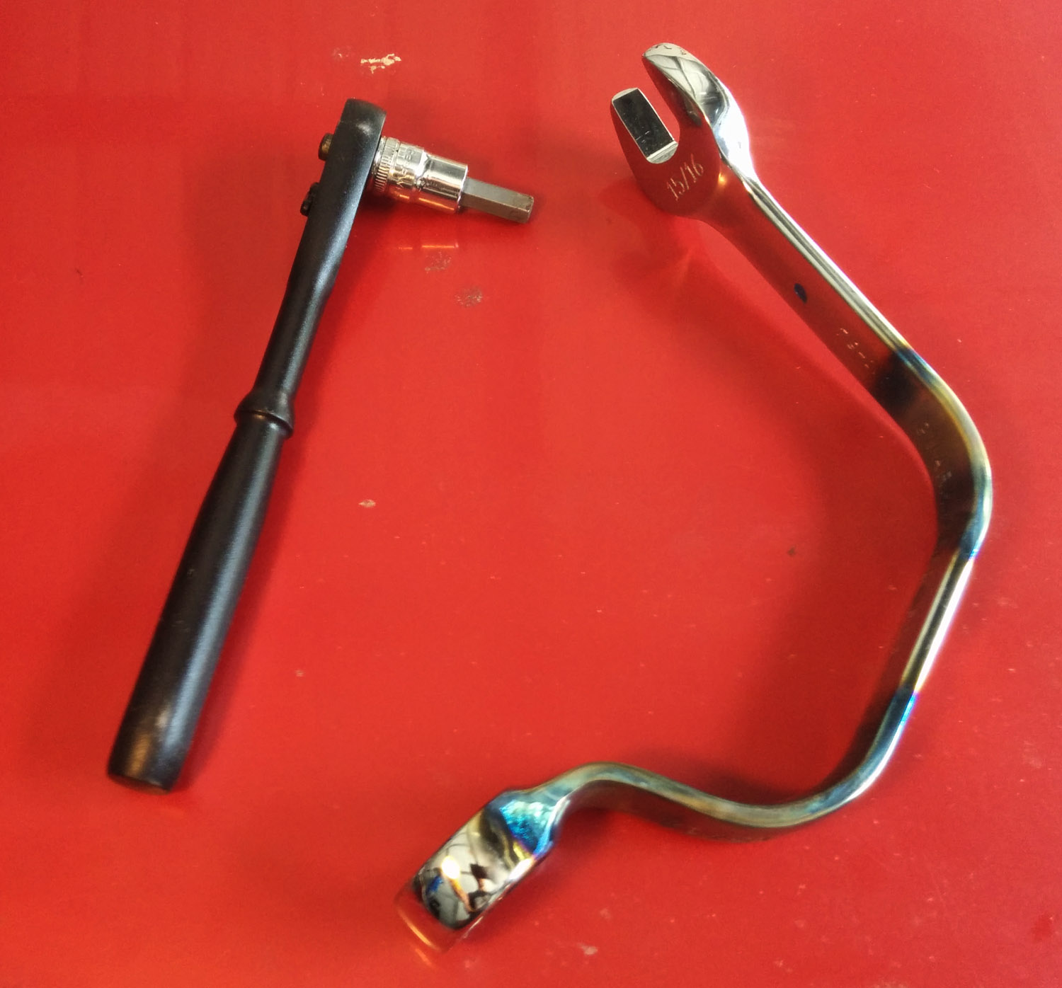

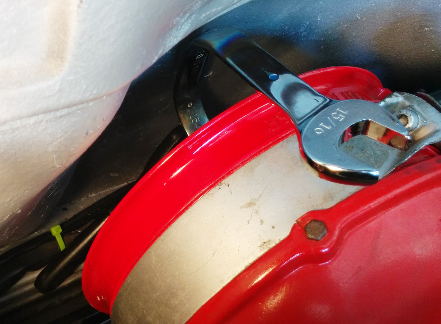

patssle
Dec 12 2014, 12:27 PM
Don't need a hole to replace the belt. Here's my trick!

patssle
Dec 12 2014, 04:05 PM
QUOTE(Mark Henry @ Dec 12 2014, 12:06 PM)
QUOTE(patssle @ Dec 12 2014, 01:27 PM)
Wouldn't work for me, I'll have to get a different pulley and I don't know what the hex key is for...
Hex holds the alternator shaft. Instead of the special $30 alternator pulley wrench.
