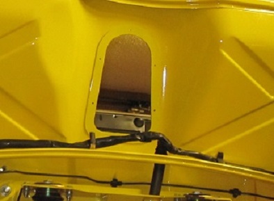

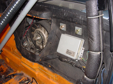

I made a cardboard template to cover the opening I made. About 3/4" bigger all around than the opening in firewall. I traced it onto a sheet of aluminum and cut out with my jig saw. I used a rubber mallet to shape it on the fire wall. I tack welded 8 small nuts on the engine compartment side to make for easy removal/install.
Krieger
post Dec 11 2014, 10:31 PM
Posts: 4,879
Joined: 24-May 04
From: Santa Rosa CA
Member No.: 2,104
From the F-914 build in my signature.

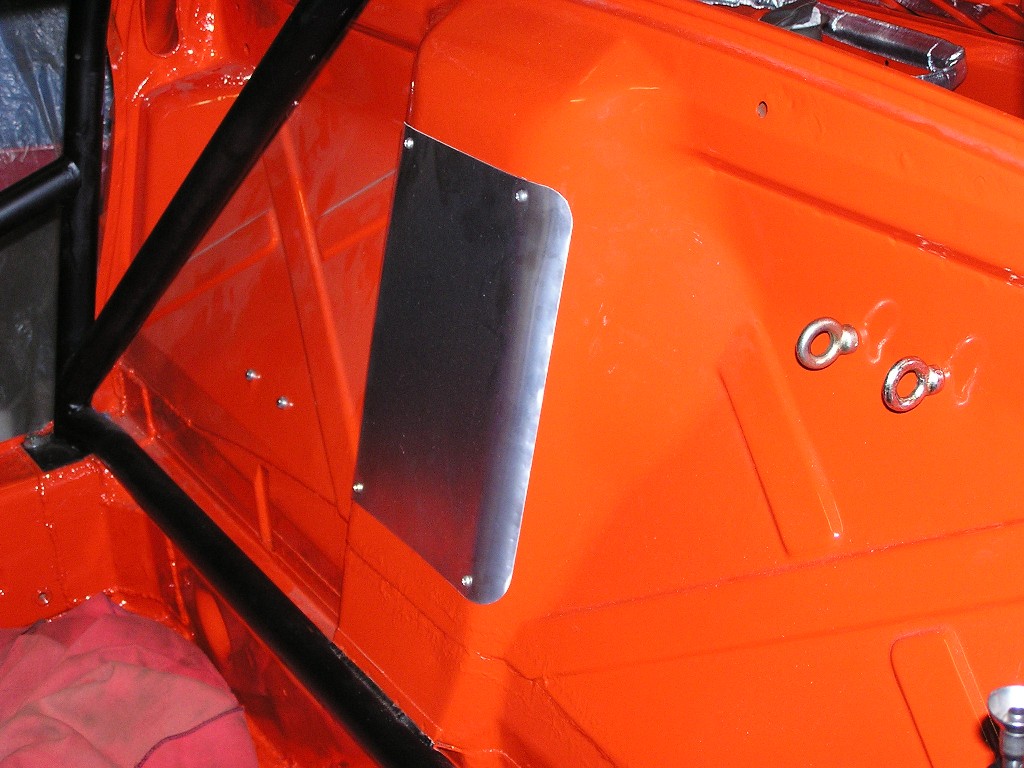

The last race car had a similar opening like Krieger's. Sheet of aluminum covering it with screws holding it in. Never needed to use it though.

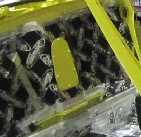

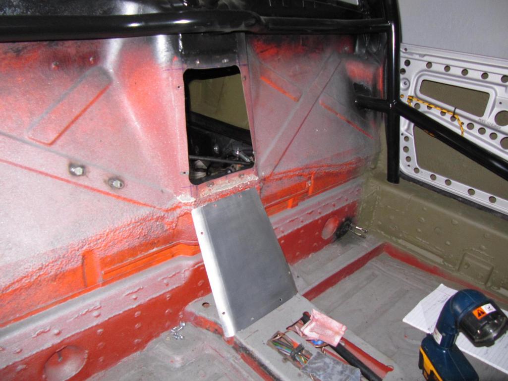

Not easy to see, but we just did a very clean/straight cut out, made an aluminum 'door' just a bit bigger, and used hinges on the bottom and 1 dzeus fastener on top. Very simple. this way there are no screws or nuts to deal with that might get dropped or lost when you open it up. Painted it when I painted the interior.

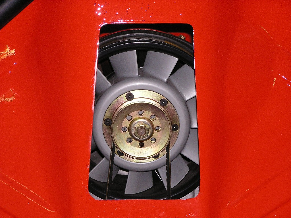

I vote for easy access in the dark on a lonely road in the mountains, or on the track between runs. What's likely to happen? Perhaps a broken or compromised fan belt. Mine gets inspected and replaced fairly often so it's never happened to me, but it did when I had the PO installed 2.7L. Not an enjoyable operation. My thinking on the size?
I choose not to give myself cramps trying to do two-handed operations through a small hole.
This access hole lets me do anything I need to do, including getting the spanner onto those 3.6L pulley holes and fussing with the shims on the fan pulley. The metal is thin enough to snake out from behind the cage-crossmember, thick enough to still be a firewall, and with the Dzus fittings, is easy to remove/install. The only thing I have to do is remove the passenger seat, a 5-minute thing. When on the road, I carry a huge plastic bag to cover it if it's raining.
